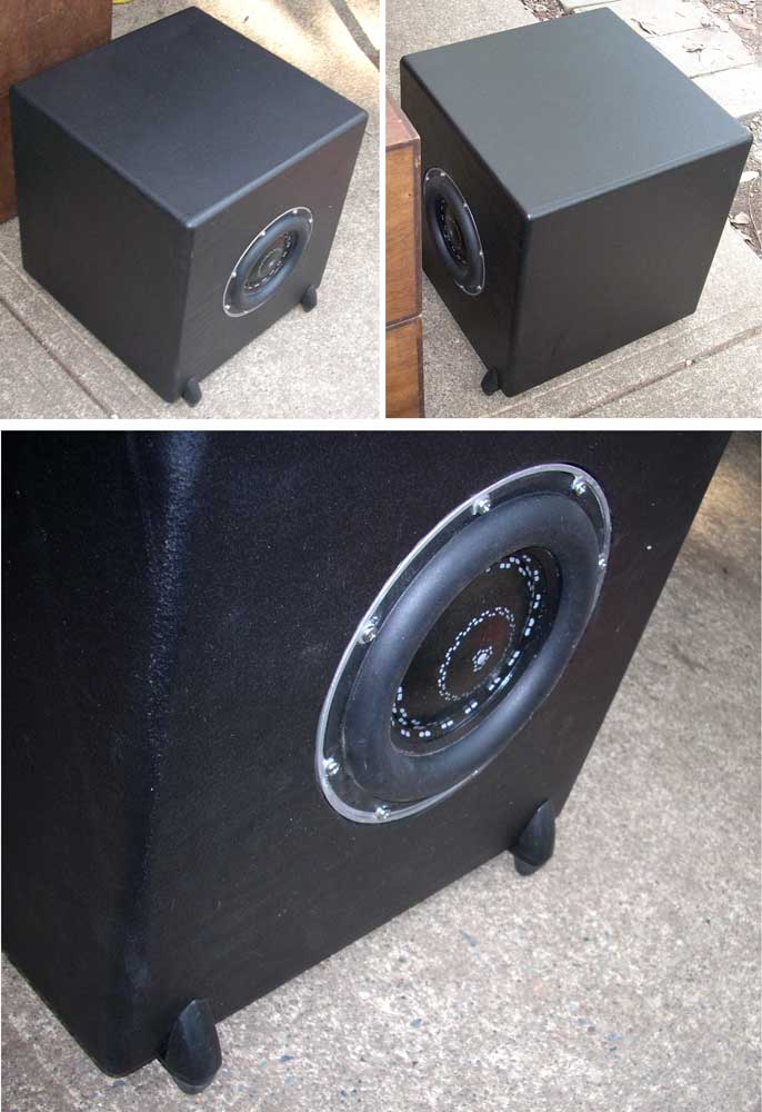

Planet10 how do you think the Apex Jr. Subs as a push-push would do with f120s? The price is right and I've read good things from them. You also have a design on Apex's website. Would this work well with my Fonkensteens or do you think the FW208's would be a better choice.
The ApexJr 8s do very well. Modeling doesn't show them going really low, but set next to the wall, or pushed into the corner, i find them very satidfying and match up well with my room gain. They are also much more extended than one would expect for a "subwoofer", a good thing when mating with any FR driver. It is certainly hard to beat them for bang for the buck,

picture.
