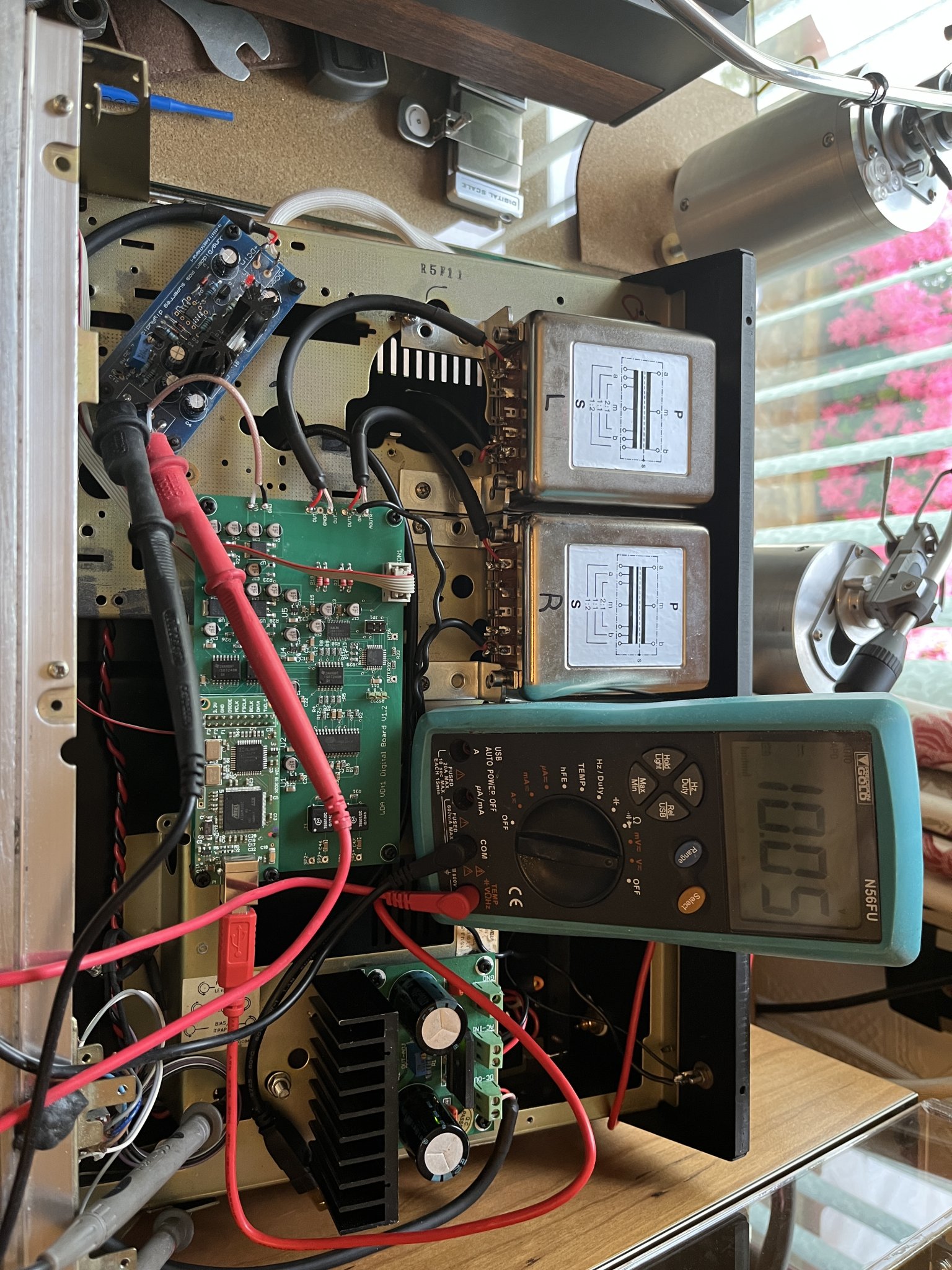

I think this is the source that the picture.
20,7 and 22,4 H at 100 Hz for the primary is probably more accurate. Its still very impressive for a 13 Ohm winding.
