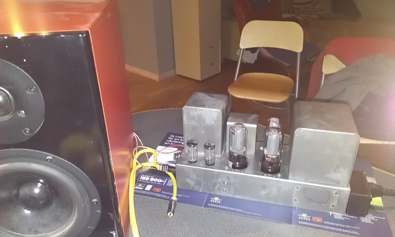

Just clean the dust,
check the generic values at the test points against the schematic
calculate currents to see exact values
check the elements each one resistors value against the original value
(I did and was 40% off even look like new, watch out.)
change power capacitors to block
BUT NOT large value please, 22uF is max (16uF original)
You can use a 6550 or KT88 tubes BUT Rk should be exchange to 250ohm
Instead of GZ32 hard to find tube, and half time faster heating time
I am using 5U4GB (Fivre) with mucho better sound outcome
The best combination I found with EF86 philips or telefunken, KT88, 5U4GB
One thing the sound deeply depending on a input tubes
as far better results i had with Philips and Telefunken models
there is a more
but the vital is to check the voltage points
with a resistor loaded output or loudspeaker

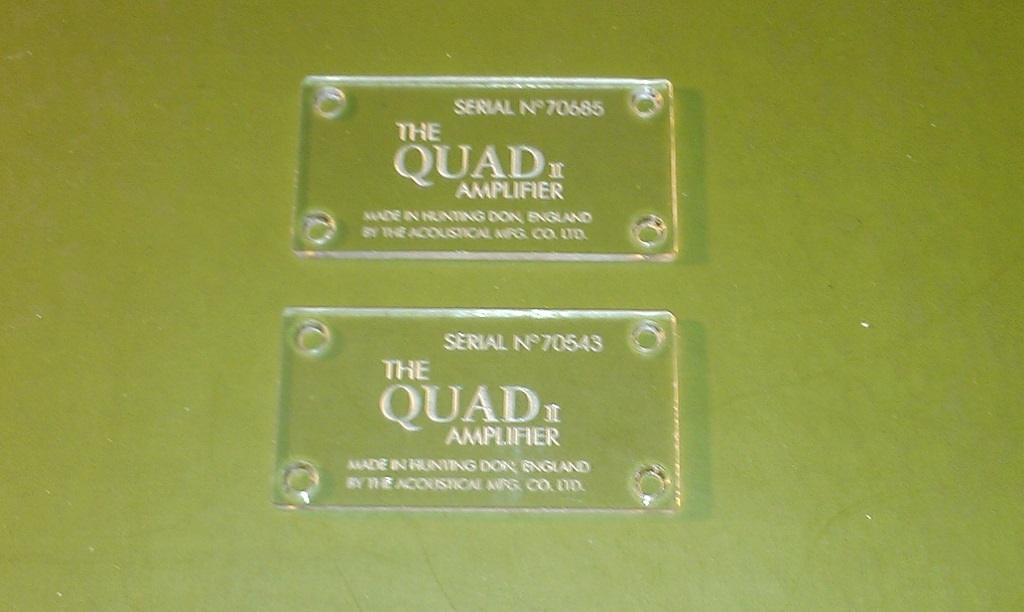

I'm still in an almighty quandary with these - for the moment they are staying put and untouched.
I've had a lot of interested parties contact me by PM and while I appreciate your interest - for the moment these are not for sale. I will of course offer them here first if I go that route but please don't expect me to let them go without adequate remission.
My biggest barrier to keeping them is the lack of suitable speakers to pair them with - although a pair of B&W 685s will be coming my way in time.
I don't doubt my ability to do a good and faithful restoration if I decide to - I have all the tools at my disposal (scope included) not to mention several more qualified friends I can consult (Allen & Heath engineers).
More than anything I would like to at least hear them.

Heh - or I could solder in a load of cheap chinese components and get some of that carbon fibre effect vinyl wrap to cover them in! That would look suhweet!
They are serial numbers in the 60000s and very closely matched - which at my estimate makes them a young pair.
