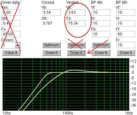

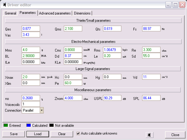

OK, so a ~75.33 Hz tuning [Fb].
OK, with this tuning you’ll run out of linear travel at ~2 W, so allowing for a little overdrive, 5 W max below Fb. Hope your limiter never fails.
At only 5 W, the vents can be quite small, 2.5 cm dia. x 5.3 cm long.
Again, you can put the vents wherever they will fit since the diameter of a 75 Hz WL is ~57.55” and/or where they sound best overall to you, though in theory you shouldn’t be able to hear any difference unless you overdrive the cab so hard that the vents audibly ‘whistle’/’chuff’.
That said, the pioneers of audio concluded that for a simple reflex like this one, putting the vents as close as practical to the driver is best overall, so your call.

Thanks for the briefing. Does it help to tune the port a bit lower?
Well, anyway, the question is how do we get more power with less x-max?
With 2w power handling, apparently I've got an epic design flaw.

No, that makes it worse.

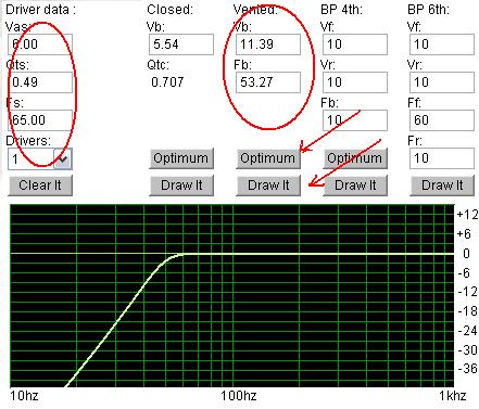

Tune it higher and or make the cab bigger and/or use your limiter to protect it below ~90 Hz.

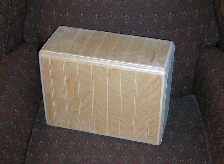

A bit too heavy for what I wanted. The Monacors do need companion tweeters.
I wish I'd used the 8 ohm woofers to help the amplifier operate more efficiently, and that way I could have used the TA2021 instead of the lackluster TA2020. I didn't need the ultrabass circuit because 1000u series to each of 4 ohm woofer did the "progressive current drive" trick just fine for facilitating good cabinet tuning. Could have used 470u (or nearby figure) with 8 ohm woofers. Oh well.
The soft clipper plan sort of failed due to variable voltage from the battery, but it is possible to use a transistor to amp the clip detect pin so that it can run an LED or two LDR, and a wide dynamic range LDR such as used for 50k version of lightspeed attenuator can do the job.
Much better way to do soft clip thing, is equip the woofers with passive crossover, and then bi-amp the tweeters with a different amp. Then the woofers don't emit clipping and the tweeters never clip anyway. Lots more useful power!
Well, I had picked the 4 ohm woofers because they can use half-size inductors in the crossover.
The solar panel thing turned out to be a huge inconvenience, because I ended up using a whole pack of 14v zener, each with its own series resistor and then one big ordinary diode series to that thing (14.7v total), this unit parallel with the solar panel for restraining the output of the solar panel to the safe range for both the amp and the battery. There's also an MBR735||1N5819 series to the solar panel's cable (to prevent battery discharge). So, output is actually 14.5vdc (or less), and some heat. I re-planned and put a big square plastic (not glass) 5W solar panel on back, and there was just barely enough room to fit a speaker back there with it. Sheer overkill in bright sun, but nearly insufficient on a cloudy day. It does stay fully charged if set in a windowsill, and it wouldn't have ever needed a power cord if only I had used 8 ohm speakers. Should have attached the solar panel with double-stick velcro because bi-polar speaker doesn't work so well with left channel pressed up against a window.
As far as using it on the bicycle rack, no way!! This turned out much too heavy and would cause a crash. So, actually, my plan failed.
