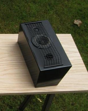

I applied a few cans of the Duramax Flat Black spraycan and it looked fantastic, but yes has the problems of flat black as others suggested so I've given up on the flat black finish for the time being.
Ideally I don't want a textured finish which rules a few approaches such as Truckbed liner. I've changed tact towards a semi-gloss finish and going with an oil based enamel for durability.
On this, I purchased some paint and filled my electric spray gun and proceeded to coat.
What a disaster! blotches all over, maybe I didn't set something properly. I hadn't used it for detailed painting before, only the fence and garage. I think a too high a flow rate was an issue...
Being oil based I had some time at least to go over with a roller too smooth things out. The end result is more textured than i am after.
Some more research I think before I sand and re-coat.

Sorry to hear of your problems. Using a foam or very short pile roller and a paint tray can achieve excellent results, but the roller must be wide enough to coat the entire width of the largest panel in one pass or you will, most likely, end up with visible tramlines. Oil-based paint is definitely the way to go for many reasons, and I would suggest reducing the paint with 5-15% of an appropriate thinner.
Some paints are best rolled quickly and just left to flow, others respond better to more thorough rolling - you should experiment! Further, the flow-out characteristics of paints tend to very different when applied over fully cured paint films compared with those which are just touch-dry; in the latter case solvent can be 'sucked out' of the second coat and flow-out greatly reduced (more texture). Aim for just one, thin finishing coat over your sanded surface, and the longer you can leave the original coat to cure, the better will be the result; you will probably need to leave it for a week or two to harden to a state where you can sand it anyway.

Electric sprayguns do tend to throw out paint at an alarming rate, so rattle cans are probably a better bet for a fine finish unless you can get access to air-fed spraying equipment. Blotchiness could be due to uneven paint application causing the flatting agent to settle out, or high humidity causing blooming. Try Simoniz Tough Black Satin; I have used this extensively and find it to be extremely good and easy to apply. You will only need a couple of light coats (not full wet) to achieve the finish you require. I suspect it is alkyd-based and has a more benign solvent than acrylic aerosols and the like, so should not hurt the existing coating, but I would let that cure very thoroughly before sanding and recoating.
For a superlative finish, sand using a long flat wooden block in stages from grit 180 to 320 and finish with 600 or finer before spraying. A piece of thick MDF or machine planed timber works well, with the abrasive paper glued to it using aerosol carpet adhesive.
