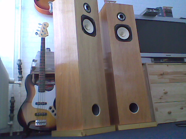

I got a pair of FE207E and built the recommended single bass reflex cabinet. While the bass was decent and the efficiency good, they are unacceptable. Between approximately 2 and 5kHz there are one or more resonant peaks in the output. When a note happens to hit one of those peaks, it positively darts out and stabs the eardrum, making listening tiring and painful.
I tried breaking them in for hours and also lining the cabinets, but neither seemed to have any effect whatsoever on this problem.
Any suggestions? Could different cabinets fix this? Maybe I should upgrade to FF225WK?

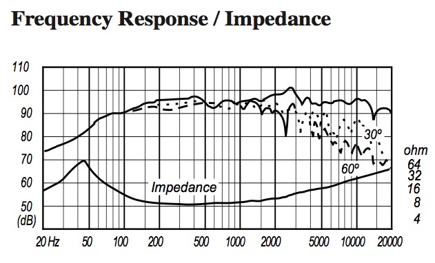

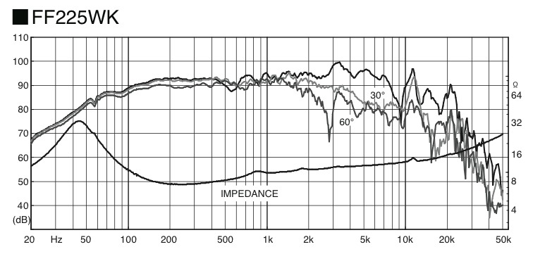

I took a peak at the data sheet for the FF225WK (attached); unfortunately it still looks to have the tell-tale cone break up peaks in there.
The FE208EZ is another Fostex 8" but it has a peak around 3kHz that people (e.g. Mr. Brines) says needs to be notched and it has rolled off treble.
Seems the best choice is to try modifying the driver - beyond my experience but you could try contacting Dave at Planet10 - he knows a lot about this, many years of experience with full-range drivers.
Actually I was able to listen to the FF225WK twice over the last week. it does not suffer from irritating aspects, in fact it is remarkably smooth and unfatigueing and in short quite a bit better in tonality than its x06E and x07e ancestors.
But, you need a tweeter, the driver has good bass but, as you can guess from the frequency plot, it lacks air in the higher frequencies.
By the way, the metal dustcap of the WK series isnt a sphere but has a ridge. I first thought: wtf? Then i read in the leaflet that came with the FF125wk that I bought that the ridge is there to prevent resonance effects.
In any case this is a good series, they were quite obviously better and more refined than comparable FEx06En in their japanese BK series horn boxes with which I could immediately compare them.
I recommend to check out the driver, and add an affordable ribbon or magnetostat tweeter. Since the 225 is so smooth I would first try to only put a filter on the tweeter.

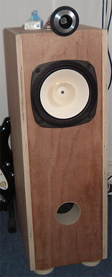

WOW !, do these look really fantastic in that lighting !
How did you know where to put the Zig (what the heck is Zig) ? and how would I know if it will help my FE127's ?

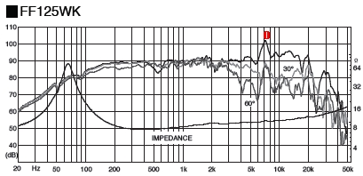

Well, unless there is something in the magic Zig... I'm looking at the FR plot for the 125 and it looks like it has the same "ask three teenagers to scream loudly in my ear" cone break up mode at the same >10dB 7kHz frequency as the FE127.... ?

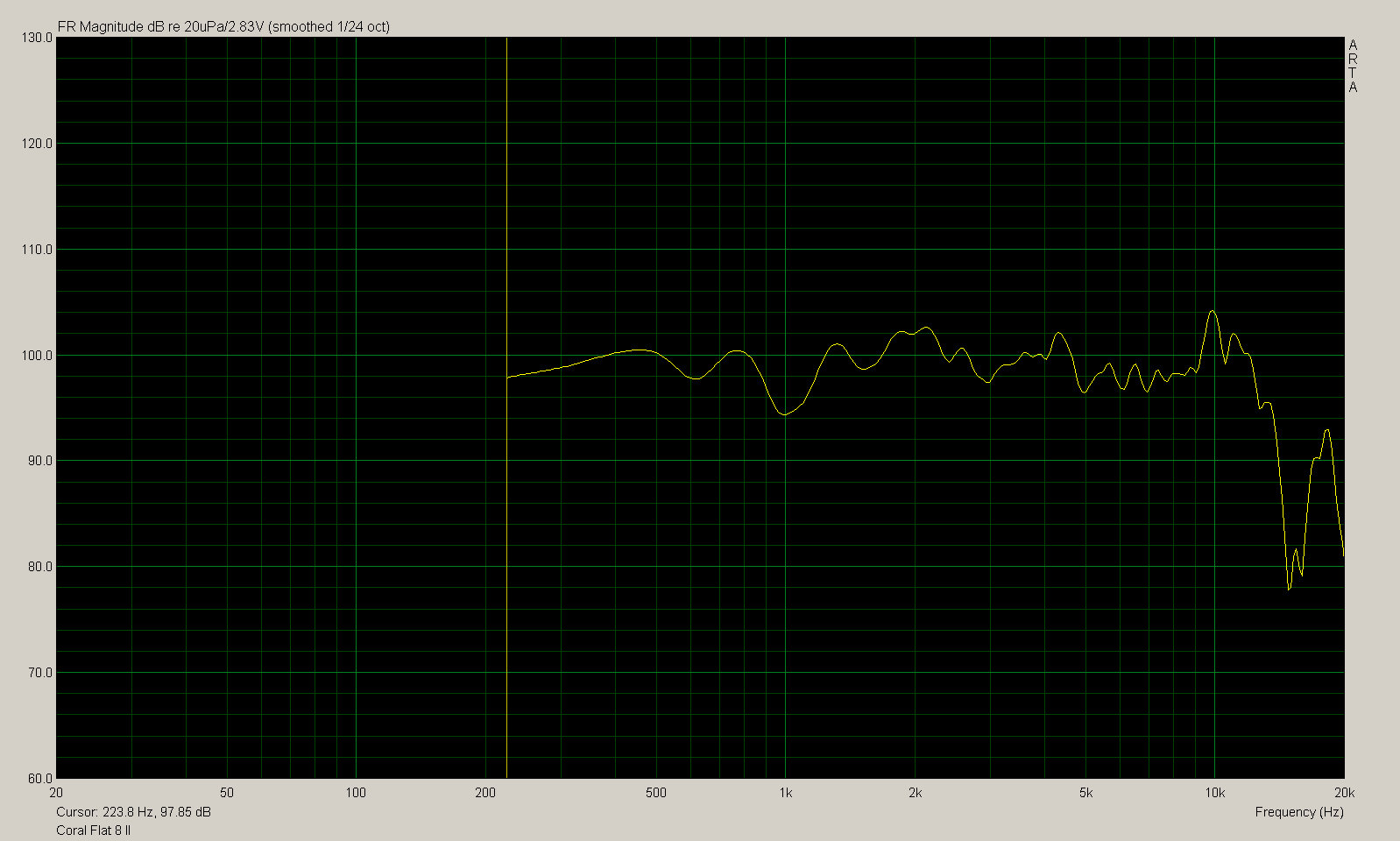

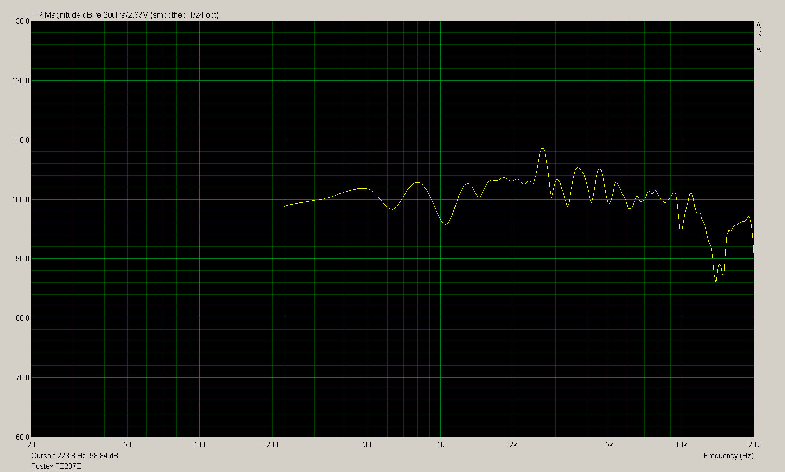

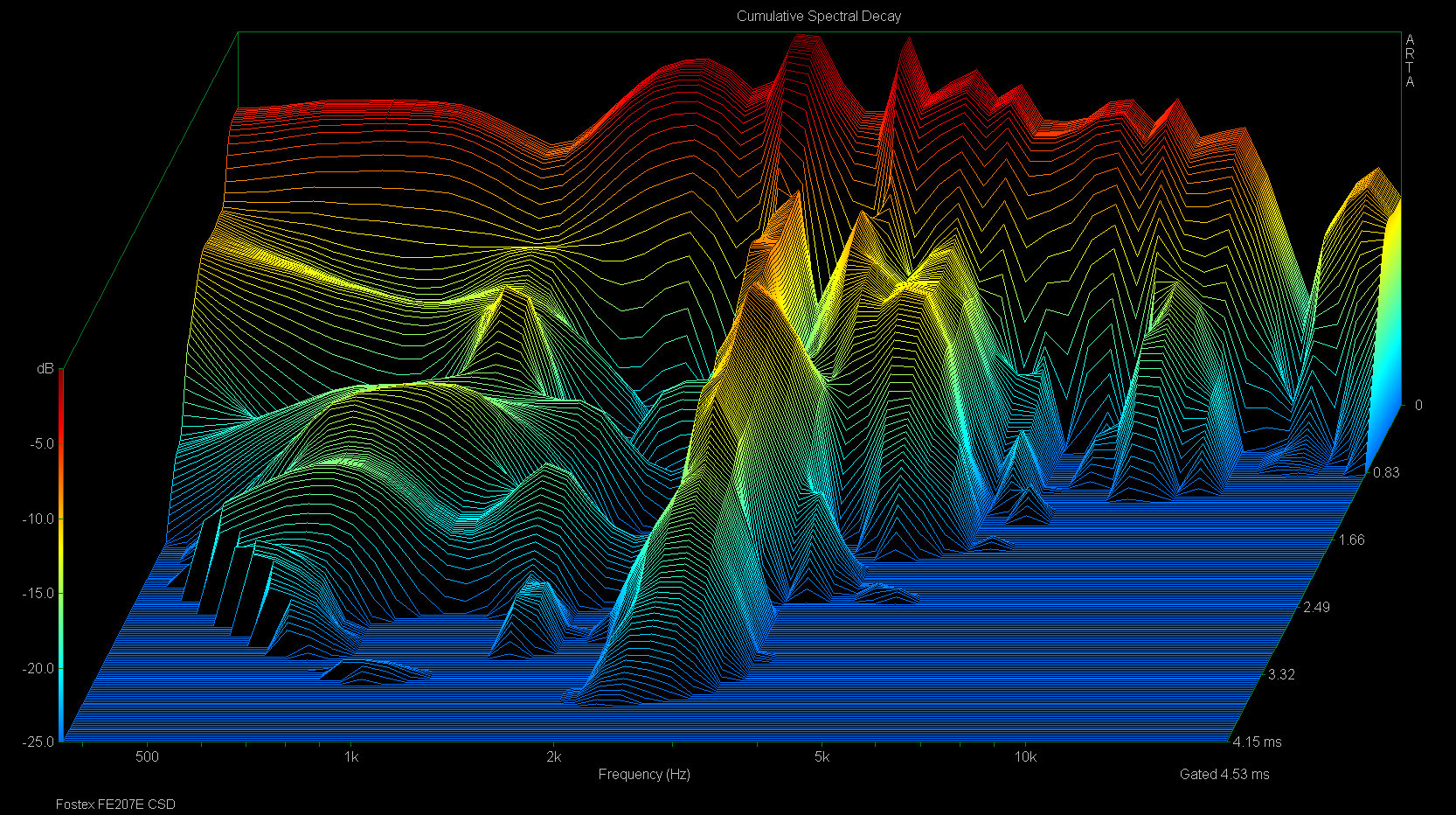

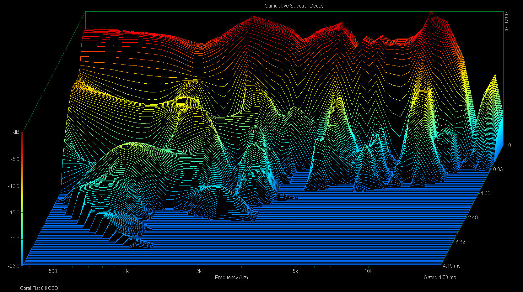

I've attached a frequency response measurement of one of mine (only accurate above 1Khz due to a relatively small measurement gating time) and the 5dB resonance spike at 2.6Khz is very obvious, this is the main problem with these drivers and seems to be a whizzer cone resonance. Short of cutting the whizzer cone out you won't fix this resonance, as it just isn't a well designed whizzer. (For starters is conical instead of curvilinear)
There are other serious resonances as well, including some around 4-5Khz which are cone breakup of the main cone. I've attached a cumulative spectral decay as well and the resonances at both 2.6Khz and 4Khz are very obvious and it can be seen that they ring for a very long time, (nearly 4ms for the 2.6Khz one) this is what you're hearing which sounds painful to listen to.
Some people would say that a spike in the response is inevitable from a whizzer cone but its not necessarily the case when well designed, as a comparison I've also attached the response of a 40 year old vintage Coral Flat 8 II, (same test conditions, also only valid above 1Khz due to measurement gate time) also an 8" driver with an even larger whizzer cone than the FE207E, and its remarkably flatter in the 2-5Khz region with very little sign of a whizzer resonance, and just a bit of a main cone resonance at about 4.3Khz. The difference between the two drivers CSD decay is quite a stark contrast. Needless to say the Coral driver sounds far better and doesn't have the shrill ear bleeding upper midrange of the Fostex.
I know its not what you probably want to hear but I would give up on the FE207E and look for a different model of driver.
I listened to it for some time in the shop, switching to the 105 (as I am looking for relatively small speakers for a 2nd system), and while I expected exactly that irritating behaviour from the plots, the reality was however quite pleasant. Perhaps because that peak is at around 8 khz, it is less noticeable than the one of the 207?
It was a difficult pick vs the equally very nice 105, but I picked the 125 as it can handle a bit better bass while still being nicely extented in the treble.
