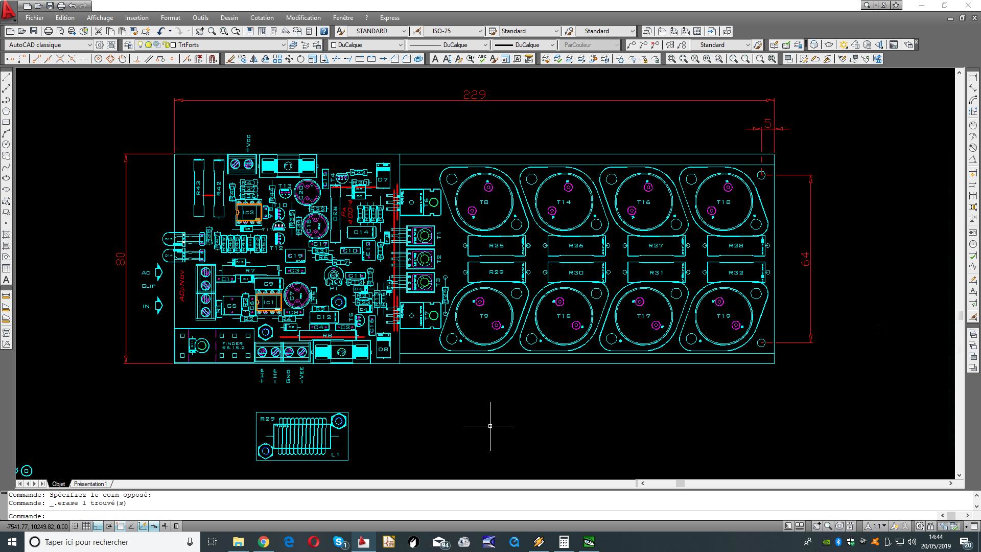

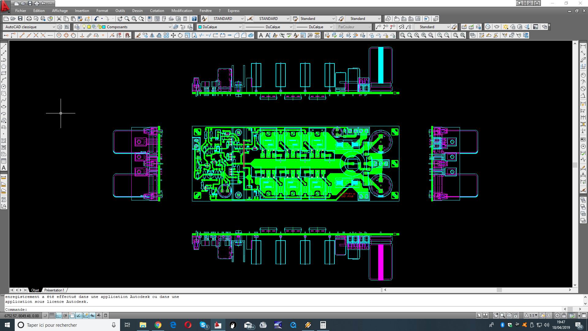

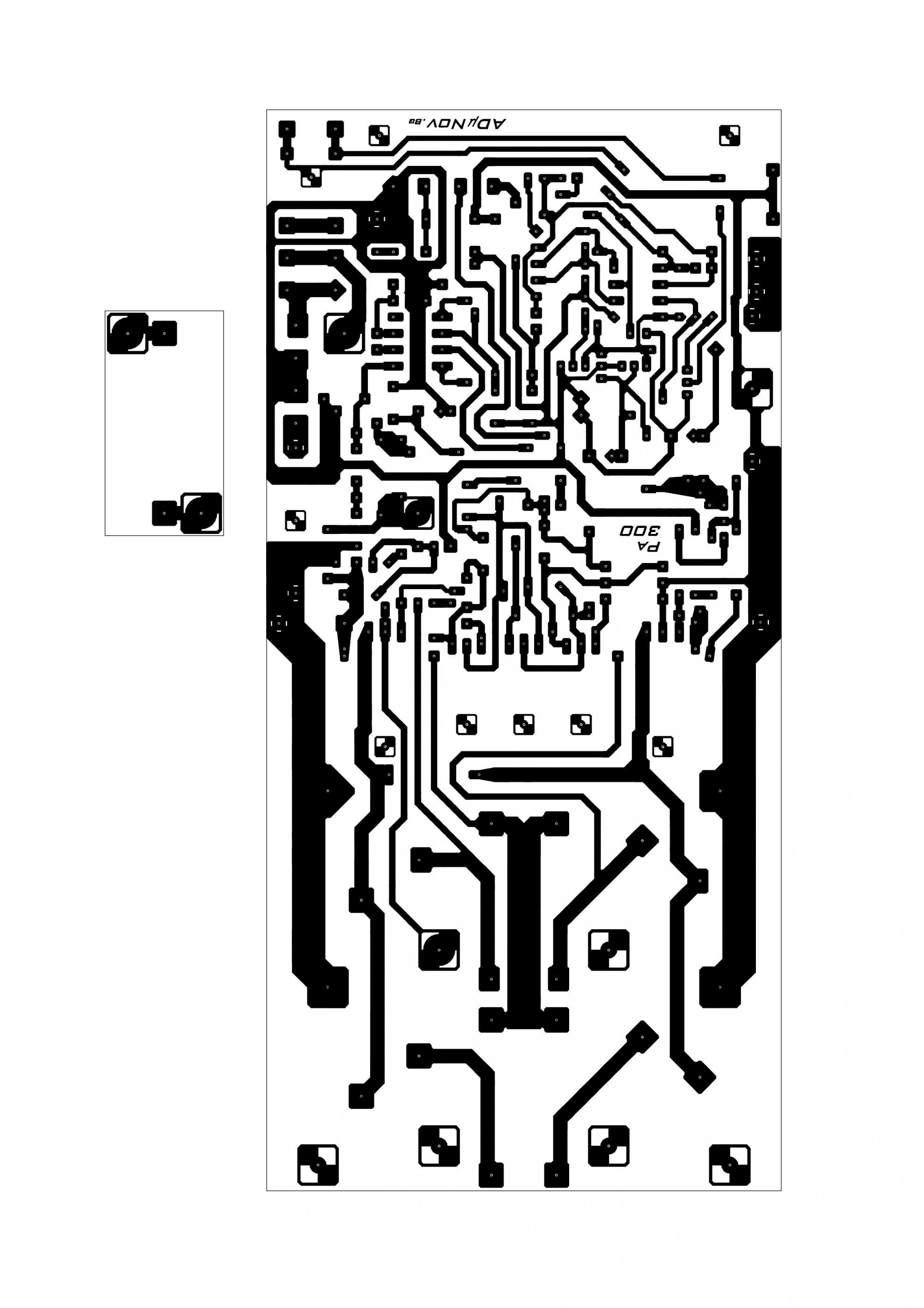

I have built both the PA300 AND PA600 both worked well. I did encounter oscillation when using the NE5534 so remember to put a 33pf cap between pin 6 and 2 of the opamp
PA300/600
Hello, Bruce.
Thanks. Noted. For the capacity.
For PA.600, we were not sure of the pattern, according to Olivier.
We have rerouted PA.300 according routing logic note and added the extension PA.600. So we must review the resistors R41 e 42 for the rail 80 volts.
Thanks again.
Jacky
Hello, Bruce.
Thanks again.
Jacky

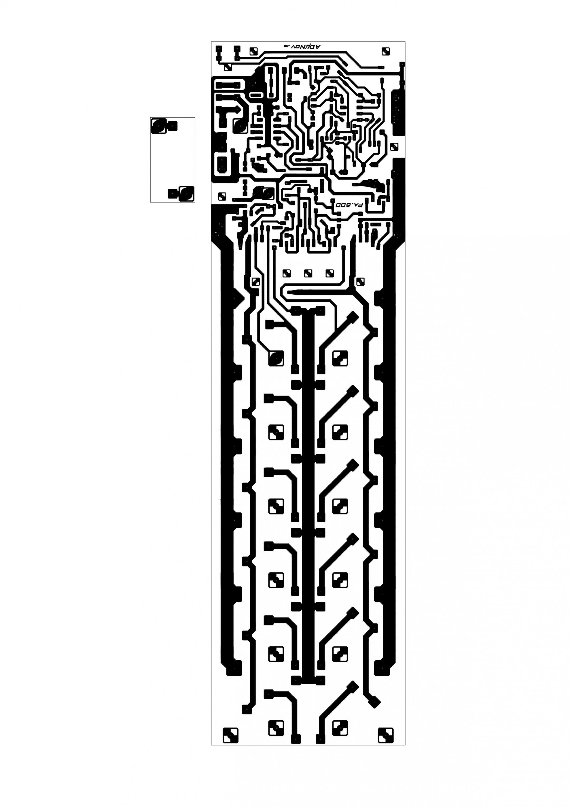

PA 600 essentially the PA300 with more output devices. I ran mine at-+90v and used MJL21193/4 T03

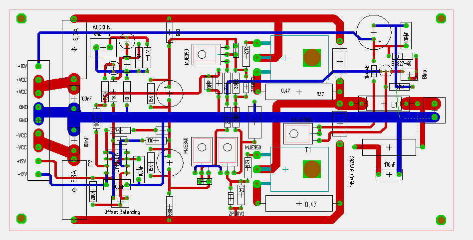

Hello, Bruce.
Thanks for your advice.
In fact, the printed circuit has been redrawn to miniaturize as much as possible. This is the copy according to PA.300 Elektor. Later, we came across the pattern of Mr. Olivier.
In Pa.600 We just increased the numbers of transistors. and changed the resistances to hold +/- 90 volts. We will start building. We'll keep you posted. Thank you so much.
Best regard.
Jacky.Tanski

Good luck, unfortunately I sold my pa600. Compared to this modern class d rubbish it sounded fantastic, you will enjoy the sound from both the 300 and 600
Hello, Bruce.
Sorry, I did not see the message back.
We are checking our work. Diagram, circuit board. We are also in an amp study starting from the work of Quasi and Astx. Attached images.
We give you all the results, when everything will be built.
Sincerely, Bruce.
Jacky

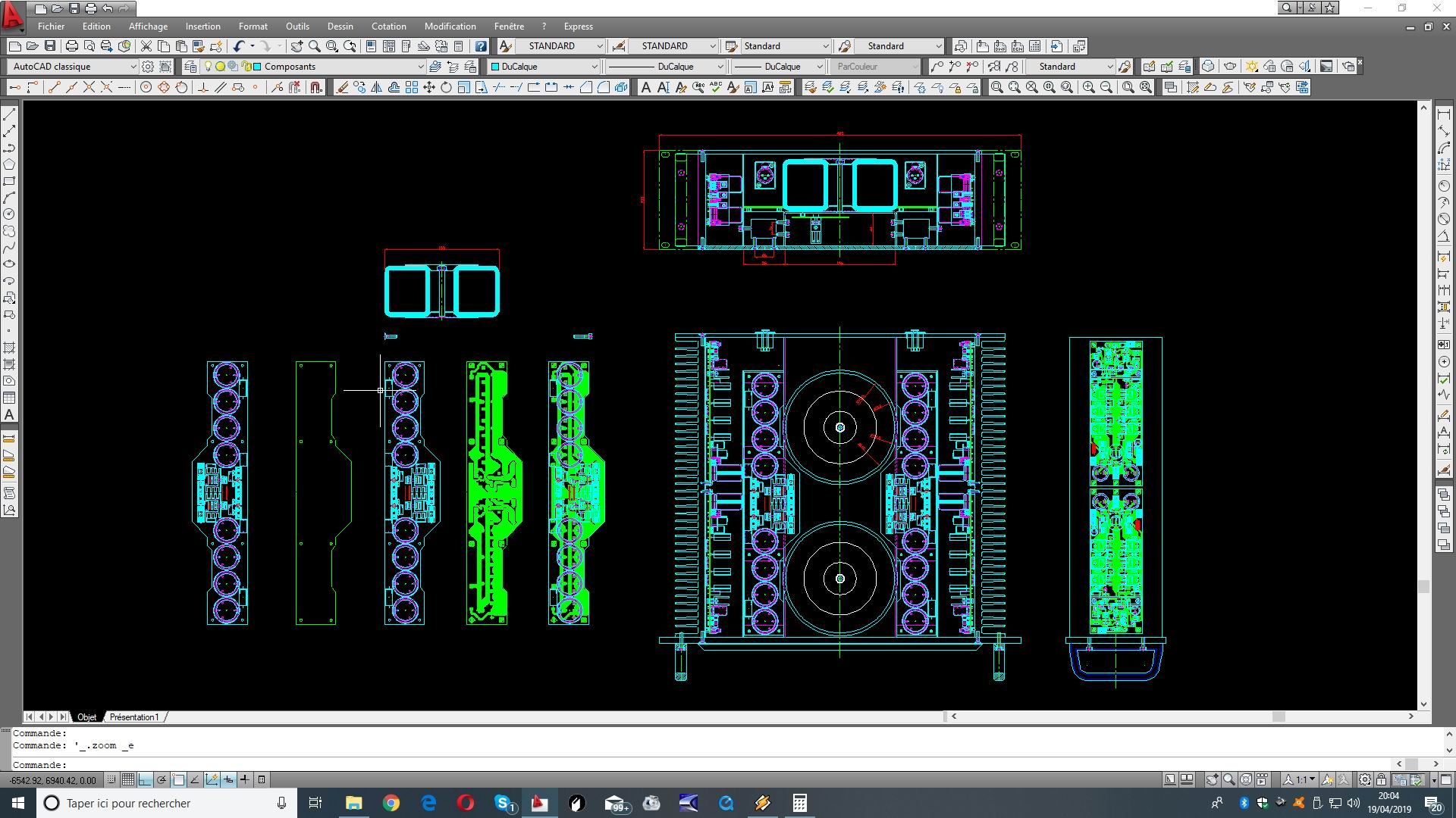

That's what we are trying to build. for now, this is just the study. We left Astx and Quasi.
A big thank you to them. You are a great source of inspiration for us. We are not specialists. but we do our best
There is a lot of enthusiasm for the handymen in Emmaus village. We recover parts by recycling discarded electronic devices.

Dear Jacky,
nice to see my power supply design reused. Feel free to use the pcb layout as long as it is non commercial and the copyright notice is left unchanged on pcb!
Have fun,
Toni
Have fun,
Toni

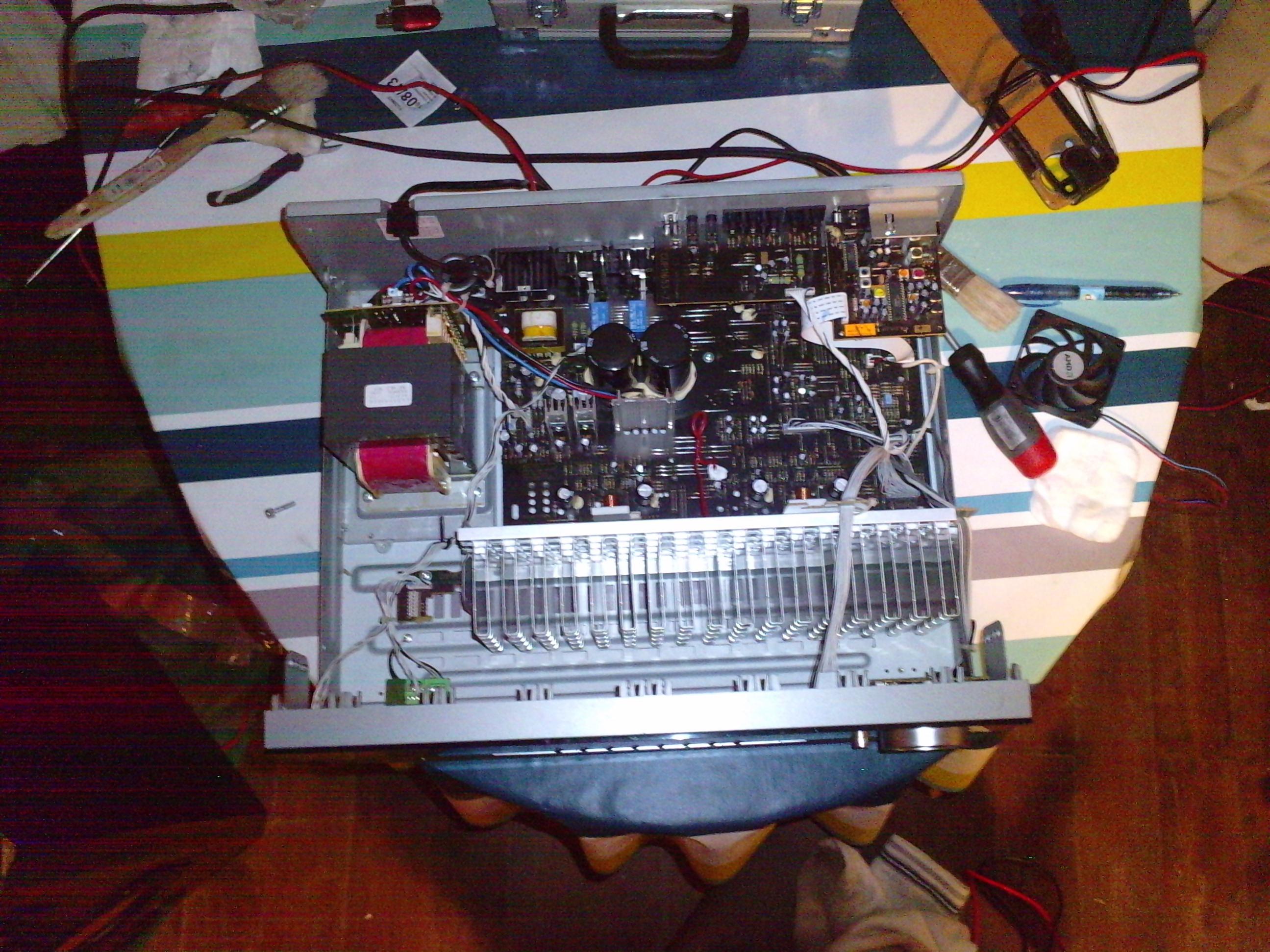

The charity Emmaüs has 250 people. Rather old age. I am 62 years old. We take care of the poor, the sick of people broken by life. The region where we are located is very rich. So the people of the region give us everything electronic.
We repair, we polish, in short we restore, then we sell at very low prices for those who are not very fortunate. This is especially true for computers, télévision and HiFi. What is not repairable, we recover the components piece by piece, we test them and we reuse them for us. We have hundreds of amplifiers, Harman-Kardon, Pionner, even accuphase, that's saying !.
There is no question of trade here. Our generation sums or HiFi wanted to say something. The old school somehow. We do everything on Autocad. We build and equip the people of the village. The HiFi is for us a way to forget all this misery.
That's it for the little story.
Thanks again, Toni, your work is great and inspires us.
Jacky
Ps:

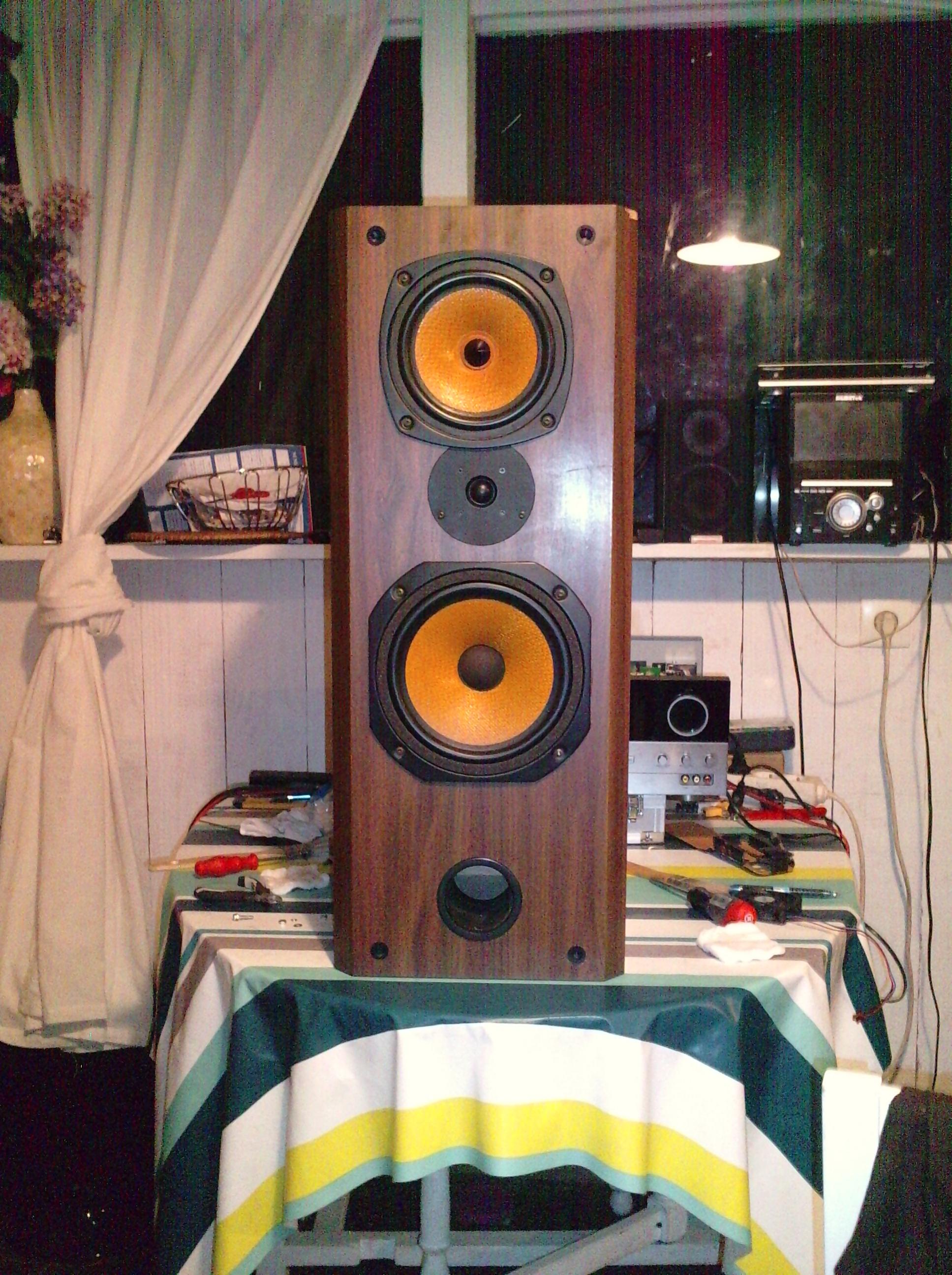

A Harman-Kardon amplifier repaired plus Davis speakers.
We mail you our request on another message.

Re, Toni.
Would it be possible to have the other cards of your amplifier.
Protection, input circuit. We do not really know how to play the four amplifiers together. We have watched well on the Internet, but the solutions do not speak to us! Just the PDFs, as you understand, one has the habit of routing everything on Autocad, laughs!
Thanks again for the little message, Toni.
Jacky.

Sir Oliver may i know the value of resistor in PA 600 R121 AND R122 THANK YOU IN Advance sir god blessYugaaa,
the "PA 300" can easily be scaled up to 600W RMS per channel into 4Ohms without modifying the circuit too much. I've built several of these. Bridging is simple and gives you up to 1200W RMS into 8 Ohms. It is not as good sounding as "Titan" / "Gigant" or other more sophisticated circuits, but very simple and rugged. Just exactly what you need for PA or subs.

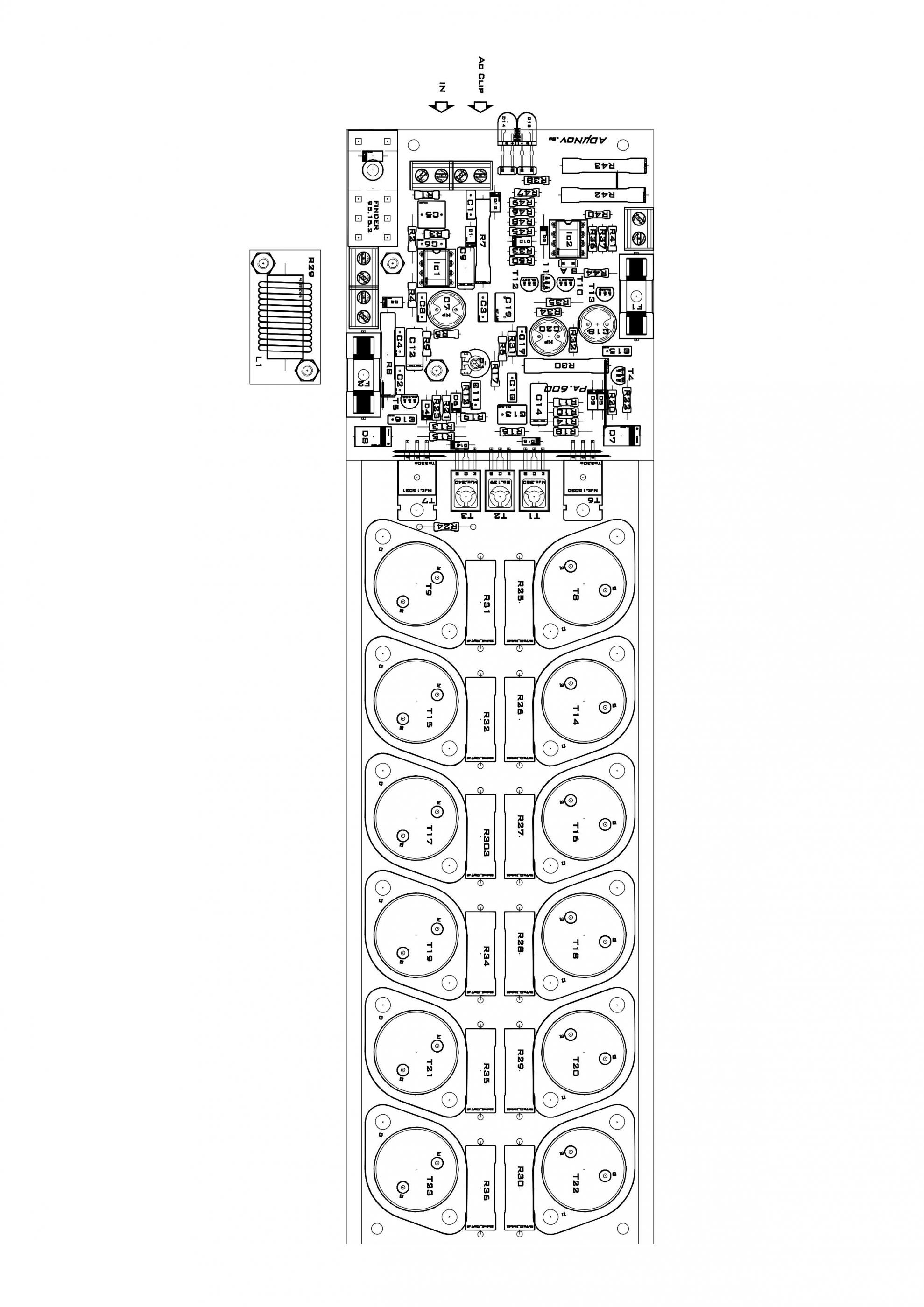

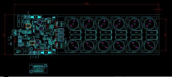

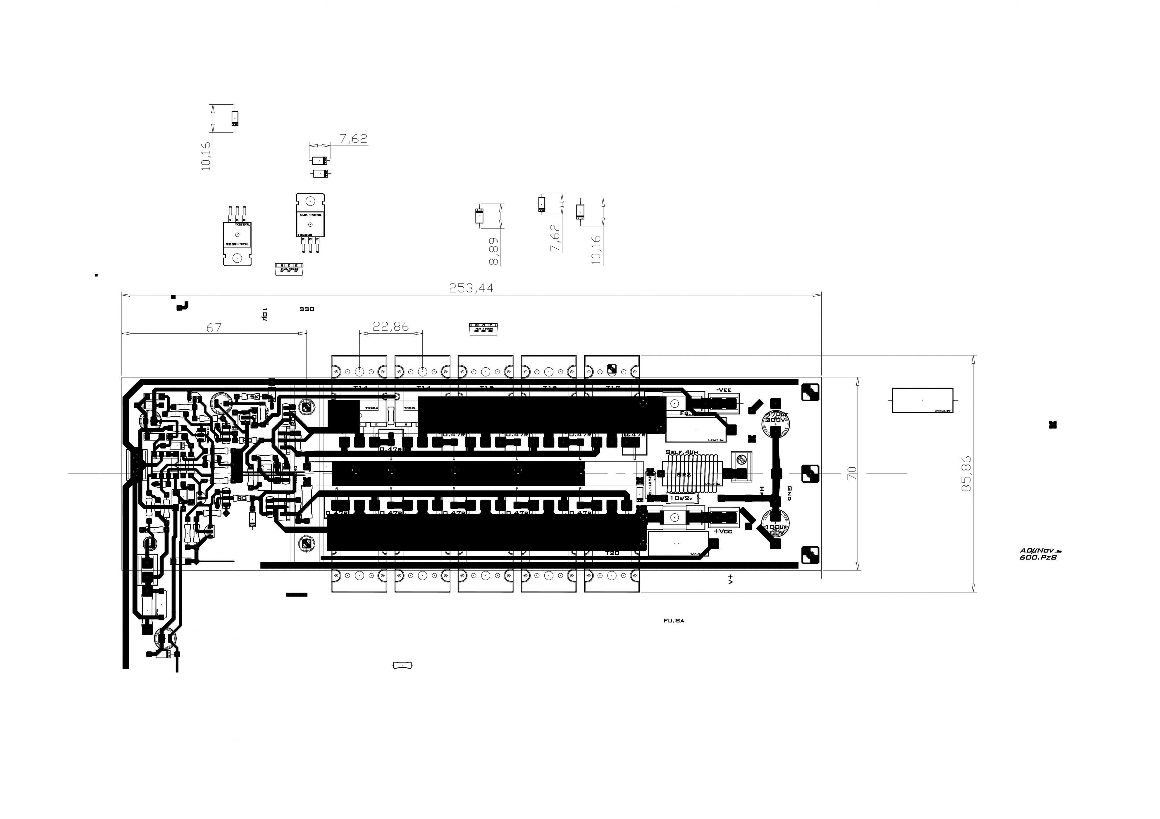

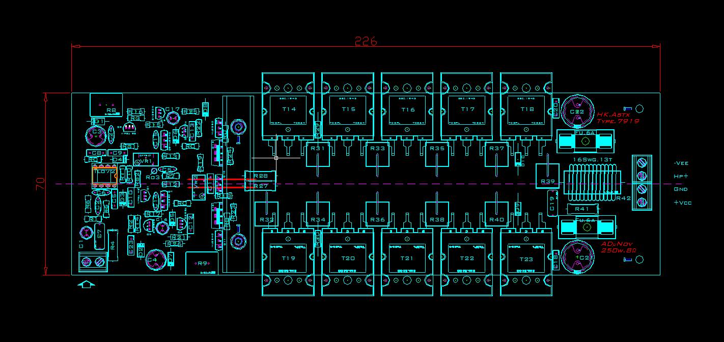

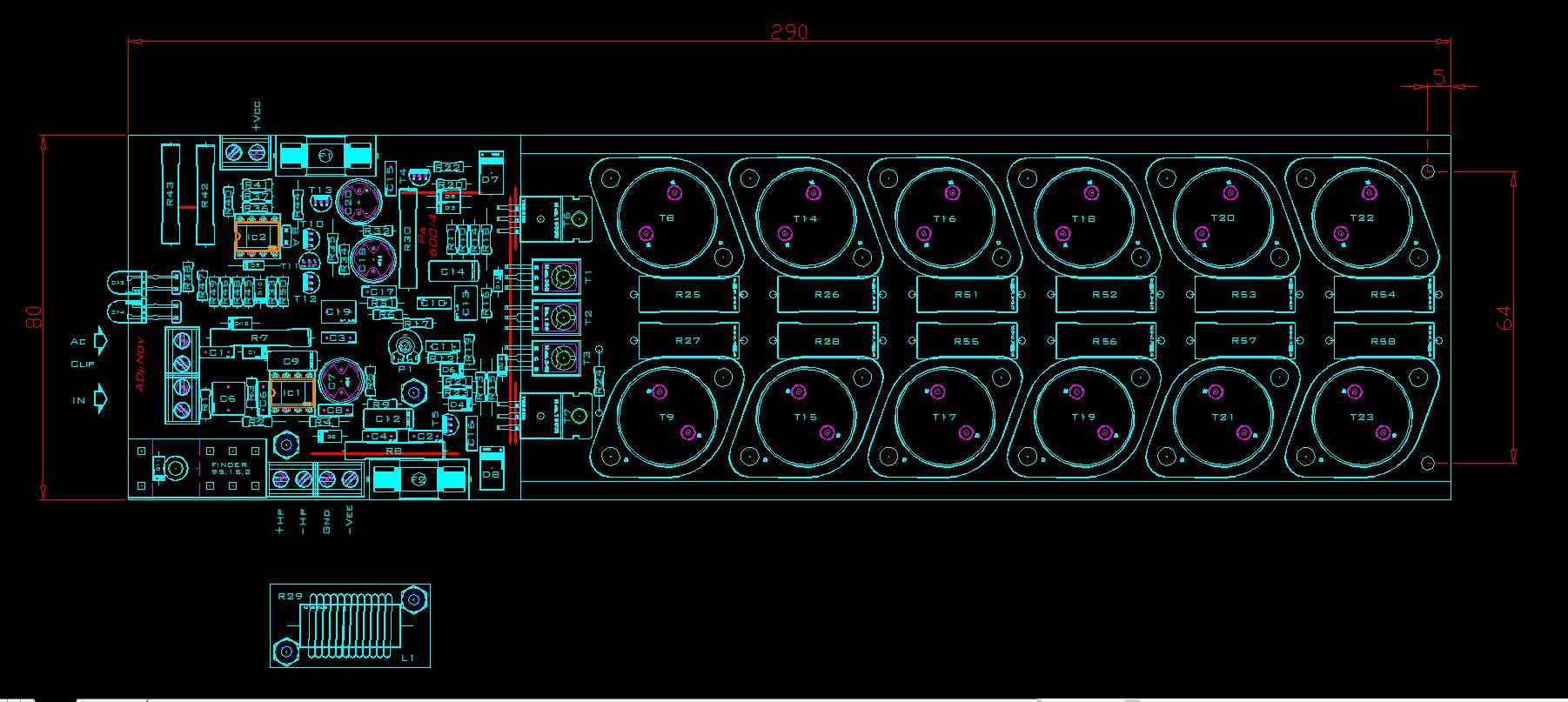

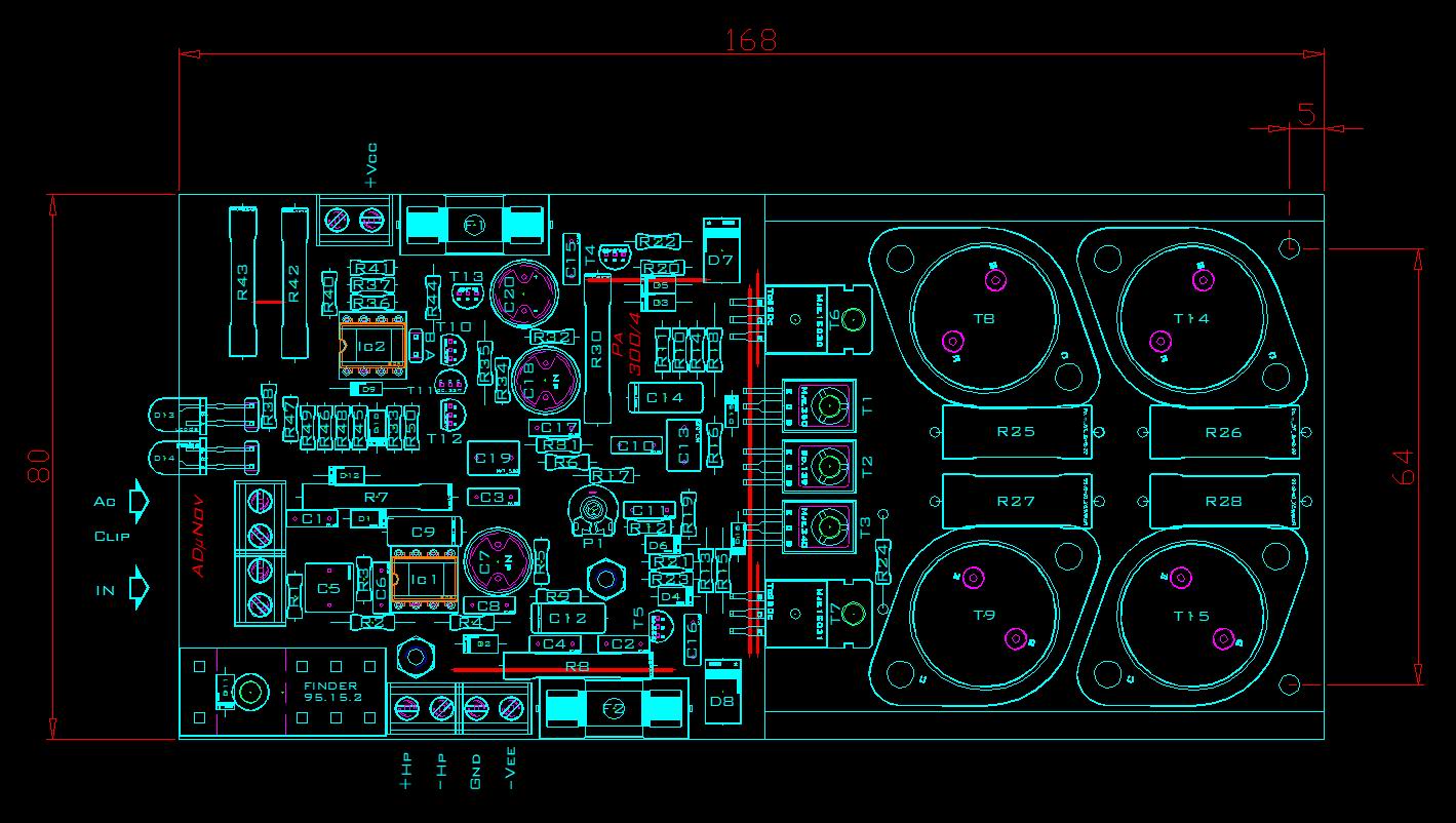

PA300/600
Hello, Kay.
Sorry, I went to sea to recover refugees. the sea campaign to last a long time. To answer. The Pa 300 works great for HiFi without problems. The NE5534 is used worldwide in half of the audio circuits on the planet, laughs!
It's not the McIntosh circuits, but it's very good at the level of operation. The trick in fact would be to power the NE5534 with regulators like 78xx and 79xx. This makes it possible to lower the residual ripple very low and at the same time the background noise. Always better than the couple zener / resistance. Properly tuned and properly wired, the PA300 is a good amplifier. The circuit is quite universal. Easy to modify for greater power and the use of other power transistors.
Kay, sincere greetings. Jacky

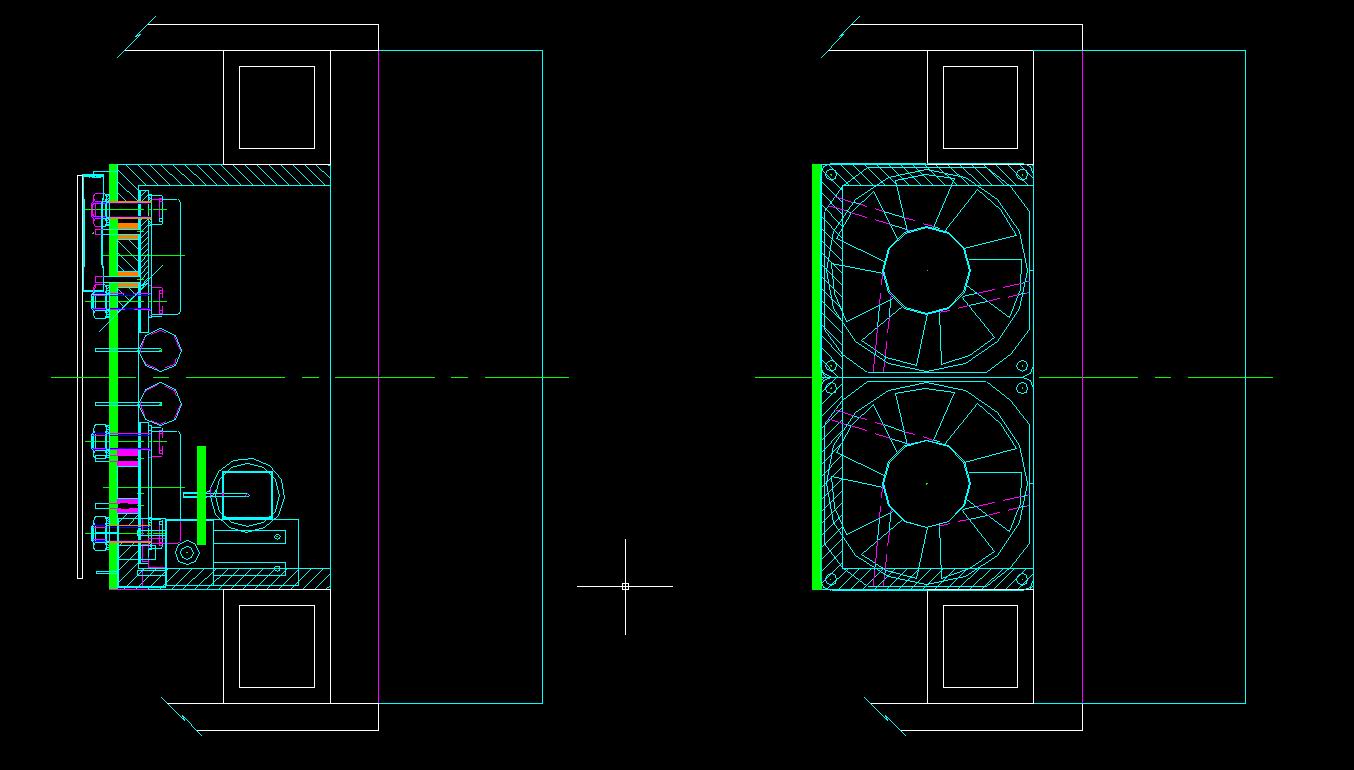

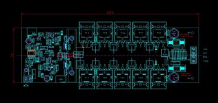

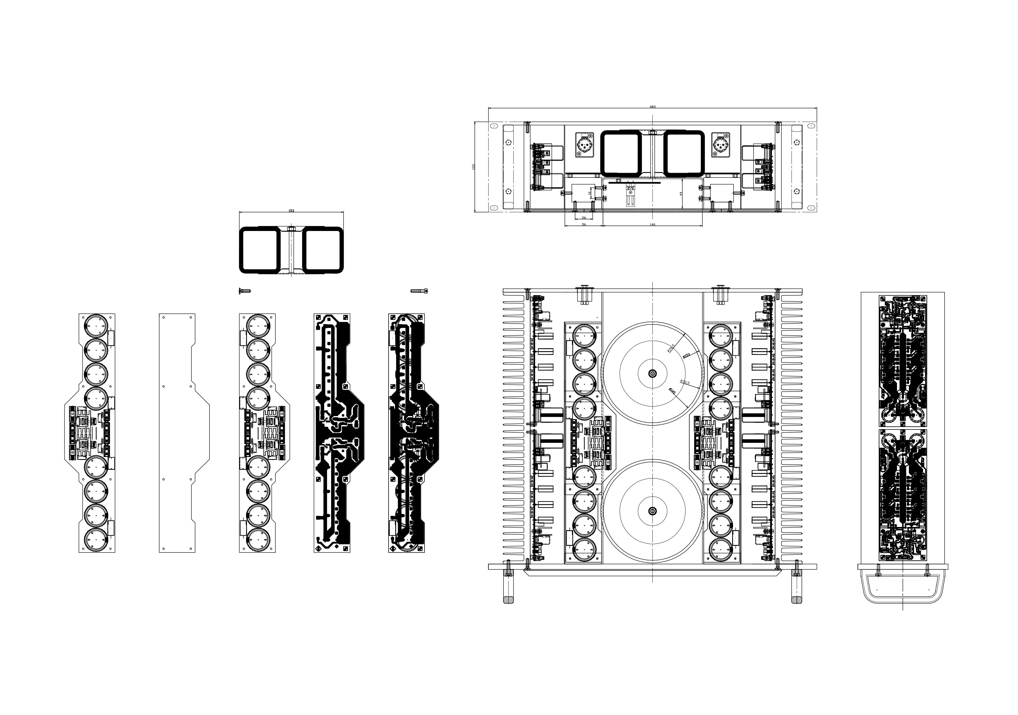

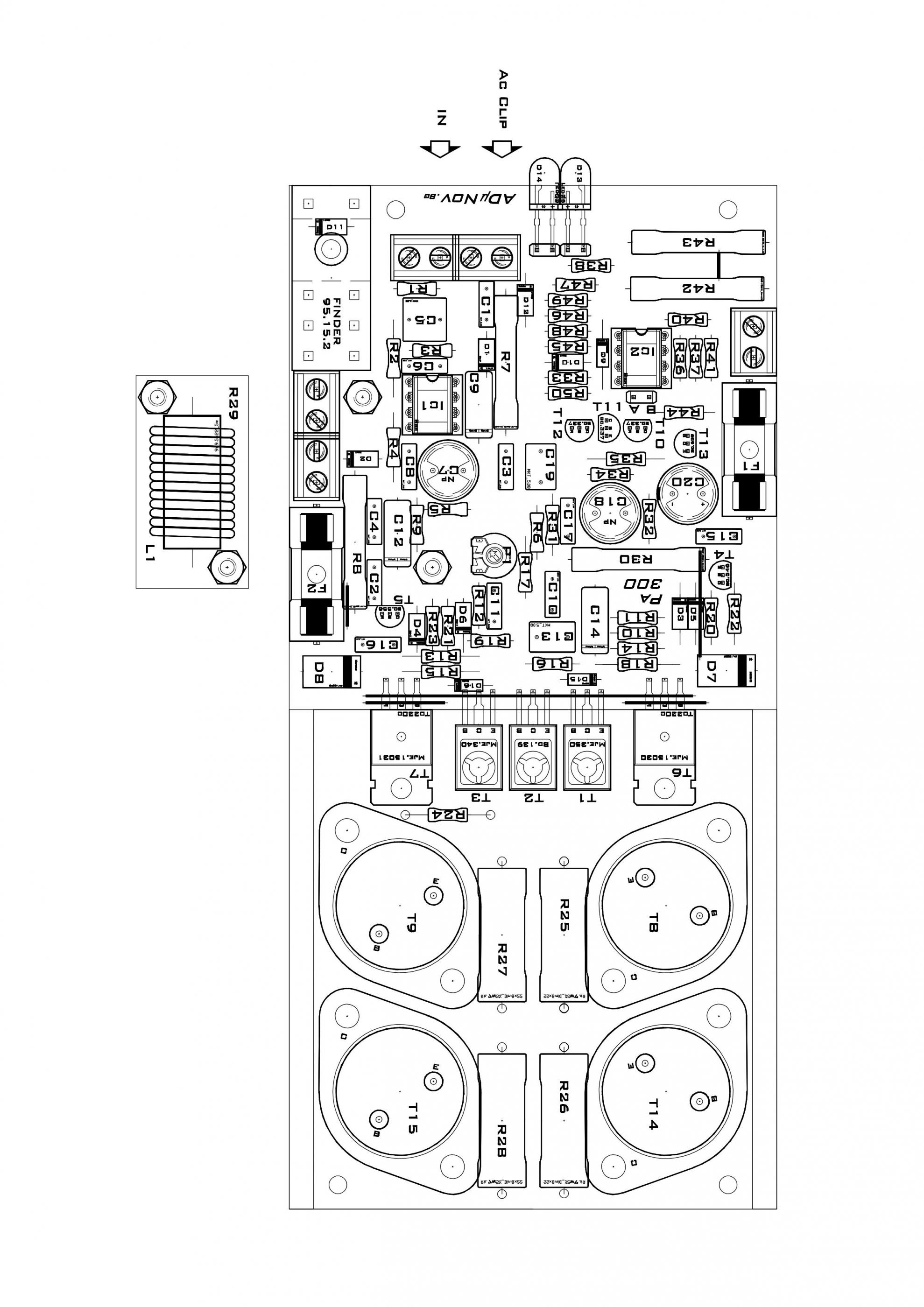

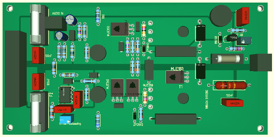

Ps images of ongoing studies on the PA.300, 400, 600.
This is the exact copy of the Pa.300 Elektor. Except that the specific routing adapted to the ASTX system.

Thanks, Jacky, and an interesting modification!
I don't see how the TO3's are joined with the heatsinks, though. Maybe due to the rather small and hard to decipher drawings in your 2nd pic?
And if we'd think of the more recent MJ21193/21194/21195/21196 ring emitter devices instead of the ancient MJ15003/15004's, we'd also have TO-264 MJL or TO-247 MJW (almost) equivalents that surely would decrease PCB size and ease PCB routing and mechanical mounting as well.
Best regards!
Best regards!

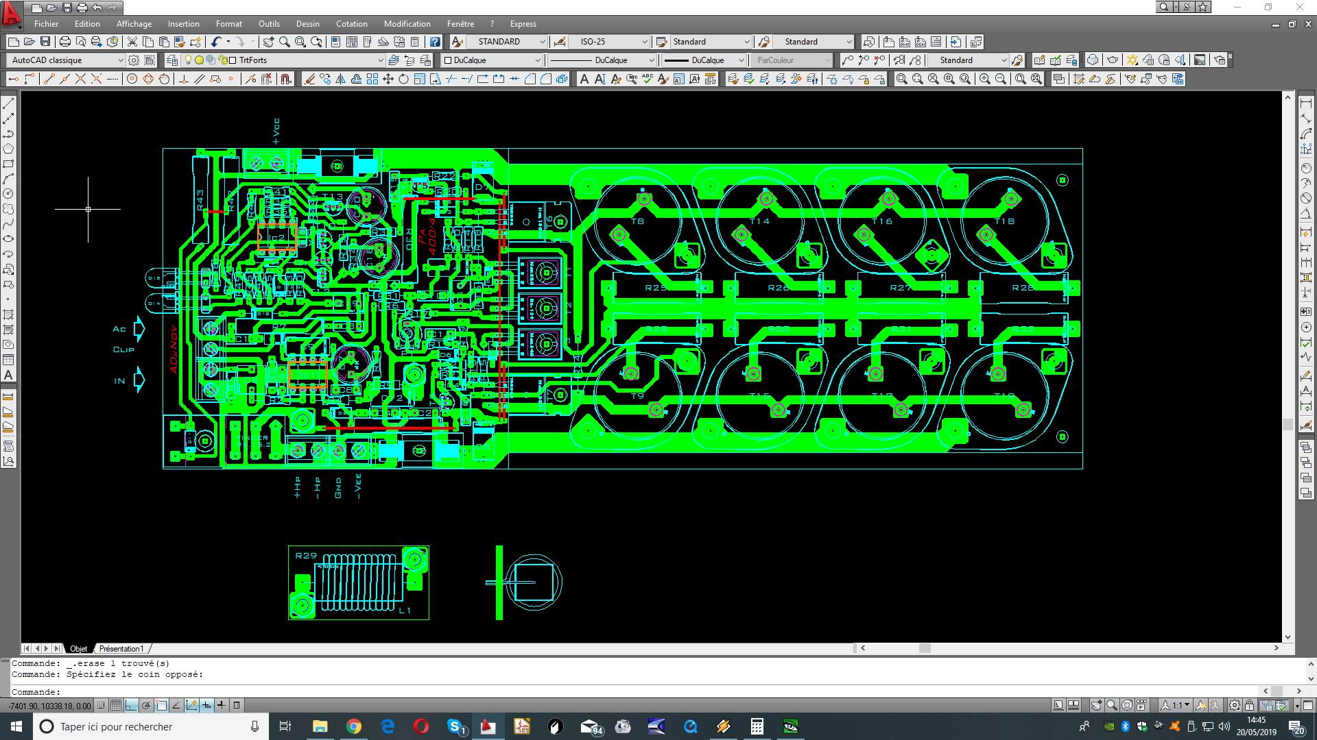

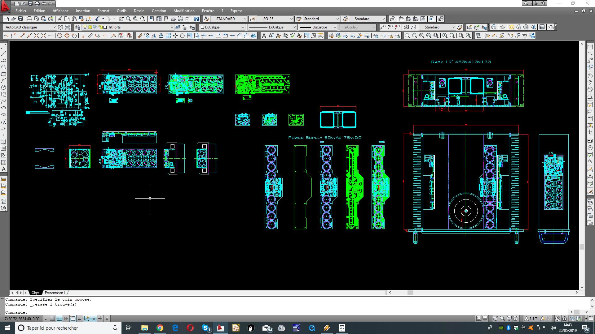

PA300/600
Hello, Kay.
Thank you for the answer.
Exactly. The To3 cases were the top. the system was very well designed. The new boxes are for the sake of economy. They take up as much space, if there are many pairs. See the images as an example. the pa.300 was designed on a 194x124 map of ours, 80x168, cool no! The Pa.300 is complete with full protection. Thermal, dc detect, clip etc! If we add the same protection on a map Top.3 pl congestion increases very quickly. See the map 226x70, without any protection. There is the Ips system, ops that separate the input circuit with the power. Ok, but I like the shortest links possible at the Pcb level.
Anyway you have to do with!, Laughs!
To return to Pa. The To3 are mounted on aluminum brackets, as Elektor originally see the attached drawing.
I have studies in progress with modern type Mjl transistors, but I have not finished routing the Pcb yet.
Sincerely, Kay
Jacky
