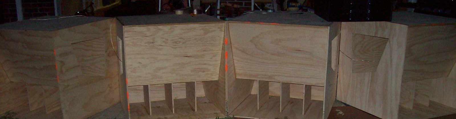

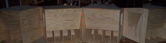

Well, this single sub is really only going to need to be used for very small events like 20-50 ppl max so I think the 1 sub should be enough. I just don't know if 80hz is going to be low enough, but on the other hand I don't want a huge sub to lug around
Is there something that is about the same as the Tuba36 that might be a bit lower?
T36 built correctly should get way below 80. The 4-pack of T36 Slims I heard sure did. Labhorns will blow them away, but well, they're BIGGER with two drivers. They should.
If you want something with a big bang for the buck try modeling this:
50 square inch throat, 21x34.5" mouth, 89" path length, M=0.6, driven with Kappa P15LF2. It should fit in a T36 Slim form factor. I'm still working out the folding details of this one - it's my next horn project. Four on the floor models solid to 40 Hz, two are useable.
