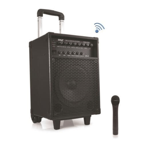

I am running a Soap Box Derby race and I saw an announcement system at another race I wanted to duplicate. They used horn speakers connected to a walkie talkie. This allowed a separate walkie talkie to be used as a "microphone". This is an outdoor event and the system is used to announce which racers are on the hill and also times of each heat. We have a small portable speaker with a microphone and it can only be heard by those within 50 ft or so. Any idea how something like that would work and what equipment I need? Or how I might hook additional speakers to the current sound system and run them via wire to other parts of the venue.
Thanks in advance
The speaker we have is a PYLE PWMA230BT with ports for audio in and out and also has bluetooth. We are able o use it with a microphone plugged into the speaker, it just does not project far enough in an outdoor setting as spread out as we will be.
As you imply, your Pyle portable PA system is best suited to indoor use.
There is no facility to connect additional loudspeakers, but it does have a 1/4" TS line output (AUDIO OUT) which could be used to feed a supplementary amplifier/speaker system.

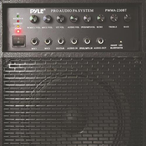

Fortunately, the OP's Pyle portable PA system is fitted with a bass control which can be retarded if necessary.

why not horn load your current Pyle speaker? a simple 45 x 45 degree baffle with a mouth of about nine square feet ought to do nicely the increase in spl would surprise you but where the controls are on the Pyle would be a problem.
placement above crowd height is also a good way to help get more sound out to the crowd ...if the system is simply on the stage or on the ground your dead in the water, a means to elevate the system is a must.

I've just been looking at the Pyle PWMA230BT manual: https://www.manualslib.com/manual/2376384/Pyle-Pwma230bt.html?page=3#manual
I see there is an "Audio Out" socket on the rear panel of the unit (labelled 30 on the illustration).
I presume this is simply a duplication of the "Audio Output Jack" on the front panel.
It may not be advisible to open up the Pyle to add an external speaker jack as the manual does not tell us into what range of speaker impedances its amplifier can safely operate. Besides, this would invalidate any guarantee that is extant.
The least invasive way to solve your problem is to add a supplementary 12V PA amplifier and horn speakers via the Pyle's Audio Out socket.
