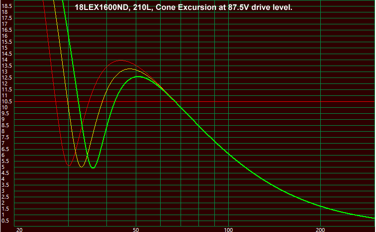

Here's 3 versions of your project with different tunings - 30, 33 & 36Hz. Higher tunings give a bit more level not just at the exact tuning frequency, but also over an octave or so above it - which is quite a lot of the range in which we use subwoofers.
However, there's a little bit more to it.
Here's the excursion plots for these 3 tunings, at the same drive level:
As we tune higher, the excursion above the tuning frequency reduces. That means we could drive the higher tuned versions harder than the low tuned ones. Of course, that does require using a High Pass Filter just below the tuning frequency to prevent the uncontrolled excursion down there from damaging the driver (& causing ridiculous amounts of distortion).

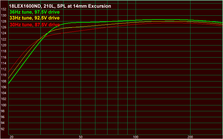

So, if we increase the drive level so that each one is at 14mm excursion, the maximum SPL becomes this:
