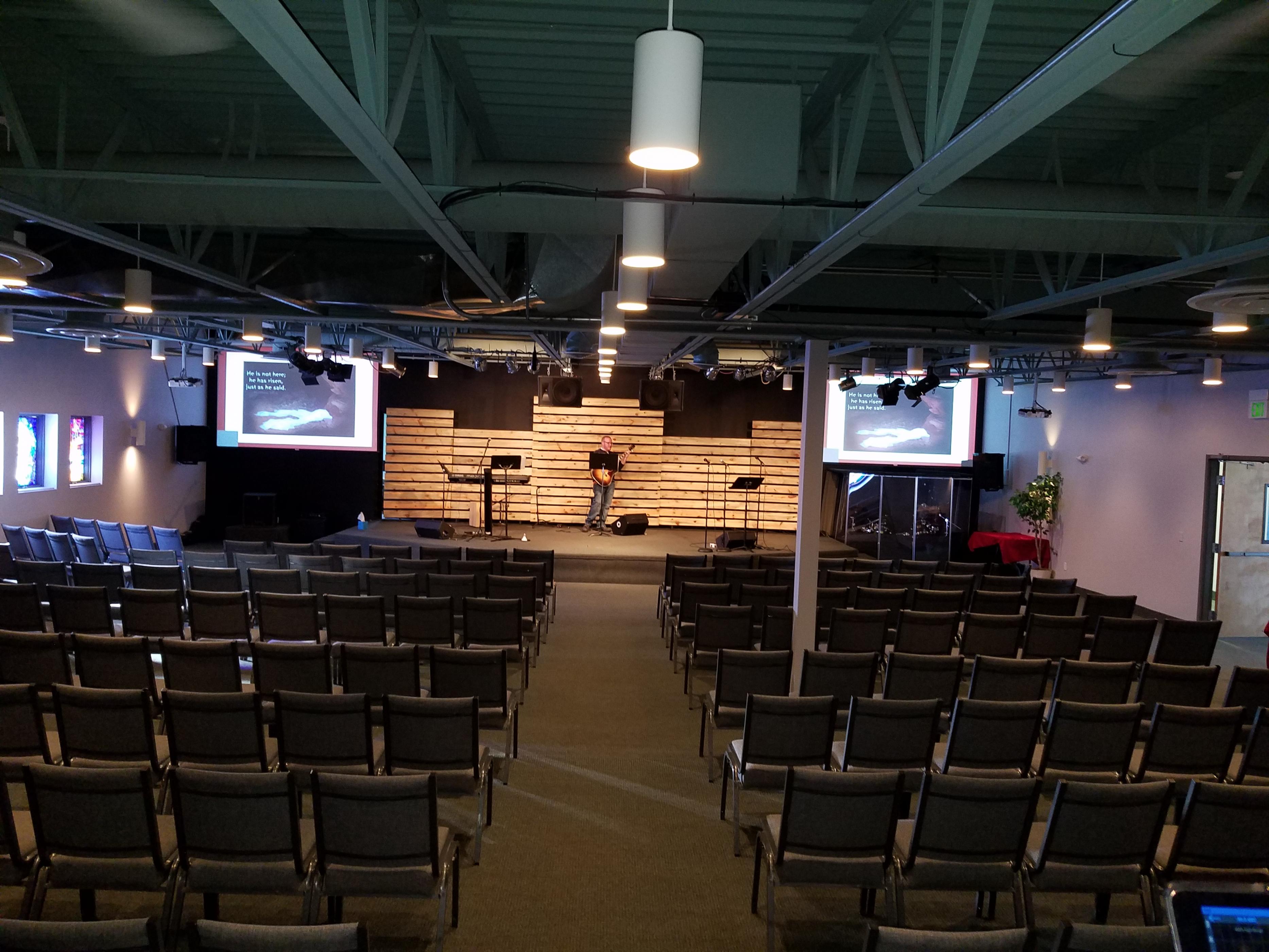

I'm planning on embarking on my first journey into PA loudspeaker design. I fully understand that this is not the most economical way to make good sound for PA purposes but I've been designing Hifi loudspeakers for over 10 years and I'm ready for a new kind of project.
The best thing I've learned in my foray into Hifi loudspeaker design is that attention to what is happening off-axis makes all of the difference in the world. However, I'm having a hard time understanding dispersion goals of point source PA boxes.
The target location is a pretty small church with a room that is approximately 70' wide by 120' deep by only 10' high to the bottom of the rafter. The room is currently setup with a pair of MR 825 JBL's with 15" woofers and 1" tweeter. Due to ceiling height limitations and interference with lighting, the speakers are turned on their side. The horn patterns are 100x80 so basically we are getting an 80 degree (if we are lucky) wide pattern right now that does not provide adequate coverage on the sides. Note that the speakers are placed only about 3-4 feet apart dead center. There is some room between rafters to move the speakers up but that may cause problems depending on frequency. Like a 3 way low frequency driver could recess into the rafters but I don't think the bottom of a 2 way will work pushed up.
Since we can't really move speakers back further due to feedback concerns, I was hoping to move the speakers further apart and come up with a nice wide dispersion design.
So most people who design hifi speakers would never use a 15" driver crossed over at 2kHz as beaming will happen well before the crossover point. In PA speakers, is this often done just to save cost or is the beaming meant to meet the dispersion characteristics of the tweeter?
If I went the route of a 3 way design with something like a 6.5" mid, the dispersion characteristics might be much closer to a wide horn.
I'm confident that I can meet the SPL goals and design a good 3 way system. I'll probably vertically align the mid and tweeter and place the woofer adjacent to the mid/tweeter. What I'm not confident on is that the dispersion will meet the intended goals unless I can go really wide or add multiple boxes per side. How wide of a pattern can I get from a compression driver? How will this effect the response and output of the compression driver? Please excuse my ignorance, I've never designed speakers with compression drivers so I'm just learning how to effectively use them.

Turning those speakers^ 90 degrees will highly improve the dispersion of highs.
For this size of room I would at least use 4 speakers, 2 delayed.
They can be relatively small when a sub is added.
So this coming weekend we are going to move the existing speakers to a wider position and rotate 90 degrees. It might be hard to tell in the photo, but the current location also interferes with lighting and tall people on the platform. We do have a 15" JBL EON subwoofer in play right now but the room is crying for multiple subs as the modes are very bad.
Delays are a good idea but I don't know if I can sell it because it being a church and all, they like having people who think it is too loud sit in the back😉 The left to right coverage is the bigger issue right now....
That is a pretty small room that you should have no problem covering with a pair of speakers, I'd suggest placing them far L and R outside the screens at the wall/ceiling angled in and down some.

Home audio shares little with PA despite using much of the same equipment. The top priorities in PA are going to be coverage, inteligibility and sufficient SPL before everything else, stereo imaging rarely comes into it because only a select few listeners would benefit from it and live instruments are mostly mono sources anyway. To this end speaker pattern control or directivity should be a top priority in design, if you can keep most of the energy off the boundaries the system will deliver better results, but you also want SPLs to be somewhat consistent for all listeners so the idea is to position the speakers so they're not completely blasting those in front. In your case options are limited due to the existence of those projector screens so hanging them near the wall is an option that needs to be explored, this boundary loading will enhance bass output but that can corrected with EQ.

Live sound has many more difficulties to overcome before you can start worrying about how good the stereo image is. Consider, for a moment, the people sat right next to one of the speakers - they're going to get 99.99999...% of their sound from the speaker they're nearest to, so the idea of a stereo image doesn't really apply to them.
We've already said a 15"+1" cabinet is a bad joke. Sure, you might get some 80Hz kick from the 15", but the midrange suffers horribly.

With that out the way, a 10-12" 2-way cabinet, even with a 1" HF unit, will do a better job than your current setup. Put them on stands out past the screens and it'll be fine.
