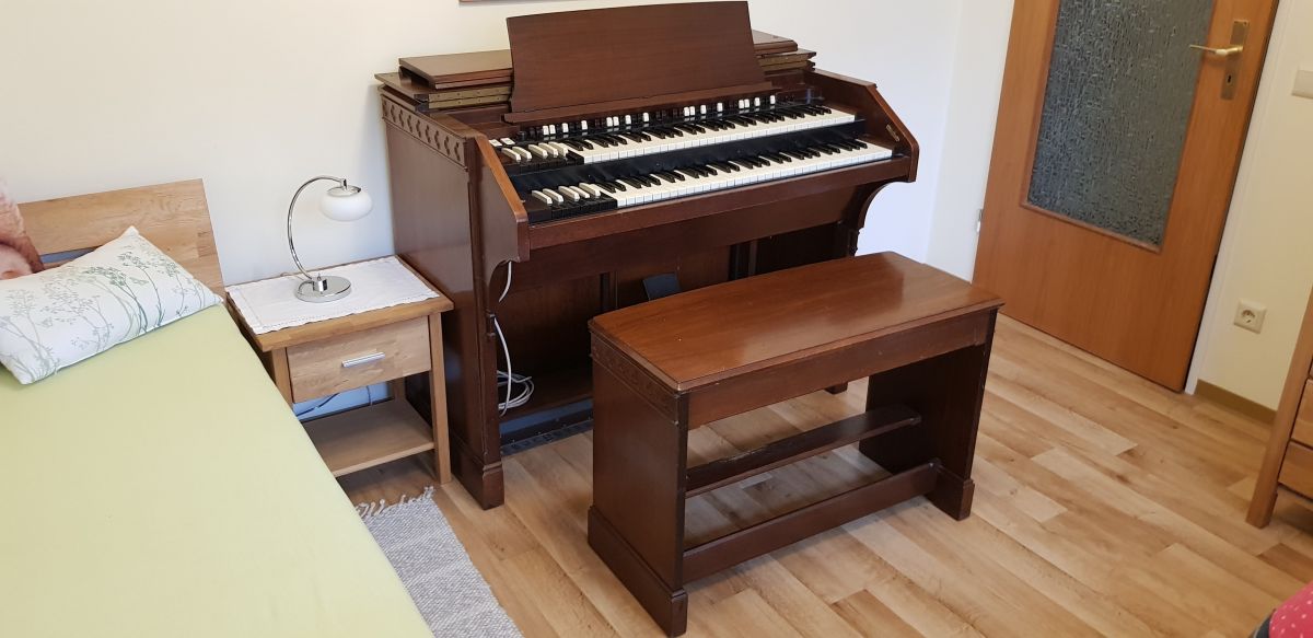

The organ I still own is a '50 or '51 C-2 in a beautiful quatrefoil enclosure:
Best regards!
Yes, thank you 😉 ! And that's exactly why I bought this first owner C-2. I know that a C-3 is the 'better' organ, but only very early C-3's came in this nice decorative cabinet. And these are hard to find. Anyway,in the meantime I've installed a percussion unit by Trek II that does more than the Hammond Harmonic Percussion in B-3's, C-3's etc.

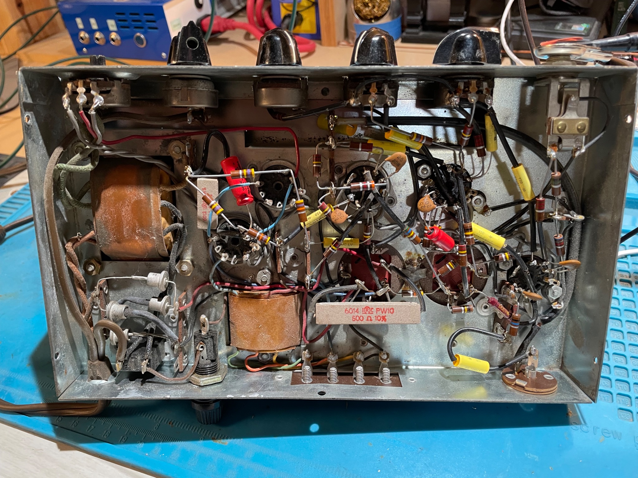

I'm restoring the same amp and need to identify the resistor that's sitting directly under the 500Ω 10W resistor under the can cap.
I put a 1K in there, but the audio is distorted. Can you help?
Sure would like to locate a schematic for it!
I’m so sorry I missed this when you posted it.
The resistor value is 2W 2.7K @ 10% (red/purple/red/silver). It’s probably a bit late for this information now, but since it’s not visible in my original photos I figured I’d add it just in case.
I’m just now finally getting around to restoring this amp, and after recapping (aside from the large cans) it eventually warmed up and sounds really clean on the 1/4” input. Now that it passed initial testing (after it was brought up to voltage on a variac over several hours) it’s time to draw out the schematic so I can figure out where I want to mod it.
It seems to have a separate gain stage for both the phono input and the 1/4” input, so chaining those together will probably be my first modification. Once I get a cabinet built to hold a decent sized speaker. Currently I’ve been testing with a 4” surround speaker.
I already have the new speaker, a Jensen Blackbird 12”.
It’s amazing how much more room is in the chassis without those Tropicaps.

I spent the past couple of days figuring out how to draw a schematic of this amp, and through brute force I managed to cobble something together. Uncle Doug’s tube basics helped a ton, and once I knew what each component was doing I knew what to look for as I was tracing through the circuit.
That being said, this is my first schematic, so I’m not sure what the conventions are. I know my power rail doesn’t look like what I see in most schematics, but I think it still makes sense.
It’s not totally complete, since I haven’t measured any voltages yet and most of the potentiometer values are a mystery still since I’d have to disconnect them to get something accurate. I’ll add those once I start rebuilding the preamp stage, though they’ll likely change during the modifications so they’re not super important at the moment except for completeness. I also cannot yet identify the diodes in the rectifier. Power transformer still remains to be specced out too. Coming soon!
I drew this in Inkscape and created my own symbols, so hopefully those are conforming to standard.
One thing I noticed when tracing this out is that I was under the impression that the last 12AX7 before the power tubes was a dedicated phase inverter, but it appears that only half of the tube is. If anybody has any insight into how the amp and/or tubes are configured here I’d appreciate it, since I’m still mostly clueless when it comes to tube configurations and design choices.
I definitely understand way more about how this amp is built now that I traced through the circuit though. Twice, actually. On my first attempt at a schematic I got the cathode and plate pins mixed up when I drew the tube symbols, and I didn’t realize it until I started tracing through my finished schematic and nothing made sense. I couldn’t figure out why every tube before the power tubes was feeding the audio signal out the cathode.
