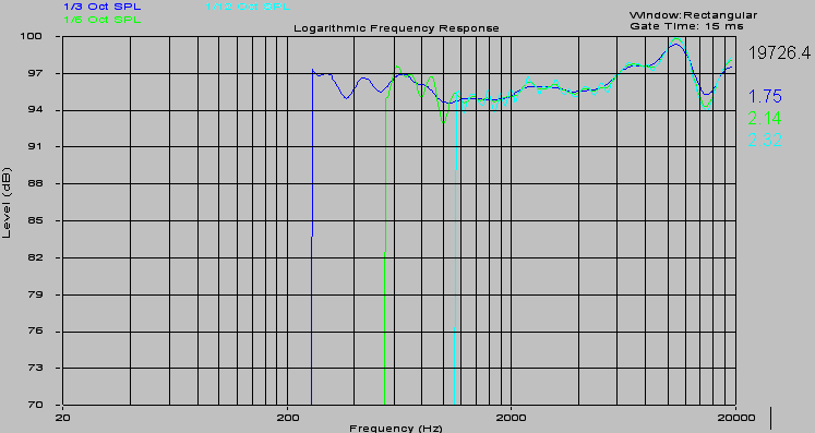

I have A-Bd some Behringer passive Truth 8"/1" monitors (which went astoundingly flat except for a slight 1.5dB peak at 2.5khz and a 2.5dB peak on axis up top which doesnt' really go away off axis due to the waveguide diffraction) both eq'd flat (like +/- 1dB from 500hz and up, thank you kX drivers) and the dynamics the pro-sound kit gives you is just absolutely addictive. Most hi-fi kit doesn't quite do it anymore on large orchestral works or rock (none of the hyper compressed shank so often heard these days) after getting used to prosound drivers.
BTW, anybody wanting a really nice cheap pair of "hi-fi" speakers who doesn't mind a slightly bright top end (but all withing less than +/- 2dB in the mids and above) should have a look at these first imo. Solid cabinett and for less than one could build them. Surprizingly clean waterfalls too. Only add-on would be a Grille cause they look a little different, but that's about it.

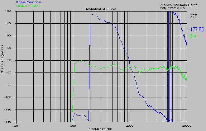

I'll agree that both the Behringer DCX and the Truth series offer a lot of value for the money but I think you need to go into the DCX as AES/EBU to hear it at it's best. Incidently the new Behringer sub (2092) looks to be a great deal.
Your boxes sound interesting, I'd be interested to know how the phase response between the boxes looks.
You mean phase like this?
Measurement outdoors. Indoors I set a 2nd order Bessel HP filter at 120Hz and some 4th order filter (phase inverted) on the sub around 90hz for an effective in-room cross at 110Hz.
My system sounds just fine using a SB Live (kX drivers) output (resampled to 48kHz in foobar 2k) through a Yamaha MG10/2 mixer and analog input into the DCX.

Behringer Truth 2031P (or some such, anyways the 8"/1"). The peak right up top is a diffraction effect of the waveguide, which off axis seems to be effective except for a peak at 15kHz off axis.
