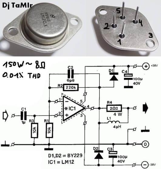

if u want more power :
STK4050V - 200W
LM12 (in Bridged) - 300W - very very simple!!!! to build
PA03A - 1000W the site - http://radvs.boom.ru/ims-unch4.html
PA05A - 300W
lm 12 :
