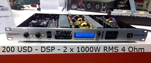

PA AMP 4 x IRS 2092 Full bridged 2 x 1000W RMS 4 OHM - 200 USD - real power or Fake ?
Dear Friends
I visit yesterday Frankfurt Fair Germany Prolight and Sound 2016
It looks IRS 2092 Class D Mosfet Driver coming popular for PA Amplifier Manufacturer. With IRS 2092 many companies offer big power PA amplifier with low cost.
Different PA Amplifier Manufacturer offer 1000 W RMS 4 OHM with fullbridge IRS 2092 Class D Mosfet Driver Design.
Ist 1000W RMS possibile ?
can IRS 2092 working stable in PA Amplifier now ?
Attachment picture 1000W RMS x 2 with DSP - Sales price 200 USD FOB China
Im not sure this amp working stable and scare to buy this product
Any ideas ?

By design IRS2092 only supports pre-filter feedback, which limits "high quality audio" use of these amplifiers to sub-bass and mid-bass duties. Used full range they could be regarded as "mid quality audio" because HF response is load dependent and shows higher THD and higher output impedance than usual class AB schemes. Difficult to get HF right for anybody requiring good trebble for pleasure.
Another factor is the origin: China. They just use the lowest cost passive parts and simplest design that does not fail during their tests, aggressive circuit simplification. When circuits designed that way fail, even just due to aging, there is usually a big chain reaction where many parts fail, tracks fuse, SMD parts vaporize and sometimes holes are burned in PCB. A hell to repair. No real sense of long-lasting fair-failing industrial engineering, this is Occidental or Japanese thinking, more parts and consideration required.
By design there is nothing in parts like IR2110, IRS2092 or IRS20957 preventing them to achieve full ratings. Only good design and manufacturing is required. My personal mark with 2x IR2110 and 8x TO-220 IRFB4227 is 6000W/2r (implemented in a product selling for a few years now). With 2x IRS20957 and 4x TO-220 IRFB4615 I recently achieved 1600W/5.6r in first PCB revision without any significant problem related to power output.
Also, there is nothing in parts like these preventing an amplifier to achieve high audio integrity within the expected frequency range (IRS2092: good on LF/MF only). It all depends on class D modulator used, optimization of switching, layout and power supply. Companies that have not yet developed and/or optimized their own modulator schemes resort to parts like IRS2092 which has built-in modulator (nearly all unknowns already solved, maximum simplicity) or copy circuits without proper understanding, which can have unpredictable results.
By the looks this amplifier seems like a collection of datasheet circuits. IRS2092 datasheet circuit. LLC resonant SMPS (non-PFC) direct from datasheet circuit. Some big company audio DSP implementation direct from application note, and with most software already provided by manufacturer. Safe design approach with little research, little risk and no innovation or exceptional features at all.
In comparison, during that time others have been developing things like class D modulators with HF responses flat within +/-0.1dB at any load, intelligent limiters with soft clipping that allow extra loudness without unpleasant distortion (like classic amplifiers), voice coil temperature monitoring and limiting without extra wires to get theoretical maximum dB out of speakers, or single stage PFC power supplies that do more power than the LLC using less parts and space (featuring induction cooking IGBT haha). All this requires a lot of research and effort to develop new or custom schemes, so cannot be offered at the same price.
It must be understood that when a product like the amplifier shown in the pictures is bought, nearly no research or innovation is being funded, more likely some slavery is being funded. It can be useful to do lo-fi parties from time to time, but it's not state-of-the-art, and it's not likely to contribute to future technological innovation.

I had problems getting 2092 to drive IRFB4227.
Unless my 10R gate resistor was too big ?
I used both TC4420 and pnp/npn gate drivers in different amps and they worked fine.
The 2092 is a bit fiddly to get working. It is fussy about decoupling and pcb layout.
I even had to decouple the gate drivers to get it working.
Then there is power down issues with huge thumps and siren type noises through speakers.
I had to design a PIC based reset circuit to monitor VCC, if it fell below 12 volts I applied a reset to the 2092. IR recommend a reset circuit if power supply capacitance is high as the slow discharge on power down confuses the 2092.
