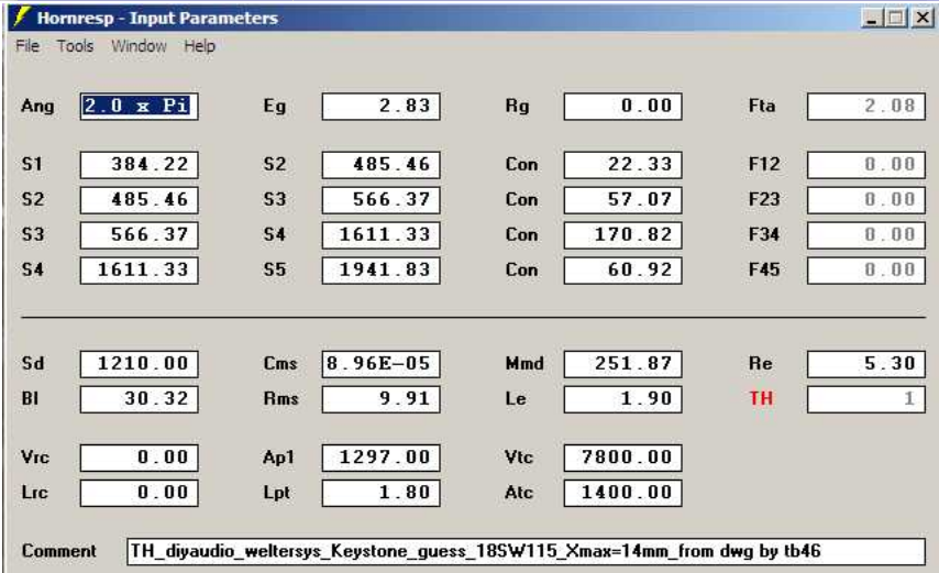

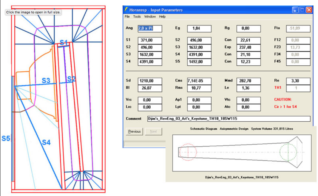

Your cabinet looks to be about the same volume as my Keystone design, curious as to how one of those drivers in a TH would compare to the pair in the BR.
Although the Keystone opening makes the response a bit different than Hornresp predictions, the inputs below would give a reasonably close approximation for comparison.

Hi Art,
I did try a few THs and unfortunately these drivers don't quite have the BL for it - 25.4 for the Faital, where the B&C 18SW115 comes in at 30.3.
I suppose the compromise in trying to get so much Xmax is that the magnetic field is stretched a little thinner.
The Keystone results vary according to which Hornresp inputs I use: one gives a 33Hz tuning frequency and a large bump in output around 40Hz, while the other is tuned in the high-30s, with a smaller bump around 45Hz and a steep rolloff below that.
Both models keep up with the 2x18" ported box over a narrow frequency range, and lose out elsewhere. A pair of THs beat the 2x18" over the range (though it's within a dB around 60Hz), but with a lumpier response, less HF bandwidth, more boxes and more wood.
