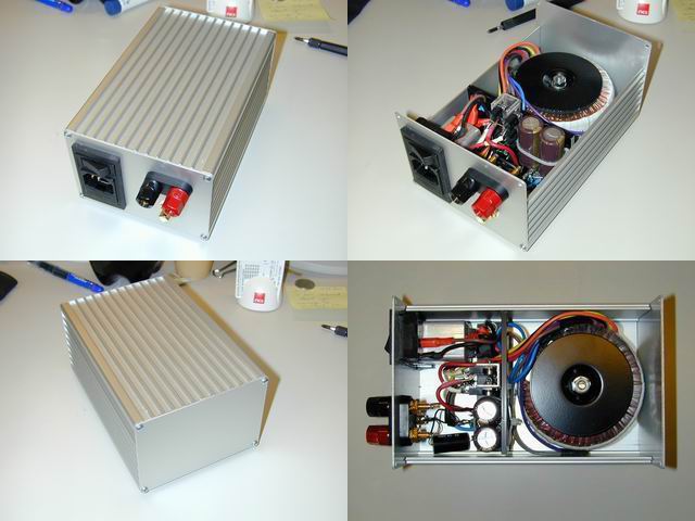

Well, finally I've finished my P3A mono blocks. They are only rated 30w into an 8 ohms load, but this amount of power suits the cabinet as the top of it is used as heat sink. The xformer used is a 120VA 18-0-18. The output devices are MJL21193/94 - fairly overrated, one must add. The electrolytics are some cheap Rubycon 4700uF from Farnell. I chose them because of their small size.
There are two minor issues. A little bit of hum is present, but I have to put my ear all the up the midbass driver in order to hear it. I suspect that this is the result of placing the transformer this close to the amp circuitry or unshielded input wires. The input wires will be changed soon, but the hum is no problem.
The other issue is under dimensioned input caps. I used some Icel 1.5uF 1% polyprolene. They are definetly too small. I've ordered some 10uF polypropylenes from Elfa, but I'm sure if the space is too tight. I guess I'll find out.
Anyway, here's the pictures.

It looks nice... but it doesn't sound nice (you say)... If an amp doesn't soend nice, the project is not yet finished i think.

I got the SCR capacitors from Elfa yesterday and installed the 10uF right away. Changing these certainly cleared up the bass issue. The space is _very_ tight, but they fit.

That is certainly some nice clones, you've got there, UrSv. Is heat buildup a serious issue in your amps - at what rail voltage are you running the amps?
JasonL, the cases are - afaik - only available from Conrad in germany (www.conrad.com). The cases are not very expensive, but transport may very well change that. Isn't possible to get those cases or some like them in USA/Canada, anyone?

They don't even get mildly warm. Chip is attached to the Al angle which is attached to the bottom of the case. Rails are 36 VDC.
Cases are available from Conrad in all Conrad countries almost and I got my cases in Switzerland. The extrusions are made by Isel (http://www.isel.de/) and any dealer that sells Isel boxes could potentially have them. Isel makes nice extrusions and many could be used for cases.
