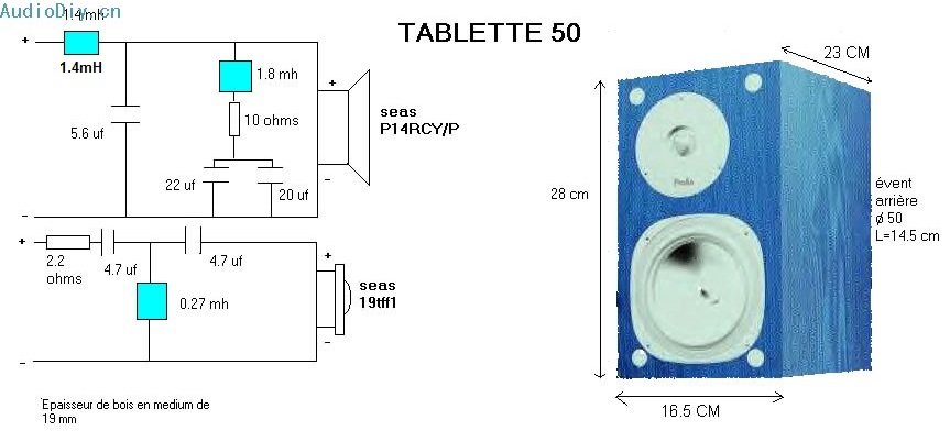

P14RCY 1 pair left unused what can I make them benefit (2-way?)
not sure will be shout? if doing this
