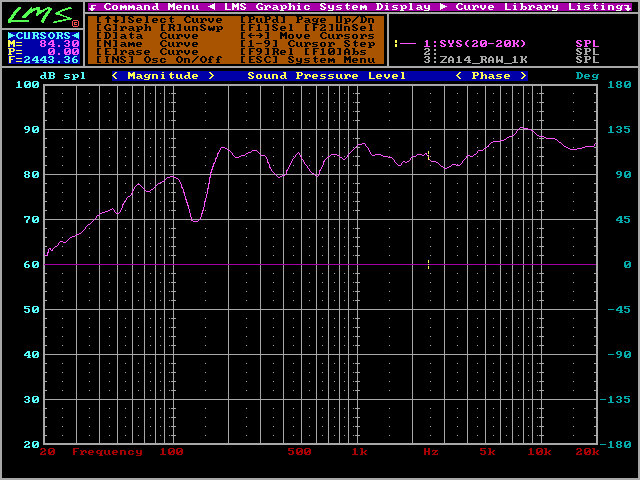

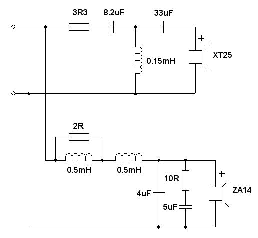

The BSC is 0.5mH // 2R. This is quite light, about 2dB. Just enough, as can be seen in the picture on the right. This plot is Ungated, normal SPL in-room sweep at 1W1M, smoothed 1/3 oct. From 100Hz to 1K, room boundary effects are clearly discernible.

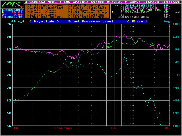

The middle picture is a Gated Response of the crossover at 3K5. If the crossover is not right, this is where it'll show up.

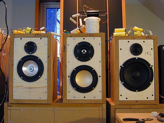

I don't have a full picture of your speaker, so its quite difficult to offer anything constructive. Are your TB W8-740s boxed?

I finally invested in an iphone based measurement suite called Audio tools by StudioSixDigital.
It was cheaper than separate preamps RTA's Mics etc plus I did not have to wait...😱
Anyway after measuring the P13 I found out why i didnt like it.... see graphs later.
Also this is a first pass, so measurements may be off a little but seems like a start.
First Pic ZA14 farfield. (SPL not to scale)
Second Pic ZA14 close Miked
Third Pic TB W5-1685
4th Pic Vifa P13 (note the screechy peak at 1700Hz)
Last Pic, the main system (4 W8-740's and TB w4-1720 and three XT25's), I swept the speaker top to bottom. Since the woofer responses do not add, assume that the 70Hz to 250Hz region is understanded by about 9db...
Please look at the yellow trace only.
as mentioned earlier, the TB-W4 seems to be a good fit and the response shows the system sounds better. There are peaks but nothing horrible...
