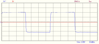

I found no problems with my bifilair interstage <1MHz loaded or unloaded.
Your IT is quite good but it does have a resonance as well in the 400-500 KHz range. You FR picture clearly shows a "double slope" in the high frequency range. This is not completely damped with the source impedance you used.

If the FR were optimally (i.e. Q= 0.71) or critically (i.e. Q < 0.7 ) damped then F3 (i.e. -3 dB point) would be quite less than 895 KHz.
In general, I would not be worried about some ringing above 40 KHz in zero fb amps. The only important thing is that ringing needs to be completely damped after few cycles.

Well a resonance at 200KHz and -3dB at 400kHz and again a resonace at 800kHz.
A graphic would be much better to see if it is a big problem or not but because of the lack of information i don't know. Not even a square wave.
Btw, low copper losses is nice but they don't give any data about signal level at 20Hz so both companies have a hugh lack of information.

As i sad before: i found no problems.
Otherwise the sq would show.

Depends on the bandwidth of the square wave..Otherwise the sq would show.
You are right.
But i guess 20MHz isn't needed for audio
