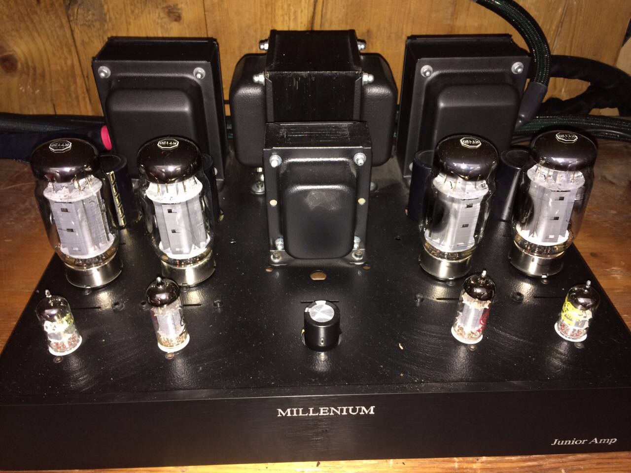

Now the amp with KT120 is driving with a great satisfaction ( of my friend) a pair of B&W 800 in a medium size room.
I can send the photo of installation, if you don't believe.

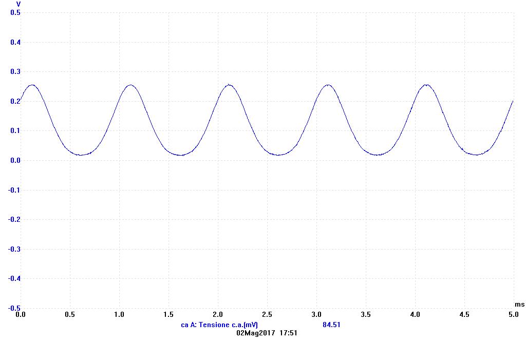

I forgot to send two diagram to shoe the class A operation of this amp with KT120.
This tube can allow to run with a high current
The signal was taken from a 1 ohm resistor that I use as bias monitor for each tube
in fig. 10 there is a signal with 50 mA , about 10 watt at the output on 8 ohm
in fig. 11 with 90 mA, about 30 watt at 8 ohm, in this case each 120 is dissipating around 41 watt; on post 1 fig. 6 is possible to see the difference on THD vs Freq with this bias current
Walter
