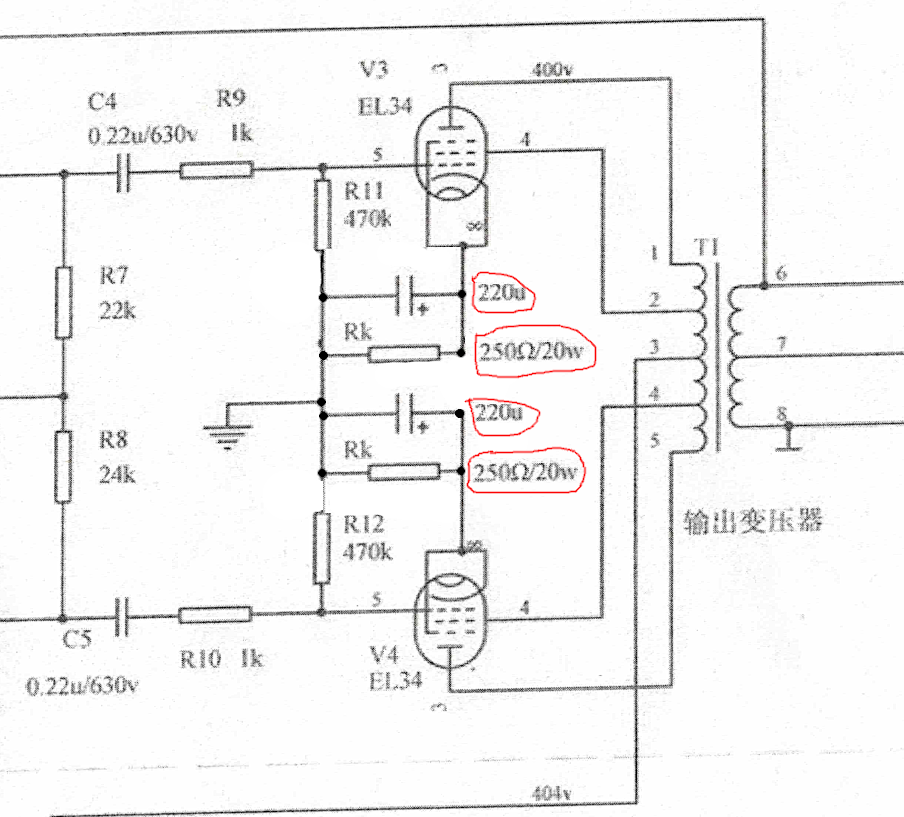

I am doing some tinkering to improve an EL34 P-P amp I bought many years ago. One of the things I want to change is to have each tube use its own cathode bias resistor and bypass cap. What I don't know is whether or not I need to change the values of these components.

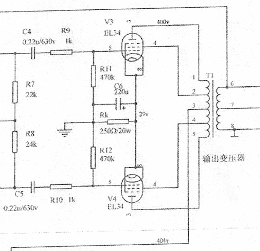

As you can see in the "before" schematic, C6 is 220uF and Rk is 250ohm/20W.
Should I just reconfigure it as shown in the "after" schematic, or should the component values change? Something tells me the caps can stay at 220uF but I am not sure about the resistors. If anything it seems like 2 10W parts will do the job but does the value also need to change?

Thanks for the suggestion zintolo. I actually found that schematic in my travels (among others) but the topology and component values are so different than the existing amp that I find it quite daunting, to be honest.
I should note that the main reason that I would like to do this is for tube longevity. I have read that unmatched tubes can result in runaway with the shared cathode resistor configuration if one tube starts pulling all the current for itself. I have had two premature tube failures in this amplifier and suspect that this part of the topology is the problem.

And if I wanted to run the tubes a little cooler, 560 ohms would do it?
What's the plate dissipation of each tube in it's current configuration?
jeff
21.46 watts each.
That's basically what I calculated based on the schematic, however I have never actually measured voltages on this amp.
Now that I understand things a bit more (after building a Tubelab SSE) and I know what to measure and how to measure it, I will do so. If the voltages and calculated currents all jibe with what is expected, then great. I suspect there might be some discrepancy.
The intention behind dropping the current / dissipation is to lighten the load on the power tansformer, which has historically run extremely hot - so much so that I installed a heat sink on the back of it and ran an 80mm fan on it.
So I probably going to want to go with 620 or 680 ohm. I'll know more when I take the measurements and do some number crunching.

Alright I've measured the amp.
B+ = 426v
k = 32v
With a 250 ohm common resistor, the current works out to .128A (128mA).
426v - 32v = 394v * 128mA = 50.432 watts
So 25.216 watts per tube.
A 310 ohm resistor in place of the 250 ohm would result in 103mA of current which works out to ~40.6 watts / 2 = 20.3 watts per tube.
So if I go with one 620 ohm Rk for each tube, that gets me the 310 ohms and 20.3 watts per tube. I'll also be drawing a total of 50mA less current on the PT high voltage tap (128mA - 103mA = 25mA * 2channels = 50mA) for a total power drop of ~20 watts through the PT.
Have I done this math correctly?

Math is correct but the K voltage will rise in conjunction with the increase in resistor ohm value.So you have to remeasure the K voltage again after you change the resistor and recalculate.Alright I've measured the amp.

Also your B+ might rise due to the lessening of current through the resistance inherent to the power supply (transformer wiring impedance ).

I assume that the insanely large cathode bypass capacitors from the vacuum state schematic are not needed. That makes it pretty easy to try. Assuming the 620R cathode resistors, a single 82R from the junction of the bypass caps to ground should be close enough.
