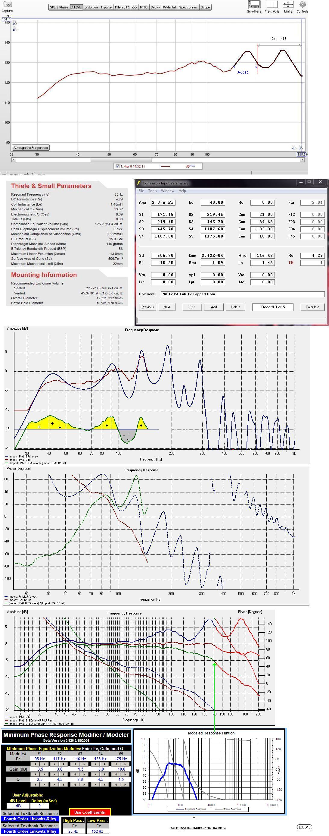

When i said back to the drawin board i mean most of the FlH id been working up in horn resp hit 12mm xmax with the tbw100 at about 90v. 110v into 8 ohm reflects the 1500w aes rating, and if im good to sim to 20mm i should jave nonproblem keeping it in check even with 110 volts input

Xmax plus 8mm is a bad number to shoot for IMO. I'd shoot for right around rated Xmax, maybe a mm or two higher without worries.
At Xmax plus 8mm distortion must be very high.

On a driver with a conservatively rated xmax, I'd say half way between xmax and xmech is fine in a low tuned bass reflex design. A small amount of extra sub distortion will not be noticeable IMHO, masked by the music. It will only be in two short frequency bands where possible excursion is that high, and since we are talking about a lower tuning, there will be less stress than if this excursion occurred at higher frequencies. In the odd case of a sustained bass note, you're more likely to pick up on massive room rattling.

Interesting. 50v on 2.6 ohms (3x 8ohm nominal) figures to 940w (x2), so I would have to think that the load in question was well below that? 3x 4ohm subs in parallel? Figure the amp should be around 80% efficient, and supplied power should be at least 1/3rd of nominal output? Maybe if you're sustained hitting notes that are right at an impedance minimum? Horn subs, if that's what you have, have a more challenging impedance plot and should be harder to drive.
My comments about excursion don't apply to horns, only bass reflex where loads on the driver are not as severe.
Its a popular 3015lf FLH. Suppossedly a 10 ohm nominal boxIts heavy bass music , almost pure sines in the 35-60range.
