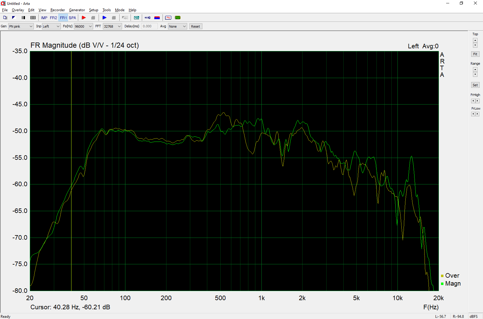

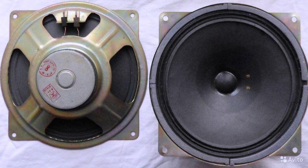

This kind of drivers can be improved by surround treatment. Applying some damping compound - polyisobutylene, butyl rubber or vinyl acetate - provides cone termination, which is basically non-existent in one-piece uncoated paper cones, and dampens surround resonance.
An example of improvement brought by one side PIB coating is attached. Fig. 2 is for reference; it is the same model, but not the exact driver that was coated.

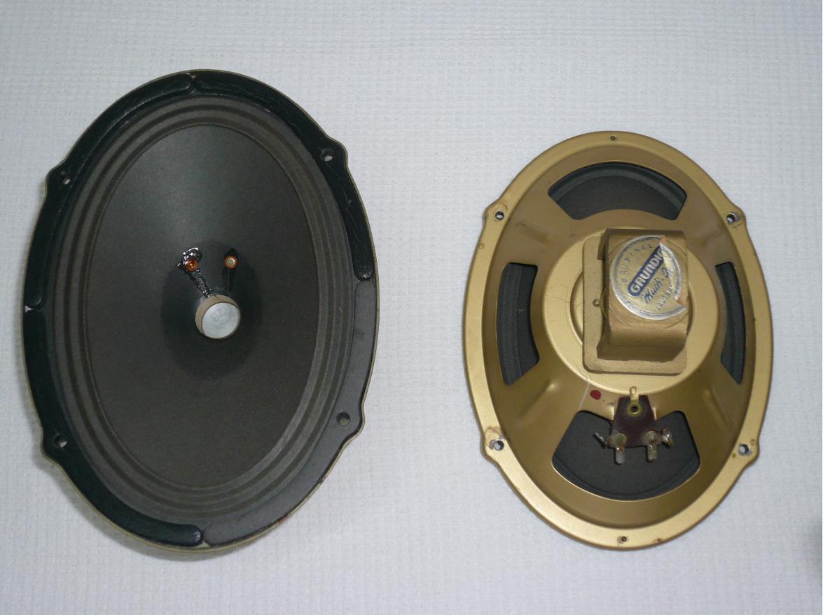

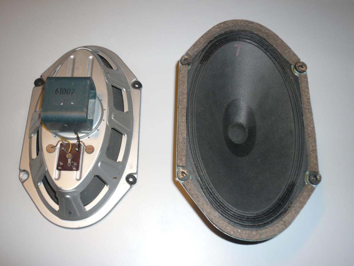

Thanks! Keeping XO points low wrt the drivers' limits also helped a lot for directivity. As for the cone treatment, I fully agree. Not that I feel confident enough to do modifications like that but I've seen it in drivers of this kind/era some of them coming with surround treatment. In particular the Tesla and the JBL have this done by the factory resulting to great performance. The Isophon is very special for that! It has both surround and cone treatment with some material. Not all drivers from this brand had this. Mine have a "T" mark on the cone which from what I gather means treated for tropical weather. It sure works for audio! The only driver that is completely untreated is the small Grundig. I don't know if this was deliberately or not but it is the only driver of this size I found to cover the range I needed. Everything else typically wouldn't reach low enough. So, I don't feel like modifying this.
