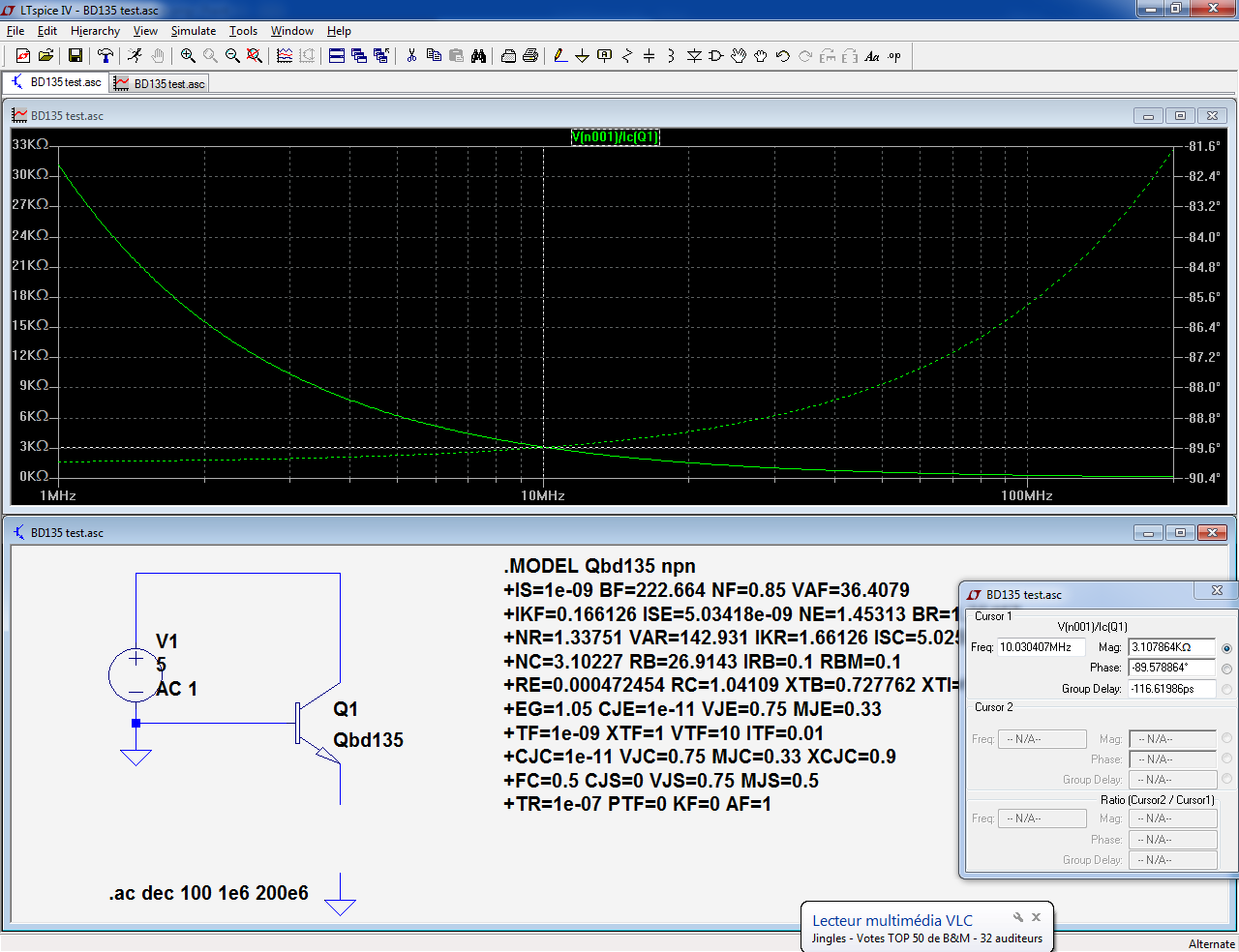

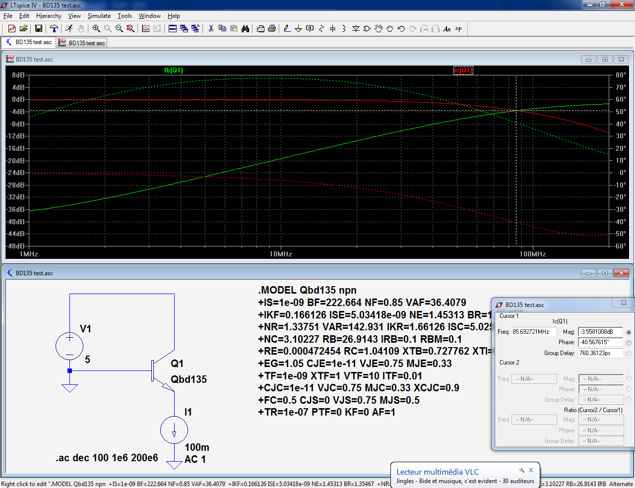

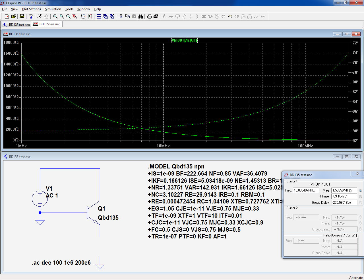

I too had some concerns about different manufacturer's BD139's and BD140's. At the time I wanted to check that they weren't epitaxial base transistors, so I set up a simple Class A bias circuit (at 100mA if I recall correctly) and fed in a signal at 1MHz. For both ST and ON Semi (then Motorola) I measured a gain of at least the same as the DC values, making the Ft's in the region of 100MHz. That was enough to check they weren't 4-10MHz ish types.
And yes,the datasheet Ccb is usually quoted at 10V, which makes the numbers look smaller.
Thanks for sharing this. It is good for a rough check and can be done with small generator and 'scope on the "kitchen table".

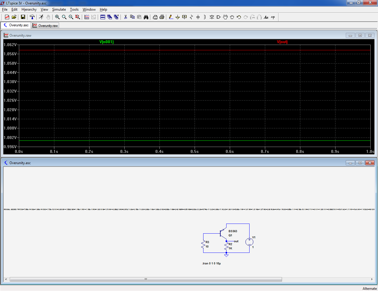

The BSS63 is far from being the only device exhibiting "The LV's Anomaly": in fact quite a number are affected, to a varying extent.
Practically all of these models originate from Siemens: ~half of their models show it: BCP69B BCP51 BC638 BC369 2N2907 BCX69 BFP23 MPSA92, etc.
There is however one exception, and it is a particularly big one:
