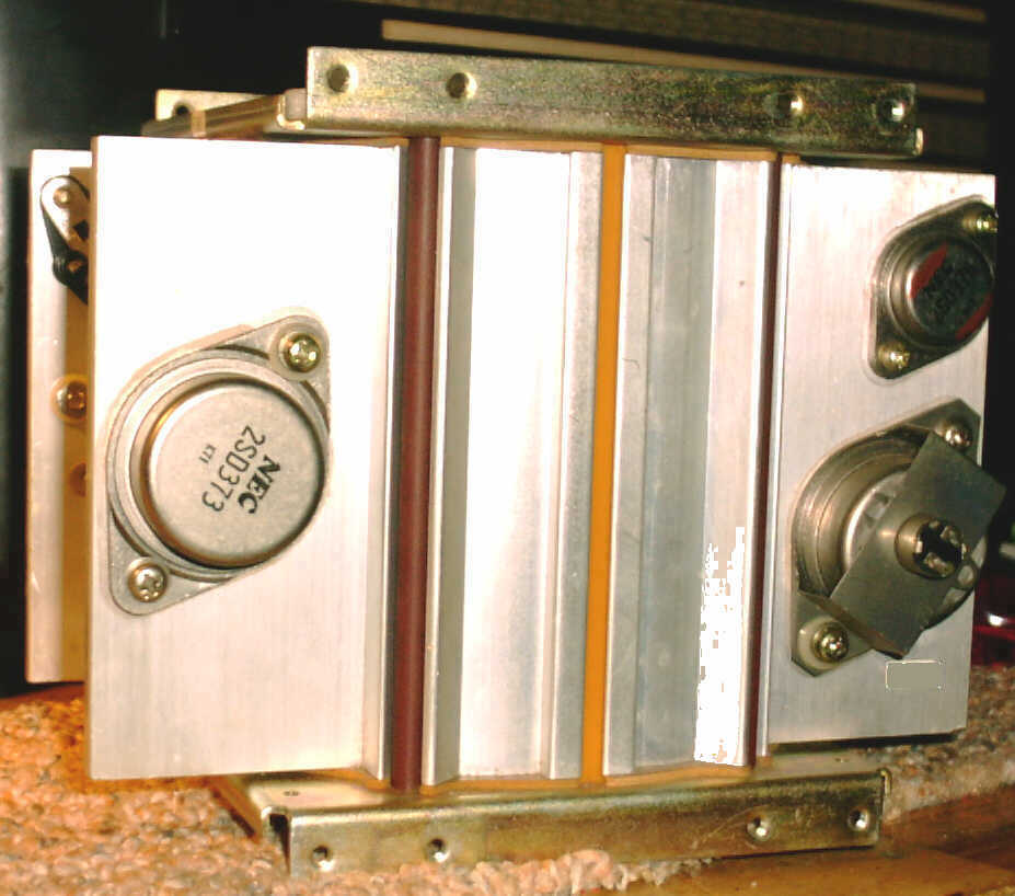

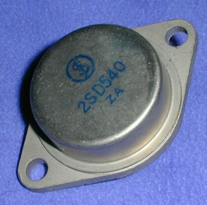

I have found this types in oversized TO3 outline:
2SD699 (Darl), 2SC2442-2444-2445 (SPEC-Outline)
2SC2442 Fujitsu - photo about
TR. 2SC2442 - - BRAND : FUJI

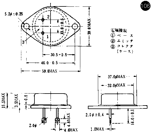

X87 Outline hole distance = 46mm (normal TO-3 = 30 mm)

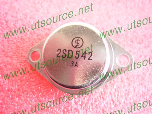

2SD372-373-373A-374-363-363A-364
2SD540-541-542-543 694 (Darl) 642 (Foto) 643 (Darl)-644 (Darl.)

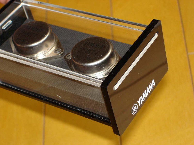

2SC2220/2SC2204:
2SC2220 datasheet and Application Note, Data Sheet, Circuit, PDF, Pinout | Datasheet Archive
2SK77 Yamaha, other cover top:
ͼƬ¹©Ó¦IC¼¯³Éµç·¶þÈý¼«¹Ü2SK77Í£²úÎÞ»õ IC¼¯³Éµç·¶þÈý¼«¹ÜͼƬ °¢Àï°Í°Í
2SD642 (incl. data) 2SD373 (NEC), 2SK77 (Yamaha)
and Delco DTS720 vs. normal TO-3

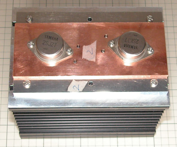

Oversized TO-3 TO3 like Yamaha 2SK77 and NEC 2D363 - Overview-II
Unfortunately the most of this BjT silicon types are developed for switching applications. But I think, some of this types are also for linear audio application. To determine this exactly the original data sheets are necessary.
Except Delco-GM all oversized TO-3's are made in Japan.

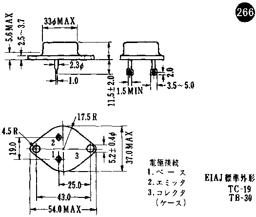

Two different oversized TO-3's you will find so as one normal TO-3 sketch drawing for compare.

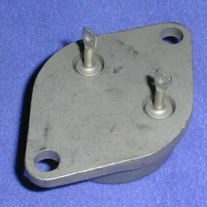

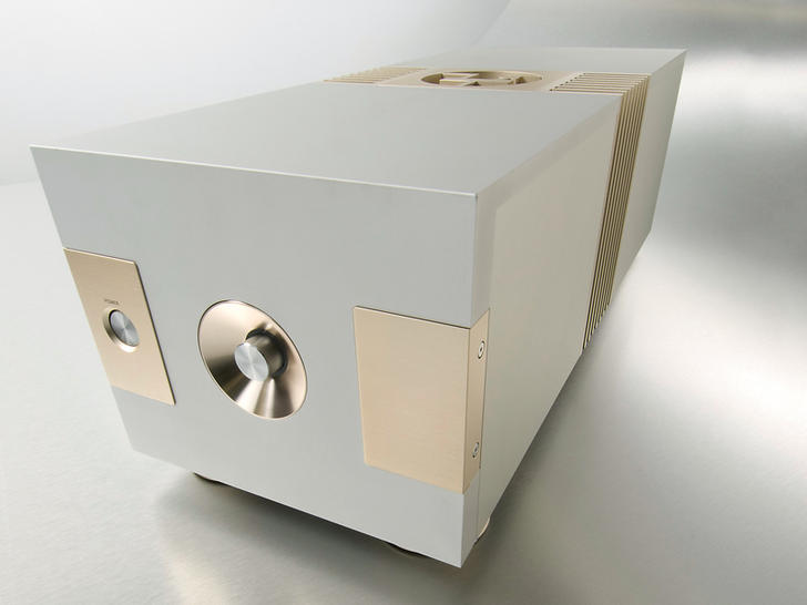

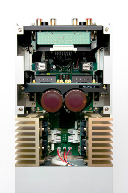

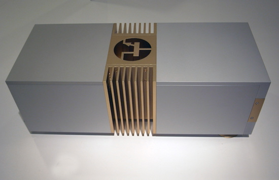

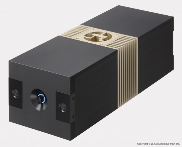

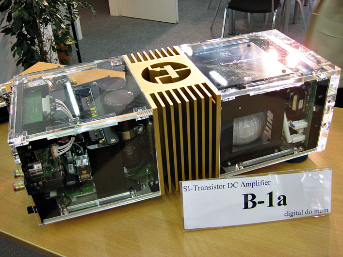

2SK177B: Successor of Yamaha's 2SK77 - unfortunately other Outline
Also an amplifier equipped with 2SK77B is on the marked.
Unfortunately the outline is complete different.
Interesting. Unfortunately I don't find more exact information so as datasheet and images about google. Do you have a genuine Yamaha databook from those days?You can also add the 2SJ27 to the list, it's the complementary to the 2SK77, also made by Yamaha, and never used in a commercial product.
If not, perhaps you know the exactly title of such a book.
