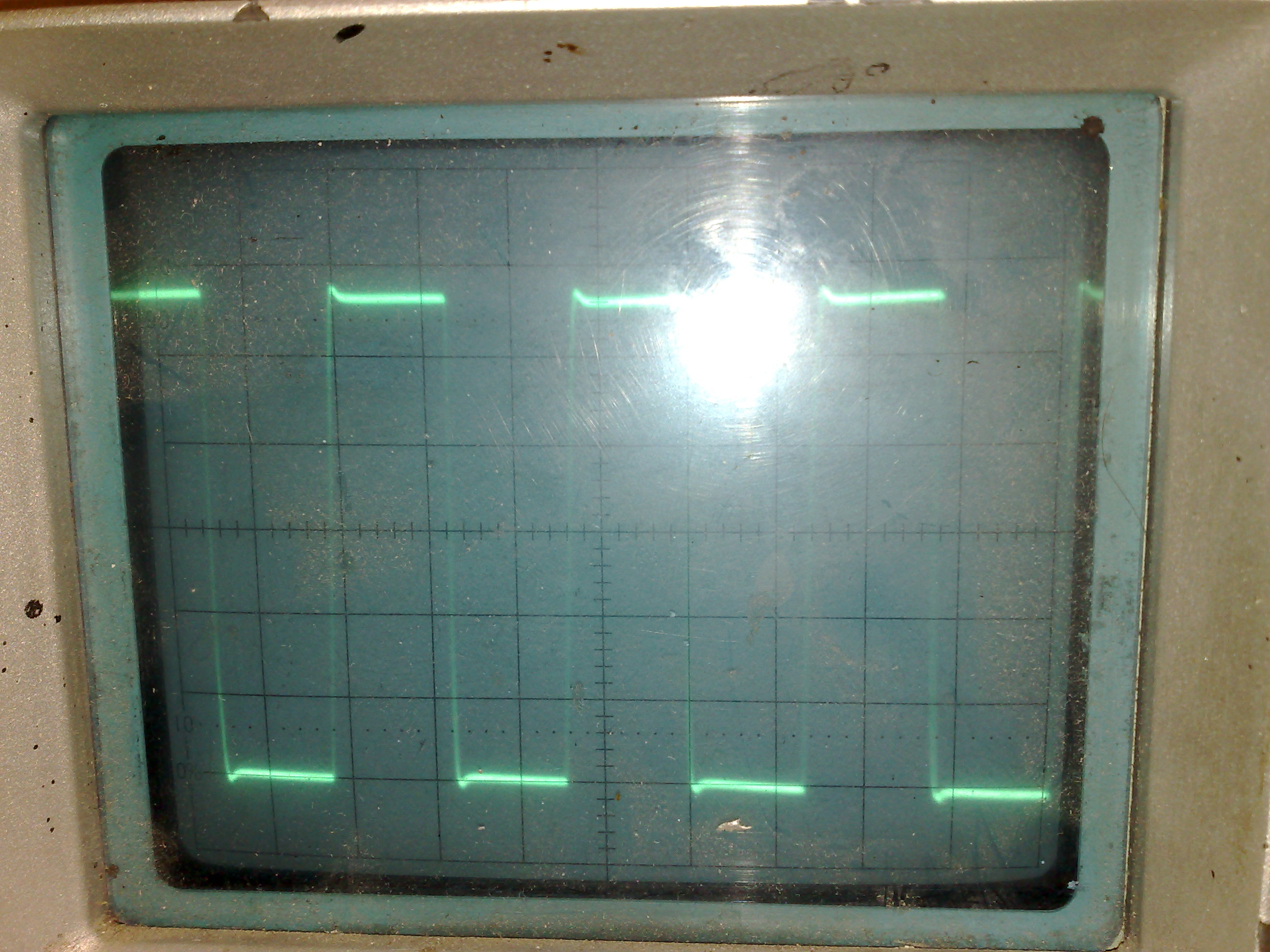

I have also ringing and overshoot, but I see that as wel in the grounding as pulses 400mv pp if I go 20 volts output in 8 ohms wirewound resistor, what did I wrong, I have a supplys earths as a star to the center of the biggest supply, I use 2x 55 volts, 2x 120 volts (tube driver) and one 300 volts (tube voltage preamp).
photo 2 is a square wave trough 100k pot to srpp 6h8c it I set it full open the output of the signal generator distorts like on picture there is feedback trough earth I think, normally a tube is high input impedance and miller, the signal generator has a output amp of 5 watts so it is capable to drive.
how to earth this properly, I did see that if I play with a earth wire things change, so there is a earth problem, this amp is in testfase with a poor mans pcb as start so things can give problems.
there is here next door a powerfull wifi antenna who bundels rf power to 15 km away possible this thing gives problems because I see so now and then pulsing signal on output, even on the supplys.
But the sound, it is open and sweet I do like it.
thanks.

If it's not just due to the inductance of the wirewound load, then read on.
Is there someplace in your circuit where an active device could be attempting to suddenly draw a fast-changing current from the supply rail? The inductances of the supply and ground rails would cause voltage spikes, on both, if fast edges of current were made to travel through the inductances, according to V = L di/dt (the basic ideal inductor equation). Even if the inductance L is very small, the time rate of change of the current (di/dt) might be very large, resulting in significant-amplitude voltage spikes that would correspond with the edges of pulses.
If so, a larger decoupling capacitor is needed, between that device supply rail point (right at the device) and wherever the ground is for where that current goes (possibly the closest load-ground point, but wherever works best). The decoupling capacitor can be thought of as a small point-of-load power supply and is needed to supply the current for sudden or transient demands, such as the leading edge of a pulse, so that a fast-changing or transient current doesn't have to attempt to travel through the inductance of the supply and ground rail conductors. (Also, make sure that the capacitor is not connected so that it shares any length of ground return conductor with any small-signal ground returns, as I think you already know.)

Hi Tom.
Thanks, for your help, but in time I have make it good, problem was the supply, bad resistors in mosfet driver supply board, I have now regulated with mosfets, now it is oke, amps can behave strange sometimes...
now I have a very good sounding amp who has only P followers, except the fets, sound is very good, I have now H frames driven with this amp.
I have still a very little overshoot but I don,t think it is a problem, I can switch on and of the feedback.

scope picture is 20 Khz square.
