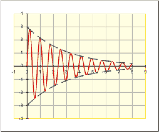

Ringing is an oscilation slowing decaying.

Ringing, with reference to the above, is a series of oscillations that follow the initial overshoot. This is usually do to the resonant effects of a coil's inductance.

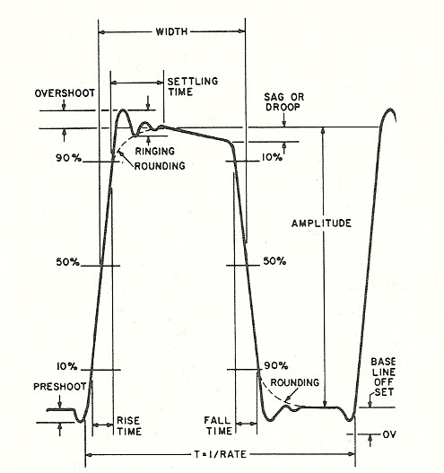

The picture I posted was to depict some common pulse terminology. I scanned it from Tremaine's Audio Cyclopedia. But any good text on pulse technogoly would have it.

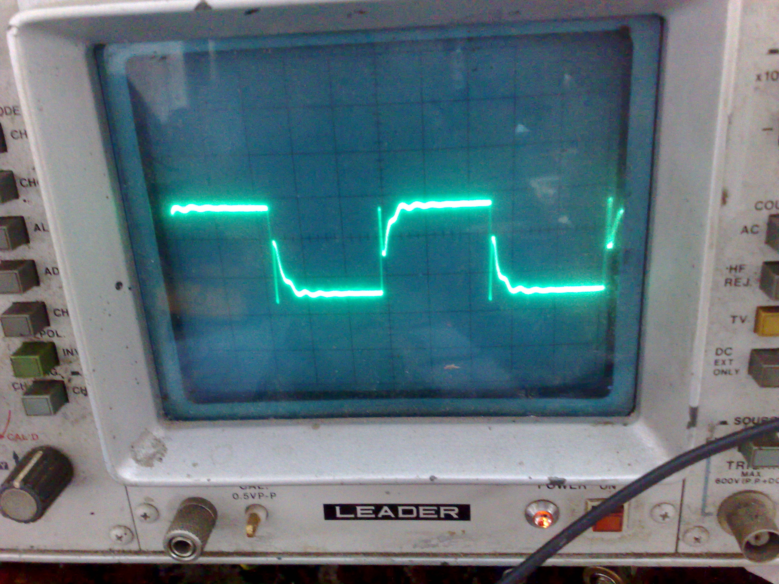

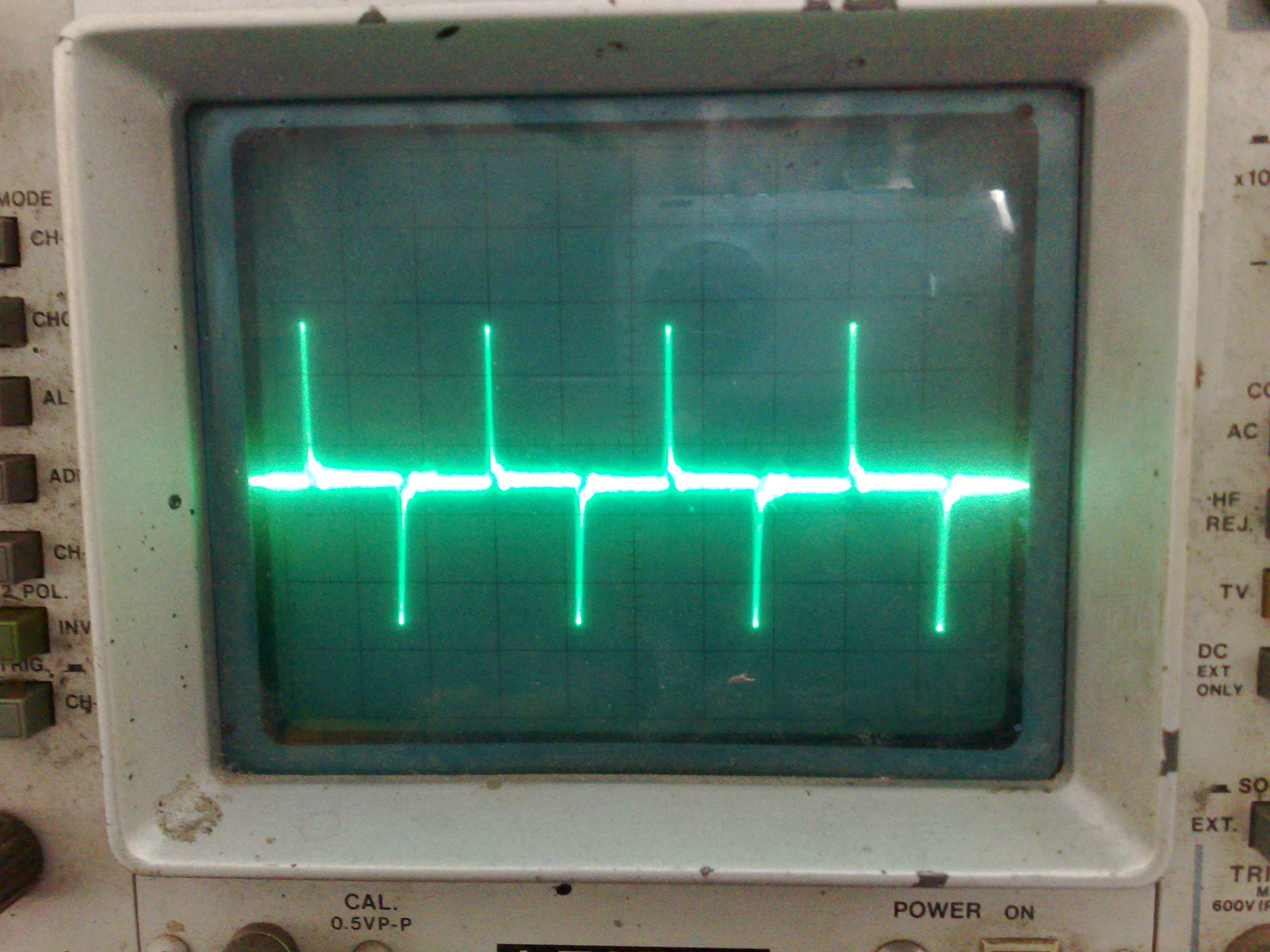

I have also ringing and overshoot, but I see that as wel in the grounding as pulses 400mv pp if I go 20 volts output in 8 ohms wirewound resistor, what did I wrong, I have a supplys earths as a star to the center of the biggest supply, I use 2x 55 volts, 2x 120 volts (tube driver) and one 300 volts (tube voltage preamp).
photo 2 is a square wave trough 100k pot to srpp 6h8c it I set it full open the output of the signal generator distorts like on picture there is feedback trough earth I think, normally a tube is high input impedance and miller, the signal generator has a output amp of 5 watts so it is capable to drive.
how to earth this properly, I did see that if I play with a earth wire things change, so there is a earth problem, this amp is in testfase with a poor mans pcb as start so things can give problems.
there is here next door a powerfull wifi antenna who bundels rf power to 15 km away possible this thing gives problems because I see so now and then pulsing signal on output, even on the supplys.
