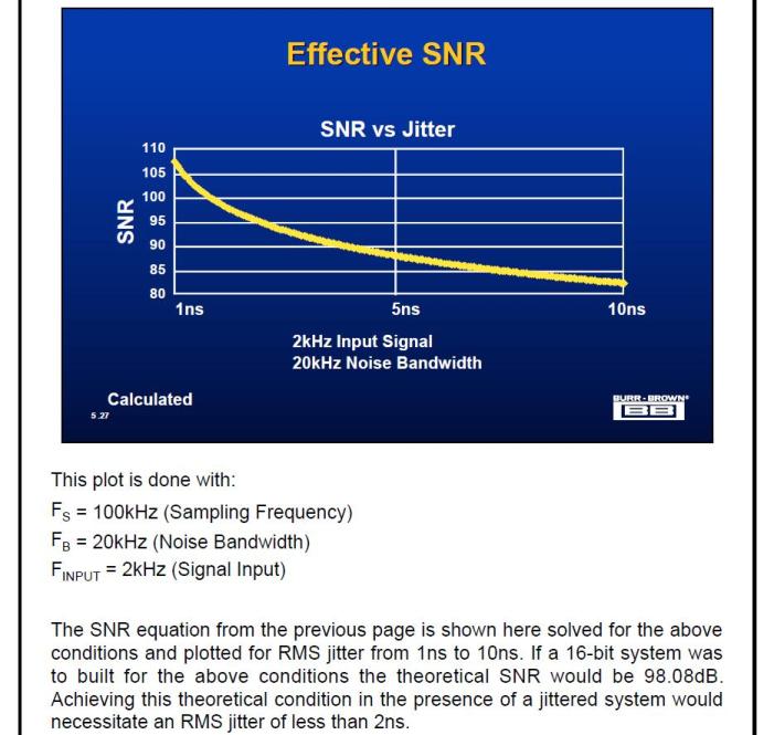

Where did you get those 20ps from??? From the formula posted by ecdesigns results 170ps for 44.1kHz. From the BB seminary results 2ns.

How come in the BB design seminary they are talking of 2000ps as the necessary limit for 16bit (NOS)? The link to the doc was posted above.
It is a 10x difference.
