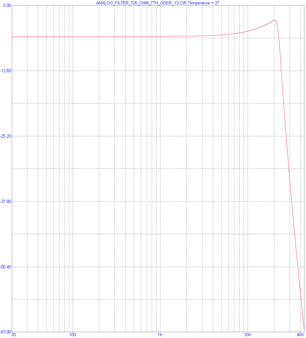

Vadim, I totally agree with you, non os needs a proper reconstruction filter.
This is what I use: 60dB/oct. & includes anti sin(x)/x, not trivial but doable...
Actually, any frequency component above Fs/2 is indistinguishable from a lower-frequency component, called an alias, associated with one of the copies. So anything over 22.05 kHz...
That's why a NOS DAC cannot function proper with most of the DIY filters that are shown on this site (more like no filters at all). Distortion level is extremely high with no abrupt filters.
Why those aren't so good either? Abrupt filters have the habit to make weird phase shifts in the signal. Not good for quality music reproduction.
Going with a simpler filter that has a decent attenuation of image and slow roll-off (low distortion) will be cutting the high-end of the audio band.
So the only way that you can have the cake (maximum bandwidth) and eat it (low distortion) is to use an over-sampling digital signal to relax the requirements for the analog low-pass filter.
LE: Even a filter like the one above that looks good (and hard to make), has only a -30dB attenuation at 30kHz - well into the image field. Thats' not even close of the -96dB that are easily obtainable with a 8x OS and simpler filters.

SoNic_real_one said:Even a filter like the one above that looks good (and hard to make), has only a -30dB attenuation at 30kHz - well into the image field.
IMHO the images are best removed by removing the sampling frequency and not by removing the images.
SoNic_real_one said:Thats' not even close of the -96dB that are easily obtainable with a 8x OS and simpler filters.
But at what cost...
What good does removing the FS only? The images will be there and will be "mirrored" onto the real signal (high end will be translated into the low end and low into the high).
Cost for OS? Well... IMHO I think it is minimal compared with what happens with the NOS case. Actually that's the opinion of most of the audio industry.

Bernhard,
Judging from the overshoot of the filter response you posted it is an Elliptic or possibly Inverse Chebushev, - well, whatever the case may be, - the phase non-linearity makes this filter completely inappropriate for the application. But then again, - this is what you have to do in order to pay for the absents of over sampling. There is no free lunch here. As it was noted in earlier posts, that even a 7th order filter is not sufficient here.
Another thing is that you are under impression that the sampling frequency can be somehow removed.
This is not possible. What is possible is to diminish the effects of the sampling to a degree that is commeasurable with the precision of the data, - 16 bits. In our case it is a 16-bit S/N that serves as our target for the noise suppression. Doing better then that while admirable does nothing to your signal integrity.
In any event, there is only one solution possible here and that is setting an over sampling requirements to at least 8x or better 16x. With 8x over sampling and Bessel or Thomson type low-pass filter you can get away with approximately 6 order. No phase nonlinearities here and you can use the best op-amps available, like perhaps AD797, which is the only one I know that does sport 16-bit capability.
If you do the power supply regulation right, you may just sneak under measurable 16-bit S/N. I know it is possible as I have done it in the past. Shooting for better then 16-bits is extremely difficult and even expensive to measure properly. Better yet you can do a passive filter with shielded inductor and buffer it with a discrete extremely low-noise buffer. Not a simple task, but definitely doable.
