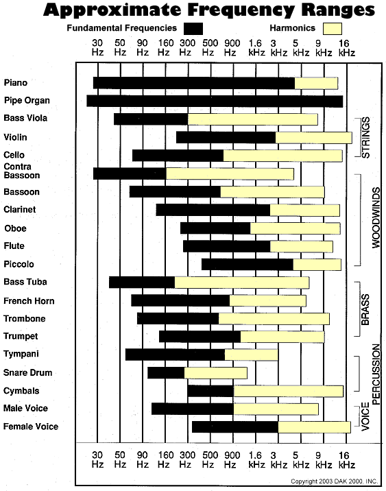

Well, as you can see from the chart below, taken from this webpage, the contrabass is one of the few instruments capable of reaching down to your tuning frequency. The piano and pipe organ are the others. I don't how much deep pipe organ music you listen to-if you listen to Basie and Sinatra I suspect not very much-and the piano is not usually played down there, even if it is capable of going that low.
A speaker is considered acoustically coupled to a corner if the frequency being reproduced has a wavelength ten times or greater than the distance to the corner. You are 39 inches, (1 meter) from the corner. 31 Hz has a wavelength of 435 inches, so the contrabass' low output is definitely coupled to that corner.
It seems highly unlikely that it is just coincidence that you are having problems with the only instrument likely to be played down to the where your Fb is, especially since the speaker reproducing those very low notes is acoustically coupled to the corner.

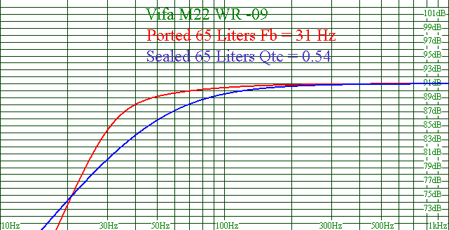

Also, remember that in a closed box, both free air resonance, Fs, and free air Q, (Qts), become Fc and Qtc respectively and rise according to the following formula:
Fc = sq rt [(Vas/Vb) + 1] X Fs
Same formula for Qts and Qtc
Below is a graph for two Vifa M22 WR-09 in a 65 liter box, sealed and ported to 31 Hz. The Qtc is 0.54. The other Vifa M22's WinISD listed were far to high in Qts, (0.7), for it to be them.
