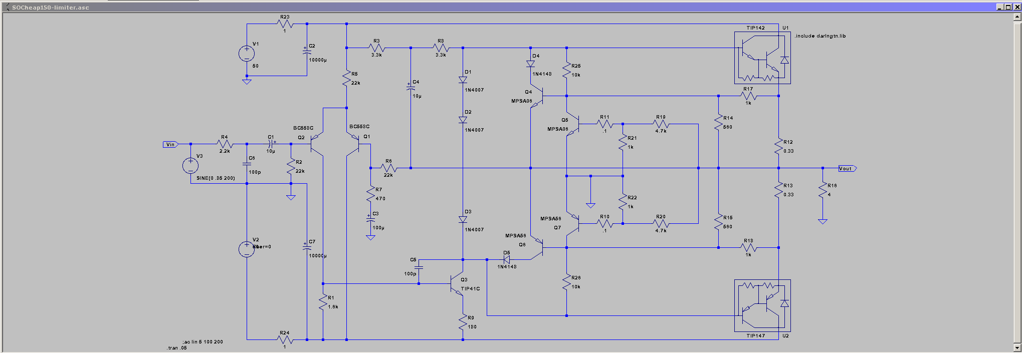

I have not abandoned my thread. I've been off learning how to use a circuit simulator, but I've continued to read this thread with great interest. There are some great ideas here. I am especially taken by the idea to compare Vin to Vout. Seems like you can protect a whole lot more than just the output transistors with that approach... even the speakers from a C-E shorted output transistor.
But alas my goal is not that lofty. I want to protect a dirt cheap power amp from an un-informed or careless user with a dirt cheap protection scheme. That kind of puts me in the VI limiter camp. But I want to improve on the concept a bit.
I realize that being the dirt cheap sort, I'm likely to end up with counterfeit transistors making me a much better candidate for high-end protection. But the most likely scenario is that when one transistor goes with a C-E short, it immediately takes out the other one which also fails with a C-E short and the speaker is safe. Then I figure there's usually a fuse somewhere that trips before a fire starts.
I'm seeing that the last line of defense has become the thermal fuse inside the transformers. They didn't used to put those in a while back, and the musicians who chose to keep rocking with a 20-Amp car fuse in their amp often got the smoke and fire. Now they get an amp that's dead to the world... and a hefty bill to replace the transformer because most techs aren't willing to swap out the internal thermal fuse. And I don't blame them.
The output shorts I typically see are the ones where the speaker cabinet end of the 1/4" cord gets unplugged and the tip touches ground. I'm guessing we might see around a half-Ohm load. So I cobbled up a simulation of my circuit. And am getting started looking at it, but I wanted to share and see if anyone had any opinions. I'm using LTspice. A free download is available from Linear Technology. You have to mess with the libraries to get the models you will typically use and that takes a bit of time. (BTW, the guys on the "Software Tools" board were a real big help getting me started with this. I even got some replies from Bob Cordell.)
Here's my circuit:

So that's as far as I got. One thing I noticed is that my gated limiter is very sensitive to offset voltage. This may be what shreds my dream of a cheap protected amp. There is no easy way to adjust the output offset voltage with this design. Even for small offset voltages, the asymmetry of this VI protection scheme is huge.
Let me know your thoughts.

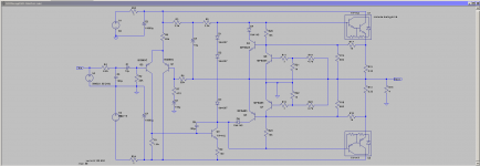

Here's my circuit:
![Simulation-Circuit.png Simulation-Circuit.png](https://www.diyaudio.com/community/data/attachments/193/193904-1dd2bb35a02f4bb6a197adc7c08995b9.jpg)
If you want to play with the simulation yourself here is the the net list. You will need to delete the .txt from the end of the file name.

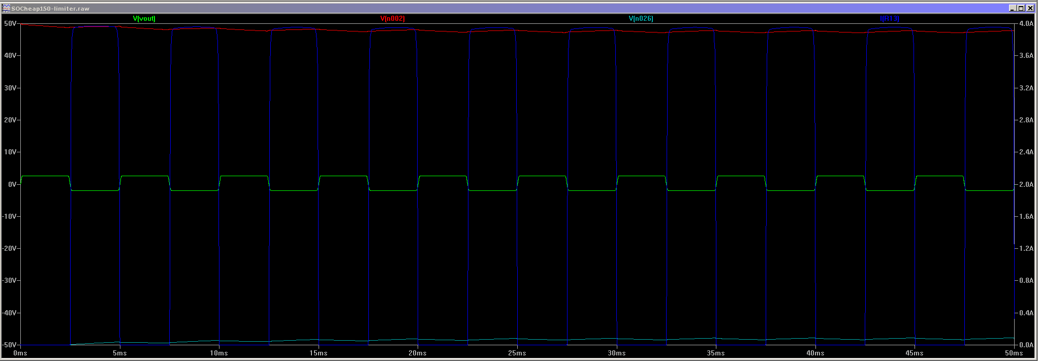

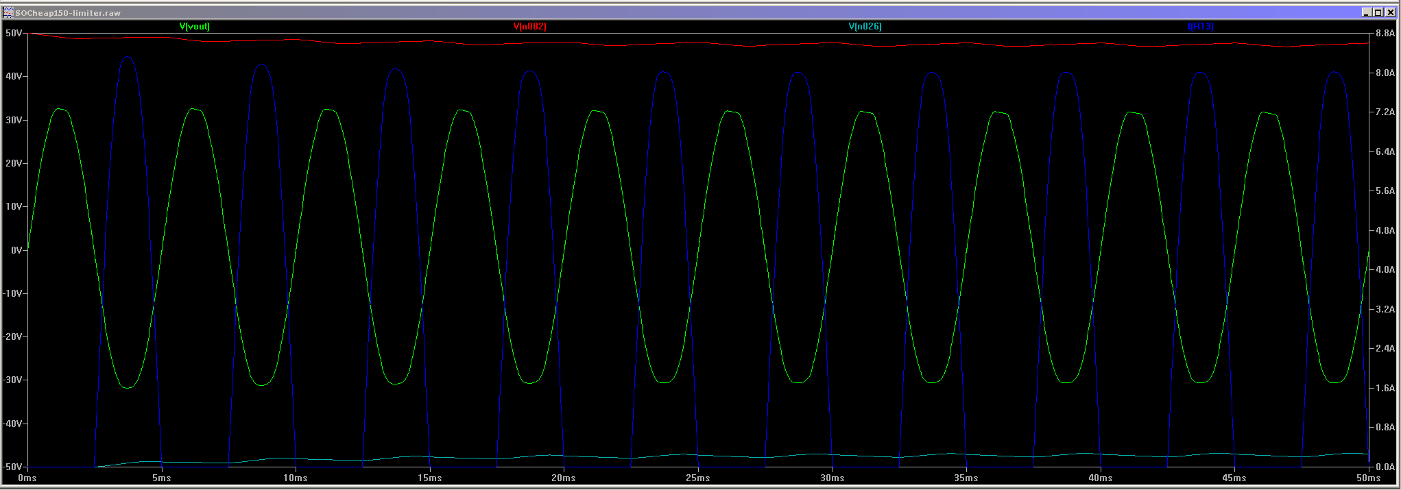

Here is the output into a 4-Ohm load:
![Simulation-4ohm-Load.png Simulation-4ohm-Load.png](https://www.diyaudio.com/community/data/attachments/193/193914-d68feaeb9a886508344eda15f7f968c0.jpg)
This plot shows the +/- rail voltages. I modeled the PSU with a 0.75 Ohm internal resistance and a 10kuF capacitor. Also shown are the Vout and the current through the negative side emitter resistor. It's out of phase with the output voltage so it's easy to see everything on the plot.
Notice that the current limiter is not active and current peaks of over 8 amps are permitted.
Next is the plot with a 0.5-ohm load representing a short. notice that the current is limited to below 4 amps and Vout is around +/-2.5V.

My goal is to protect the amp from a short, not the speaker from a shorted transistor. Usually, the emitter resistor will do that because failure of one transistor is usually followed by a failure of the other side, and then the emitter resistors blow. This sequence usually happens pretty quickly. (Although I did lose a pair of really nice headphones once when my headphone amp output shorted to the rail.)
The circuit in my simulation does not attempt to sense the rail current. Instead it's a conventional VI limiter, plus the speaker load voltage is sensed. If Vout is too low (a condition indicating a shorted output) then the maximum current is limited to a very small value. A low Vout and a high Ic are not permitted when the output transistors are subjected to a high Vce because that's outside the SOA.
Obviously all of the output and driver transistors have to be functional for this to work. But that's what I'm mostly trying to protect with this limiter.
