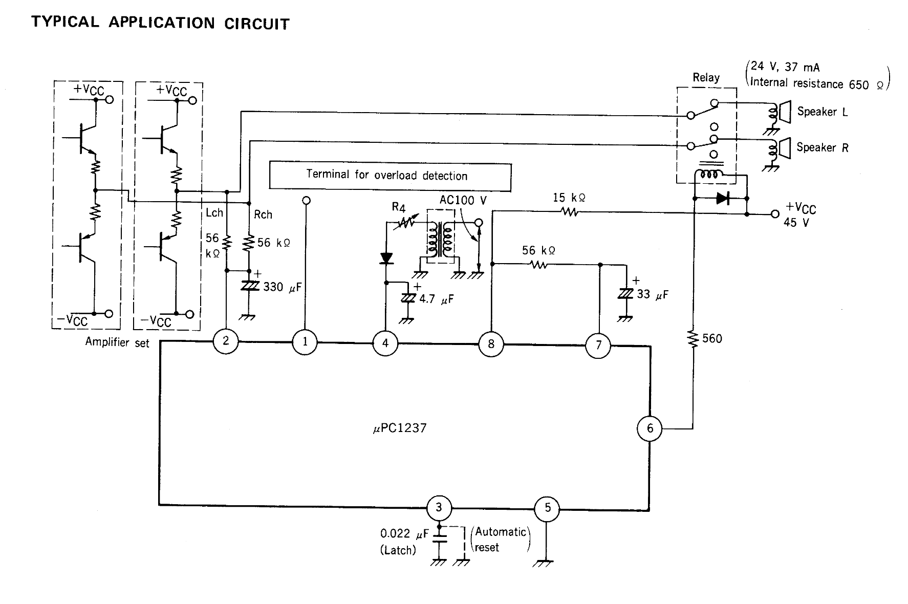

Alright, the data sheet then shows the powered on state since the speaker is connected. This is a bit confusing because I am used to schematics showing the default (powered off) state.
page 3 here:
https://www.promelec.ru/pdf/upc1237ha.pdf
also attached

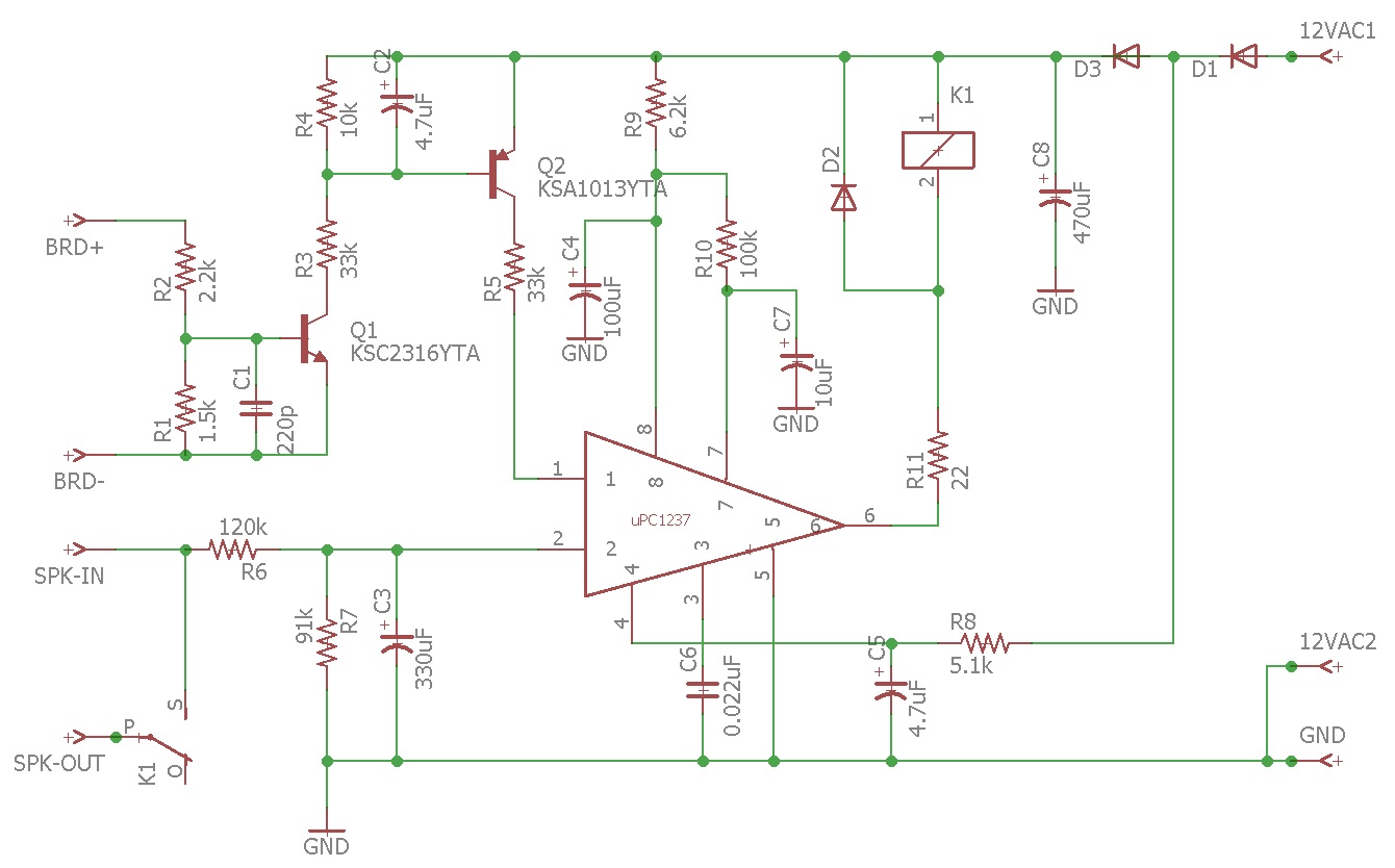

Here is the updated schematic (attached).
Q1 and Q2 are overload detection circuit.
BRD+ and BRD- goes to the emitters of power stage transistors of the amplifier.
12VAC will be taken from a spare secondary of the main transformer.
AC-OFF1 and AC-OFF2 are IC's network presence sensor and should also be taken from the main transformer secondary. I don't know how to do it properly if I want to keep using the D3-D6 bridge. Any tips?

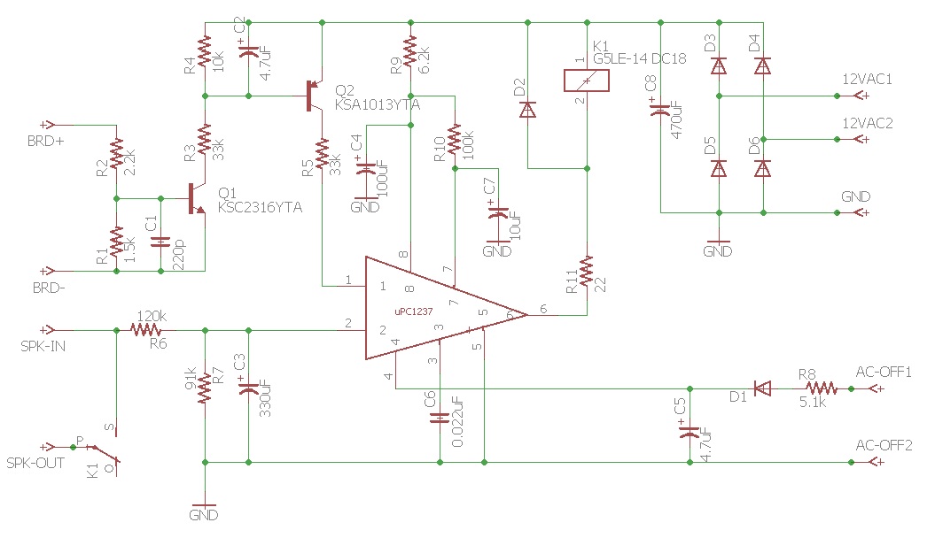

Here is how it might work without the bridge. Not sure if the DC produced by a single rectifier is sufficient quality for the Q1 Q2 overload detection circuit...
Another reason I would like to keep the bridge: my transformer's secondary is 12VAC and I have 18VDC rated relay which would work perfectly with the bridge.
Any thoughts on how I can keep the diode bridge and still get network presence sensor (IC pin 4) properly connected to the transformer's secondary coil?

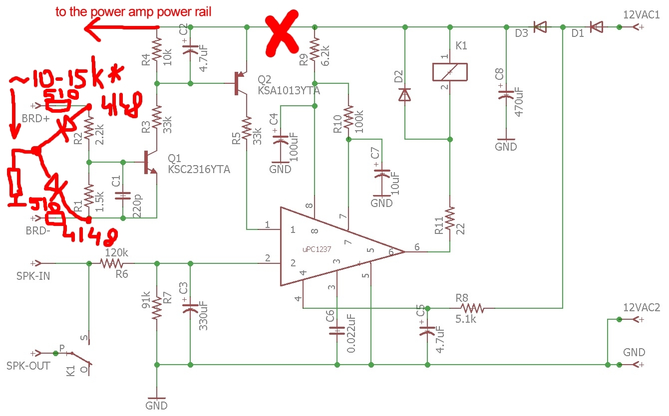

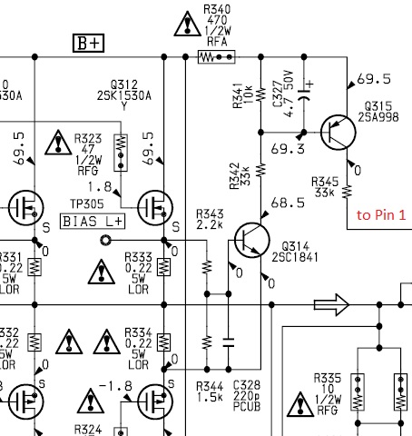

I copied the overcurrent sensor circuit from Sony TA N1 schematic (attached). It is powered from the amp power bus which as I look at it now makes a lot of sense. I will update my design.
What is the function of the diodes grounded with the 10-15k resistor in your draft?
D.Self has published a loss of AC detector that I have used on a variety of speaker isolation relays.................
It can be set to detect one missing half wave of the mains, or to detect slightly more than that.
It works very quickly and seems to be very reliable.
It would be easy to adapt D.Self's detector to trigger pin4.
For two levels of current overload. First
maximum current at normal load, second maximum current in case of short circuit.
Resistor and diodes are a function of the dynamic divider.
This is necessary to prevent the output transistors from being spoiled (SOA).
See the example of the Maranz PM 55 scheme and the like.

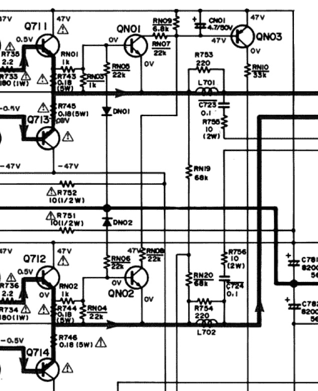

I see the divider in Maranz PM 55 (attached) however it is used with two input transistors rather than one in the over-current detection circuit. It is also worth noting that they use TA7317P instead of uPC1237.
Does "spoiled" mean go outside of SOA? How do output transistors not "spoil" when the over-current protection circuit is not there? The dynamic divider is not present then, right?

Overcurrent monitoring is possible and for one period of the signal - here positive. The reaction time of the protection circuit is several tens of periods - it is enough to detect one.I see the divider in Maranz PM 55 (attached) however it is used with two input transistors rather than one in the over-current detection circuit. It is also worth noting that they use TA7317P instead of uPC1237.
The protection chips are functionally the same.
If you follow the rules, protection is not needed. The commercial manufacturer himself decides the depth of protection.Does "spoiled" mean go outside of SOA? How do output transistors not "spoil" when the over-current protection circuit is not there? The dynamic divider is not present then, right?
In the practice of repair burnt out transistors output - it happens often.
A sophisticated and well-designed protection system can reduce the cost of the output transistors, the size of the heat sinks.
In modern models there are many output transistors and there is absolutely no protection circuit and relays.
See Krell, Mark Levinson and the like.

Alright, I looked a bit more at the Maranz PM 55 schematic and I just realized that the diodes of the dynamic divider are used in the two channel protection, one diode for each channel.
The protection circuit I posted (and you commented on) is for one channel. BRD+ and BRD- go to emitters of one channel. I will have another identical PCB for the left channel (it will control the other speaker).
Given these clarifications, do your corrections still stand true? Thanks.

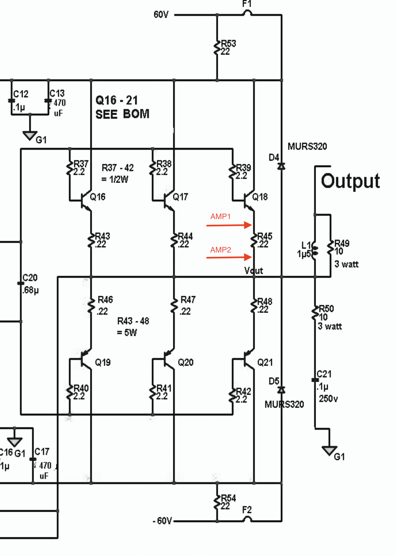

I want to have a separate protection for left and right channel, so in my design I plan to use two uPC1237 boards. I think I have to use the following schematic if I follow the approach Maranz PM 55 have taken (see attached).
I also included the output stage of my amplifier and pointed where the AMP1 and AMP2 inputs would connect. Does this look right?
The second channel will have identical schematic with a separate IC and will drive the other speaker relay.

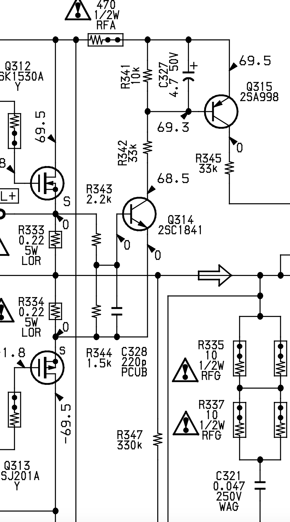

Sony TA N1 (attached) doesn't use diodes at the input of over-current detection circuit. Instead they have an asymmetrical voltage divider using R343 and R344. This gives them a small offset at the base of Q314 which they then amplify and send to pin 1 of uPC1237. I am not quite sure the purpose of C328.
Does this sound right or am I missing something? Does the fact that Sony uses MOSFET transistors in this amplifier make any difference in how over-current protection circuit needs to connect?

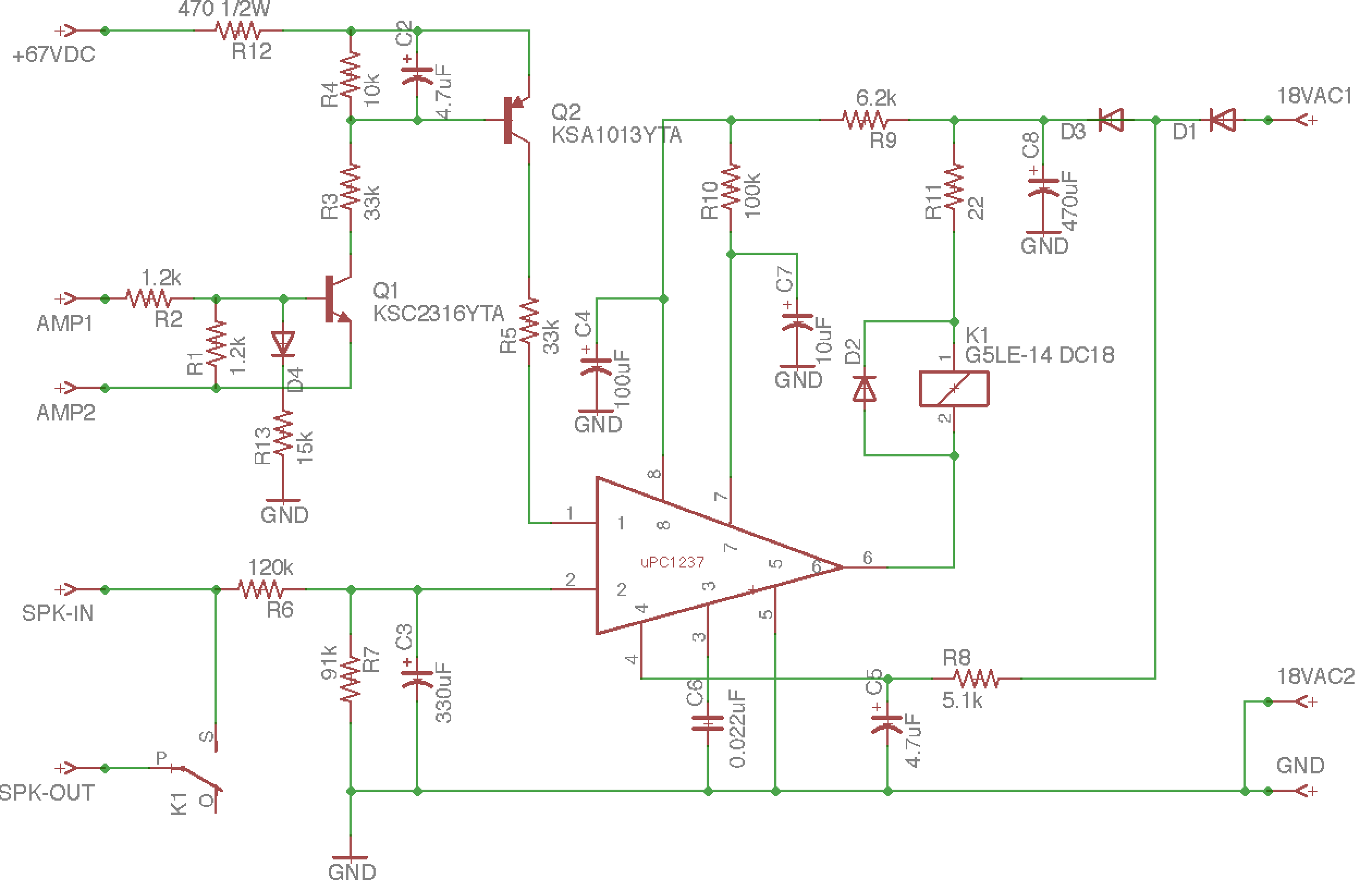

the spk-in passes through 120k and is filtered with 330uF to then feed pin2.I want to have a separate protection for left and right channel, so in my design I plan to use two uPC1237 boards. I think I have to use the following schematic if I follow the approach Maranz PM 55 have taken (see attached).
The 91k increases the time constant.
The R6+C3 time constant is ~40seconds to reach ~60% of the input signal.
Adding R7 probably increases RC to over a minute.
That seems far too slow.
One second would be more appropriate.
Try reducing C3 to 3u3F MKT and temporarily remove R7. Change R6 to suit the final RC value you require.
If voltage limiting is required for pin2, then add a protecting Zener across C3.
