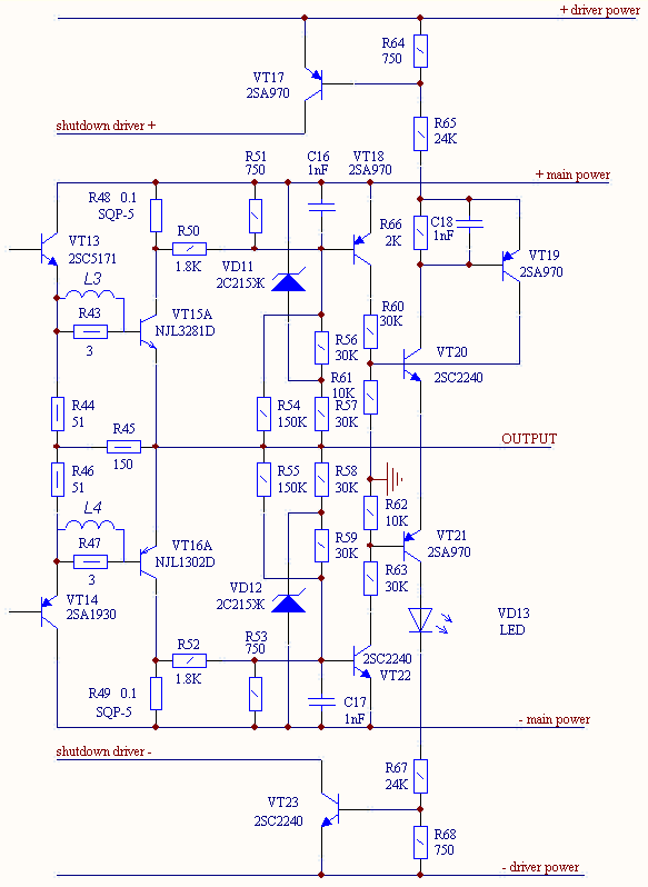

This is sample of SOA protection. This variant don't affect on sound of amplifier

If current throw output transistor (VT15/16) is high, voltage on sense resistor 0.1 Ohm opens transistor VT18 or VT22. Circuit with resistors 50-59 and zenners varies open current as to limit power dissipation on output transistors. VT19-21 - trigger. It opens VT17 and VT23. Its must switch off driver’s cascade.
Kostya-M, thank you for your answer.
I cannot understand how it works. I am confused about how it will sense the overload and how i will set it for specific transistors.
I guess that this is a sample, as you wrote, do you have a schematic more specific?
I think that this could be help me more.
Thank you.
Hi Billys
Look at schematic by parts and only on upper half. Lower half works the same. Current throw VT15 makes voltage on R48. This voltage open VT18 throw R50. Sensitivity of this schematic is about 7 amperes and, in general, is defined by value of R48. But power dissipation on VT15 depend on current and voltage on transistor. Resistors R54, 56, 57 and zenner VD11 (15Volts) makes two linear approximation of hyperbolic curve of maximum power dissipation. When power dissipation on VT15 grows 150W, VT18 is opened and trigger on VT19-21 fixes this overload. Capacitor C16 removes short overloads. Often, value of C16 can be more greater, because power transistors allows short overloads.

This thyristor (trigger) don’t resets on zero voltage. Its need to switch off amplifier to reset. I think about autoreset schematic, but can’t solved it for my amplifier schematic.
Excuse me, I know English so so.
Any part of my protection circuit is well known. I only compile it from standard elements. Thyristor as the element I don’t use in schematic. But trigger on VT19 and VT20 is thyristor is made from transistors. My schematic doesn’t shut output of amplifier, but only switch off driver. If output DC voltage will be greater than limit, then controller of amplifier switches off power.

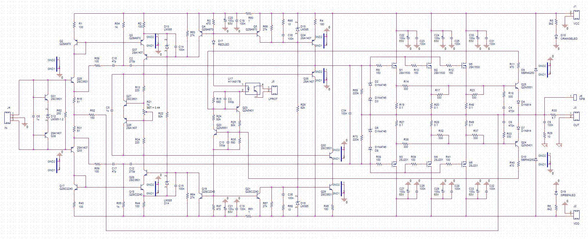

Hello, Billys!
Where is no schematic sheet on the web page, only pcb sheet. Therefore I can’t analyze how driver works in this amplifier. Because of supply voltage is +-70 V (not of 40V as in my schematic), and emitters resistors 0.47 Ohm are greater than 0.1 in my, resistors nominal in safety scheme will differ from my. Supply voltage of this amplifier is large. It’s possible that needs to use three linear approximation – resistors R57 and 58 separate every on two and in points of junction add second zenner of higher voltage then VD11 and 12. Anyway, it’s necessary to recalculate resistors with proper attention.
