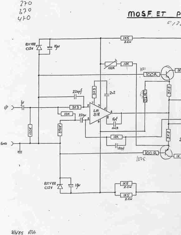

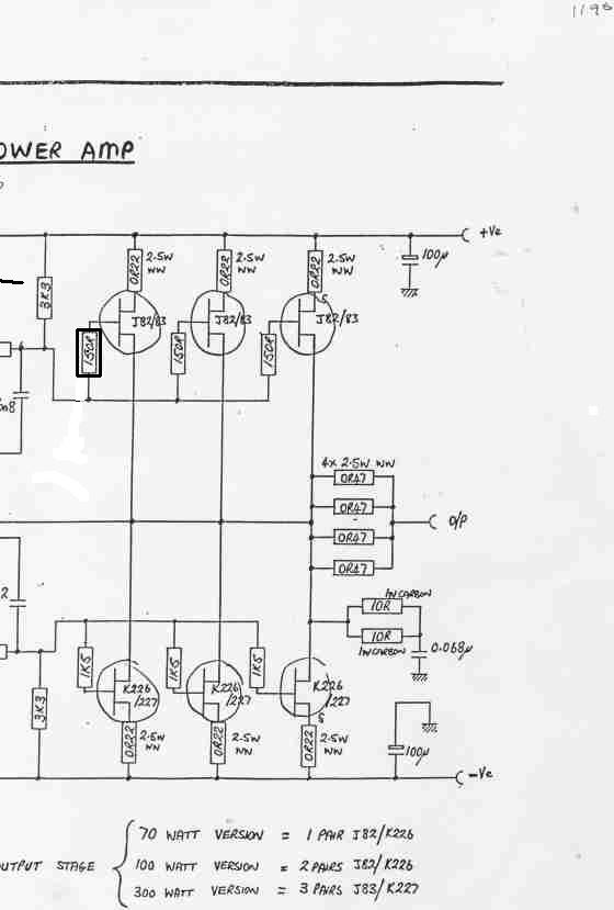

I now know that a resistor is burning out, I have marked this on the drg. I downloaded from this site which was kindly posted for another problem.
Does anybody have any idea why this resistor would keep blowing? The amp still works but I guess because the other two FETs are having to work harder the heatsink on this side gets so hot I feel it could cause further damage over a period of time!😱

Hitachi J162 Mosfet
Hi, Have found that Aura Note Premier uses these devices. I cannot find any Hitachi devices on the www I can only find Renesas, would these be drop-in replacements for the faulty one or would I be better to replace all to keep everything ballanced? I am a bit wary of buying on the www from China source due to the stories of fake items being produced there.🙁
Now singing sweetly
Thanks for all the advice guys, on removing said Mosfet small hole in back (not visible from front) hole in insulator and also heatsink! have now replaced and amp is once again singing sweetly! Thanks again to all, most helpfull.😀
