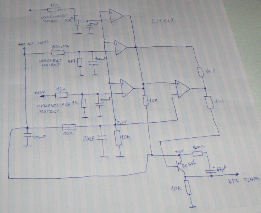

Hello!
I draw simple protection circuit for my new switcher. I need your opinion if this thing should work.
At right is a comparator used as flip-flop. I never used it that way but I think it shoud work 😉.
Overcurrent sensing is made with current transformer, diode bridge and capacitor that are not drawn in shematic.
Electrolit capacitor 47uF is used for soft start, as described in design guide for TL494.

The output comparator is not a latch. Instead it is a comparator with positive feedback and thus hysteresis. When the fault condition is removed, the comparator will switch back to the no fault state. You are also right that the circuit may not work correctly on start up. Finally, how fast do you want the circuit to be. The caps seem large.
yor circuitry will not work for sure.
1. 339 is open collector so you need pull-up resistor for each output.
2. because of same reason as in previous, you will need diode for each output to separate outputs one from another.You will need to connect diode after pull-up resistor
3. And i asume that it is much better to use logic 'And' circuit with 3 inputs instead of last comparator, because it will be much faster and you will not need to think about feedback for each comparator.
Gain of comparator with open loop is very bad choice for pwm, as you intend to use. You need to use any compensation techniques for closed loop fedback stability but it is not necessary.
Sorry, i have not noticed where you drew junctions, so you don't need scheme that i drew.
But for overcurrent protection you must use any kind of stability control, or your flip-flop will always be 'On' when you start your circuit under load, or you will need to tune treshold current much more than you should expect, or to use bigger caps at input, but this will slowdown protection.
Belive or not, circuit works great 😀
I had some problems when power was applied, but I solved it by adding 47nF capacitor between outputs of comparators and +5V, so when power is applied, + input of output comparator is much higher than reference voltage and it doesn't trigger.
Outputs of comparators are active low, so when they are triggered, they are connected to ground. So when any of them is triggered, all outputs drop to zero. Pull-up resistor is 10k. and it serves also for flip-flop as voltage divider with resistor 3k3.
Let me explain how flip flop works. When comparator is not triggered than voltage on + input is 5V and on - input is always 2.5V. When one of input comparators gets triggered, voltage on + input drops to 0V, that triggers comparator and sets output to 0. If fault condition disappears, + input remains lower than reference voltage, because resistors 10k and 3k3 act like voltage divider with voltage of 1,3V.
Capacitors at input of every comparator are 100nF, i think they are not too big, as voltage diferences are quite low. If you have any idea how to improve my circuit (different elements, etc) please tell me, I would be very grateful.
I have no idea how fast protection circuit reacts, but it sure prevents input transistors of SMPS from blowing up. I know because I tried wery hard to destroy them by shorting output, but I didn't succed 😀. I didn't test overheat and overvoltage protection, but I'm sure they work.

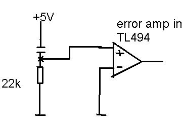

Thaks, it's a nice idea, I'm going to try it, but last night I was thinking about using second error amplifier in TL494 for slow start with capacitor and resistor.
Before I try this, I will connect potentiometer to DTC and try to find out what happens if I change voltage to this pin.

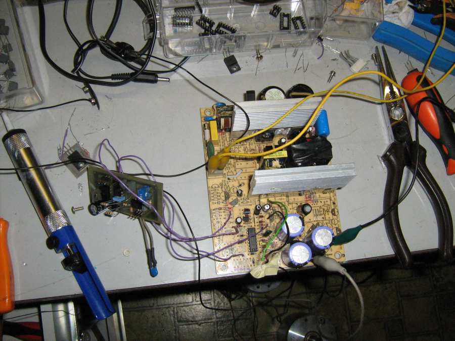

This is my prototype with my previous protection circuit that worked great in theory, but in practice not at all 😀 At output is NE555 and restarts switcher 10 seconds after error condition. I found shematic somewhere in internet.

voltage betwen 0V-3.5V (0%-9x%<100%) at DTC or pin 4. directly control pulse widith, and outputs of 2 error amplifiers are connected to DTC so they just amplifier difference betwen + and - and change voltage at DTC. I have tried to use similar overcurrent protection with current transformer in PC PSU ( as car battery charger), it had worked very fine when i tried to shortcircuit it (for several hundreds times), but when i have tried to charge big battery (1,2V) with about 10 Amps (10Amps was overcurrent protection) overcurrent protection did not work as i planed, and simply it was dead.Than i tried to create some kind of current regulation and to use second error amplifier from TL494, and i could not make it to work. I connected Voltage from current transformer to noninvert. (after rectification and after filter ) input and to inv. input i connected Vref (Vref is changeable by pot). But it did not work good.For example i load it with light bulb, and i tried to control current. so i start from 0A and slowly rise it up until light bulb had full brightnes(potentiometer was at middle and Vref=2.5V), but when i tried to reduce current i needed to rotate potentiometer to much (pot was at quarter, Vref=1.2V).

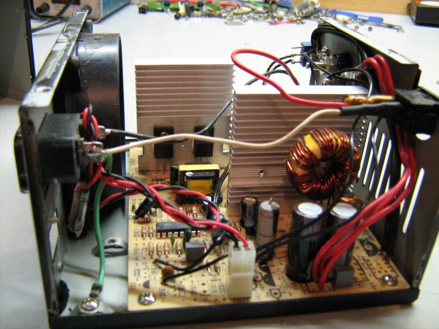

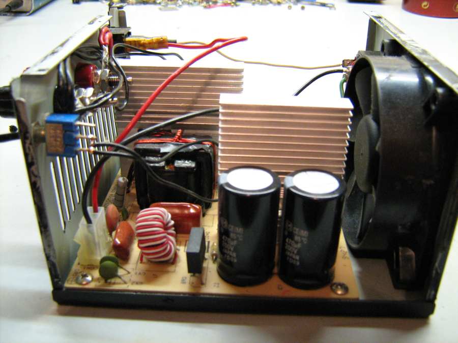

I have similar power supply like you made, but is capable of 25A at 14,4V. When you take a look at primary transistors and transformer you won't belive me 😉. I'm using it almost every day for several years now and I didn't change anything yet, it's pretty undestroyable 😀. It's quite amazing that while I was developing it, I didn't destroy any transistor. With prototype I'm developing now I blew about 6 pairs of transistors, mostly because of stupid mistakes like overheating (I had a phone call during testing 😀), bad isulator, screw under board etc. Diode bridge and fuse survived all of those mistakes.
With switch I select between 12V and 14.4V output. It's able to start with load of 4 bulbs 12V 45W in paralel, but if I connect a bulb while it's working it turns of.
