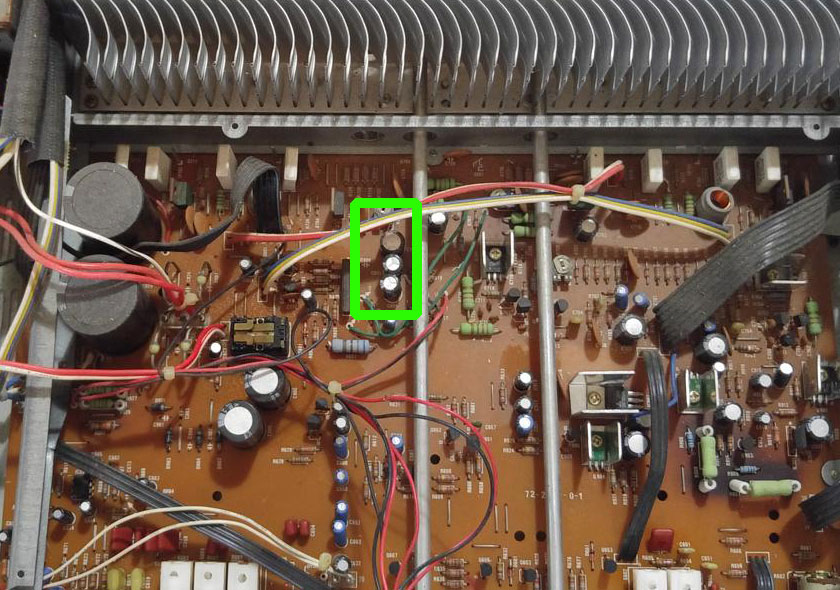

I started this post in 2007, never got any responses so I put the component away. Dug it out and would like to see if I can get it running. Did some more diagnostic and here is what I found:
I have an NAD 3155 that is kicking in the protection circuit at mild volume levels. Here is what I have discovered.
- Protection circuit comes in with speaker outputs turned off
- With balance all the way to the left speaker I can play the amplifier quite loud.
- 4/8 ohm switch doesn't impact the problem
- Sound quality doesn't seem affected
Any thoughts on what to look at?
Derek.-

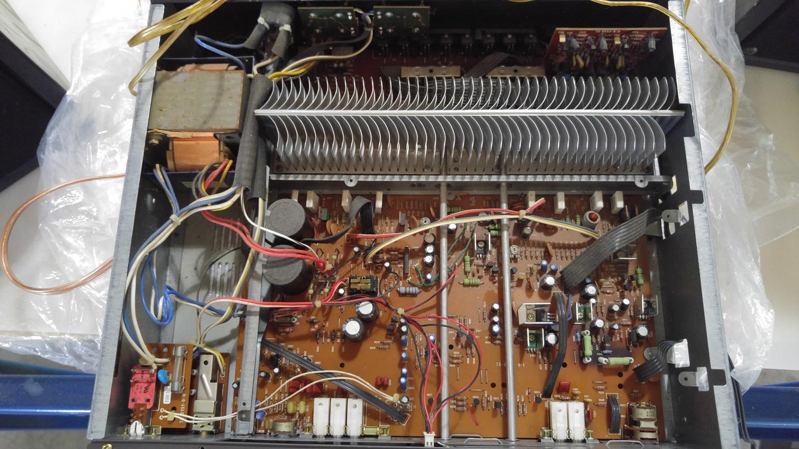

So both channel came to life after I touched a number of the caps on the main board. Maybe an unorthodox method of diagnosis but I took a tongue depressor and touched the caps while the unit was running. Found a few bad cold solder joints.
After a touch up with the soldering iron its back up and running.
Cleaned all the pots and adjusted the dc voltage and it should be good for a while.

If there are older amps for service, this is still the best way before start the actually troubleshooting. At least the caps arround the Toshiba protector unit TA7317 (the part in SIP-outline in left of the marked area in your image of previous posting) and all electrolytic caps near by parts, which are under thermal stress.
In this amp model there are also two burned PCB areas (dark PCB areas) near by two high wattage resistors. This resistors runs too hot. Please replace this resistors through 17 watt versioins with larger surface or use 10 resistors in parallel mode (instead only a single resistor as in use in genuine condition) with 10-times of the ohm value. Then you will get an additional enhanced reliability.
