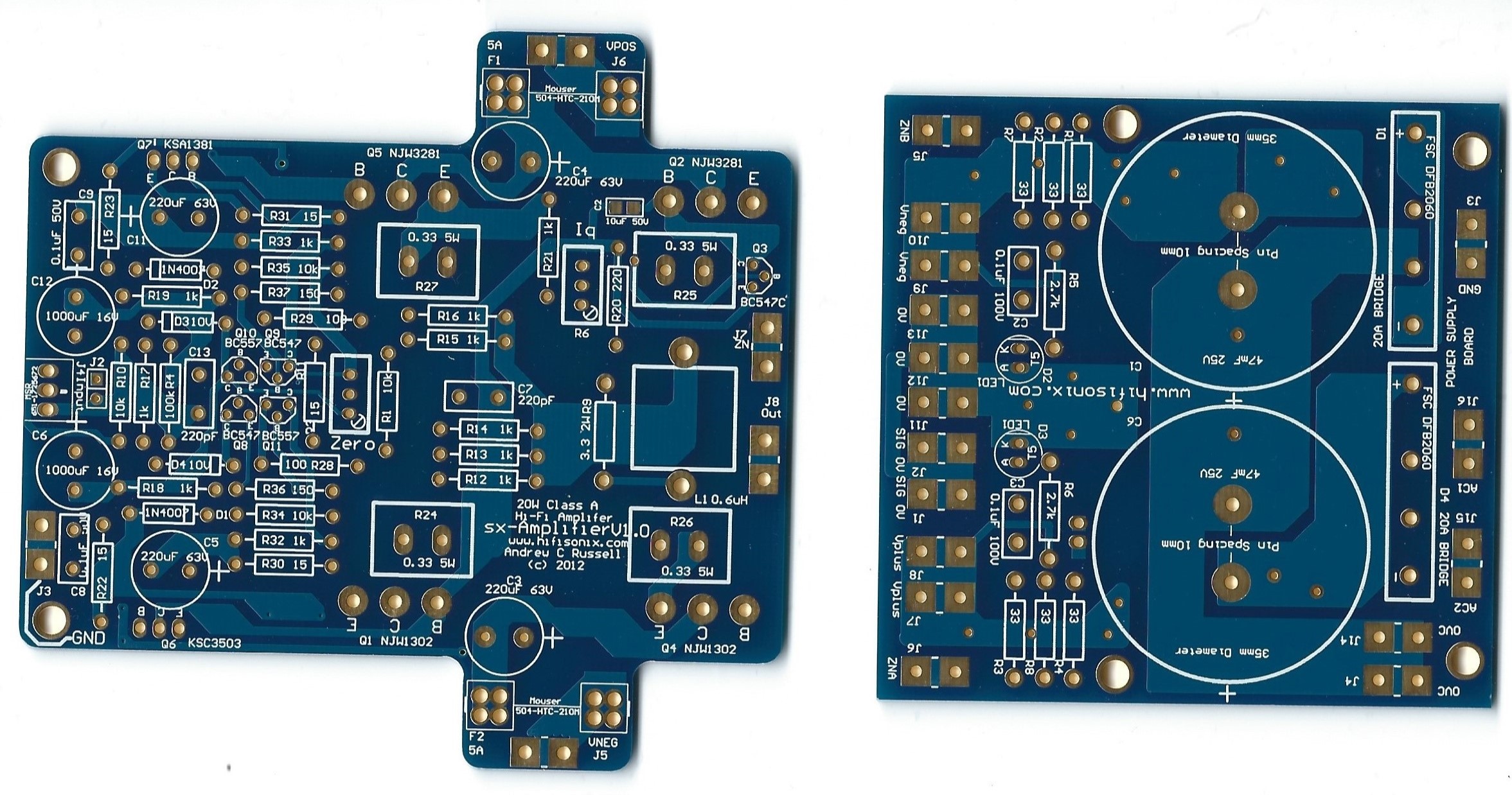

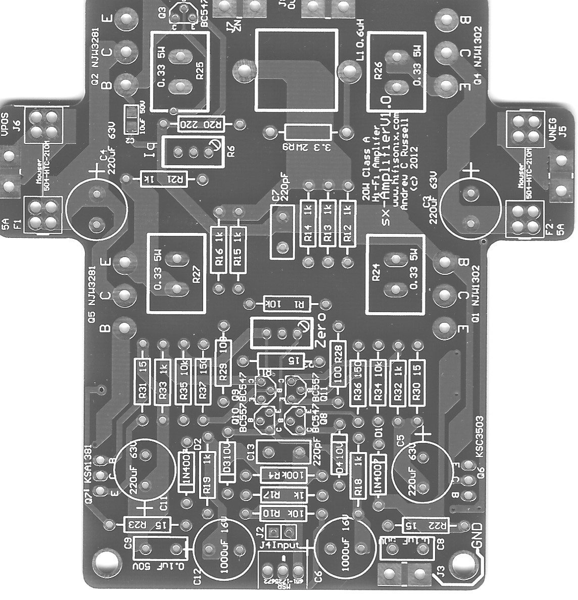

I have a question about Q3 and the solution mentioned by bambadoo. I saw a picture with a short from leg basis Q3 to R20 and a photo with a connection to R21. I do not understand witch of both is the solution or is the R20 with the 2.2/2.4K the solution for the Q3?
The C2 SMD on the amp circuit. This one not solder?
With regards, Frits

All the components for the sx amp are arrived a time ago and I like to start soldering but I am very very unsure about this last point and I need a solution for this point. I did not see a solution for this question yet.
There is a picture I got from Bambadoo e-mail, there is a jumper wire from Q3 (BC547C) to resistor R20 (R21 ?). Do I solder this jumper? Instead BC547C I use BC550C. But I suppose that's no big difference for this point.
I am happy with any help in making this amplifier. Thanks, Frits
Hi Andrew,
I have soldered the most parts on the amplifier circuit but there is one resistor I do not understand R9:.... 3.3R 2W on the circuit and in the BOM list 3.3R 0.5W . Can I use the 2W or the 0.5W? This is a flame resistant resistor?
With regards Frits

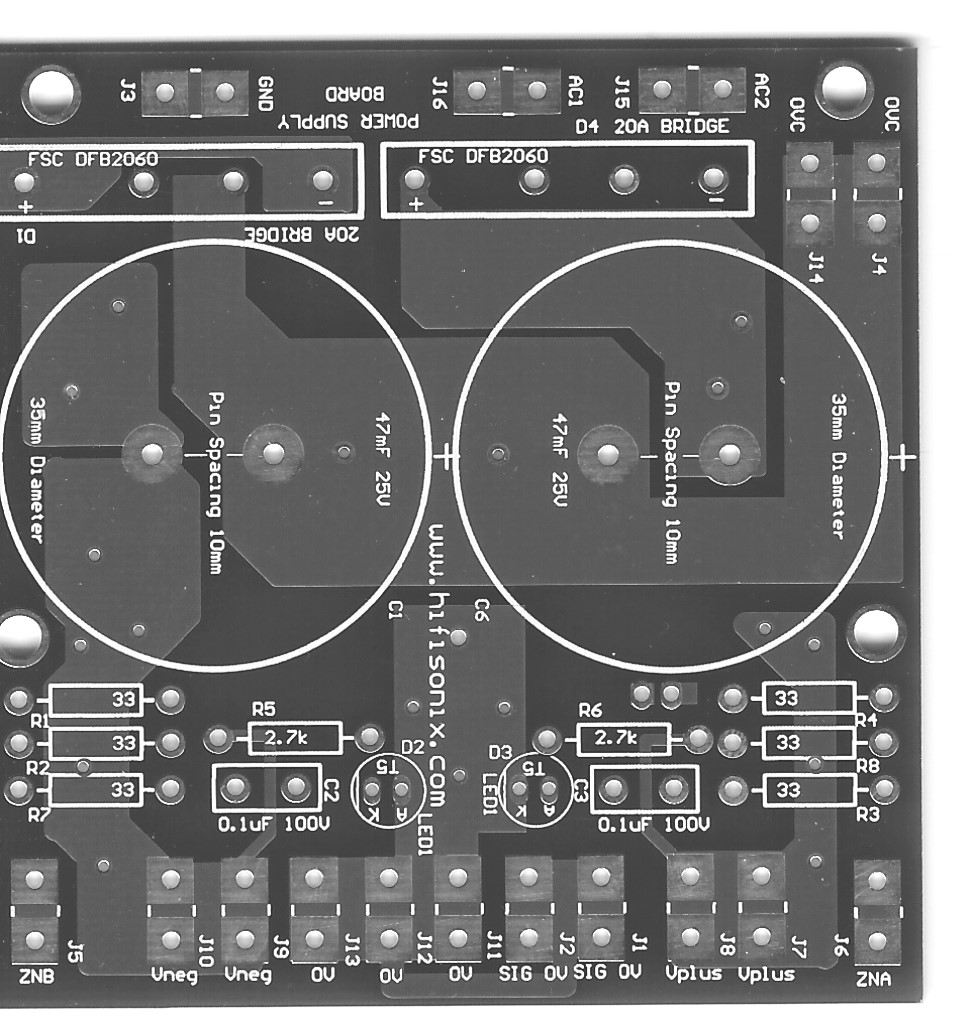

Another questions:
1) The fuses 5A on the amp board? I cannot find if they must be slow (T) or fast (F) fuses?
2a) On mine version PSU are two rectifiers. Should I provide them with a cooling radiator?
2b) And I have to solder a 10nF 100V capacitor(s?) on the bottom of the PSU. I think from J3 (GND) to J14/J4 (OVC) but that is a great distance (50mm) on mine board. Is this right or is there another solution. I can extend the legs of the capacitors.
With regards, Frits
