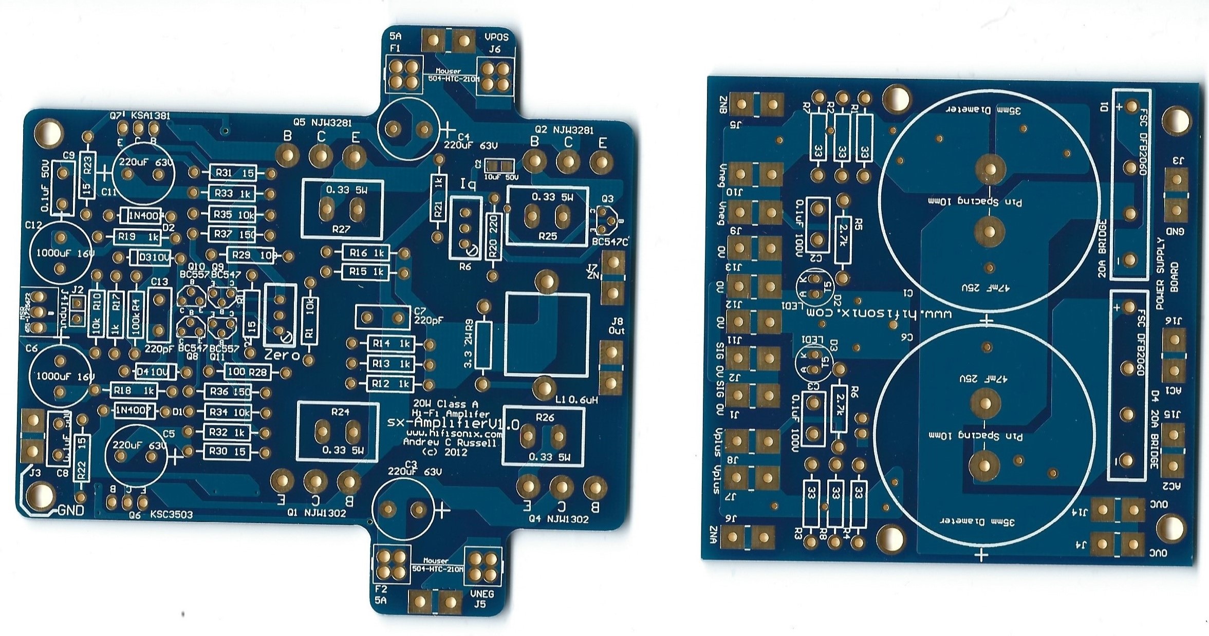

ime building the sx boards at the moment ,, can anyone confirm or help me ? the board come from jims audio , on the boards( r20) is marked( 220)......and (r4) is marked( 100k)........ the bom list (r20) is quoted as (2.2k) and (r4) quoted as (15) which one is up to date ? what ones should i use
Board is marked incorrectly. R20 is 2.2K. The version 2.10 document for the SX amp shows R4 is not to be placed on the board. See the schematic page 14. Note that link J2 shorts across R4 anyway.

I got just 2x boards with sx-amplifier V1.0 Andrew C Russell 2012 and 2x power supply
Is there somewhere a Bom list and building guide or some other information about this diy circuit?
I do not how to start yet....I search but get not the right information

I incorporated your feedback from your build into the latest document bambadoo - should be up to date.
Wolletje, V1.0 boards are quite old - there were a few component value changes IIRC after that. Where did you get you boards from?
