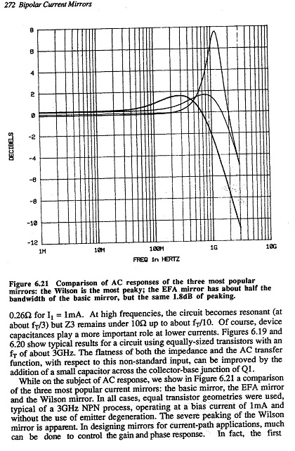

Here is the literature on current mirror peaking. The extract from a book was written by Barry Gilbert.
The devices used to get the results were 3Ghz parts and i wonder what the results would be with 100 or 200 Mhz parts ?? Would there still be peaking and at what frequency?? As can be seen the 3 Ghz parts show peaking at or just below their ft.
