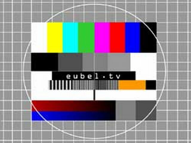

This posting is for all owners of a Proxima A822C. Maybe you can help me.
I opened the case and looked at the controller board. There are some testing pins labeled from TP1 to TP13. These are pins where you should have a certain voltage. So if anyone can take the voltages at these referencing pins i can compare to those of my panel.
Please take the attached image and show it in full screen mode. Measure the voltages at TP1 to TP13 and post it here. This could help me to locate the place or integrated curcuits that are not working.
