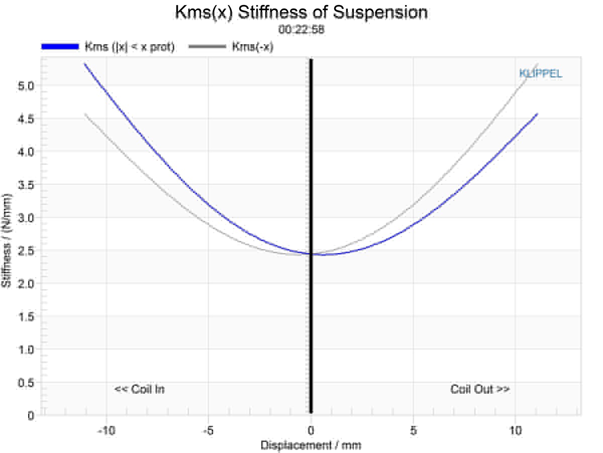

I suspect along the same lines of single-ended OPTs or DC biasing crossover caps.
On first blush it would also push th edriver out of its most linear range. Maybe even beyond xMax on some fihg sensitivity FR drivers.
