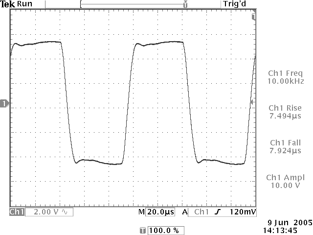

EC8010,
Is there a chance we could get you to comment on what the square wave data shows, as a comparison between these two. I am of course interested in what the various differences might mean in character or subjective results, but I am more interested in what the data shows us about in circuit performance in an objective sense.
Taking these two examples, are there benefits to performance in the rest of the amplifier, since these things are essentially the final arbiter of amplifier performance.
Bud
Bud

BudP said:EC8010,
A clean 10kHz square wave indicates good HF response with little phase distortion and implies that global feedback can be applied with little danger of instability, Obviously, it's not the whole story, and the other end of the spectrum is important too. Mains toroids might pass an excellent 10kHz square wave but they can't cope with power at low frequencies and are easily saturated by out of balance anode currents. That mains toroid I tested needed anode currents to be within 1mA of one another. In the end, audio transformers are about octaves. The trick is to maximise the number of octaves that can be passed and to position them in the right place. Of course, mains toroids work well as tweeter amplifiers.

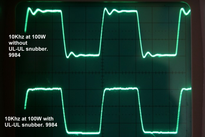

Although a famous name, it took me a mighty amount of midnight oil squinting with a waveform shown in pic and correcting it and if not for experience I would have thrown the towel in. Beginners eager to get in the power game take note what one is up against ! It Pays to keep to easier LP and known designs.
10Khz at 100W isn't quite all gloves off.
Thanks to all comments, I'll now hunt down the german types and sus'em out.

richwalters said:Although a famous name, it took me a mighty amount of midnight oil squinting with a waveform shown in pic and correcting it and if not for experience I would have thrown the towel in. Beginners eager to get in the power game take note what one is up against ! It Pays to keep to easier LP and known designs.
richj
That looks quite impressive...
soulmerchant said:That looks quite impressive...
Quite impressive? I'd say it's amazing!
