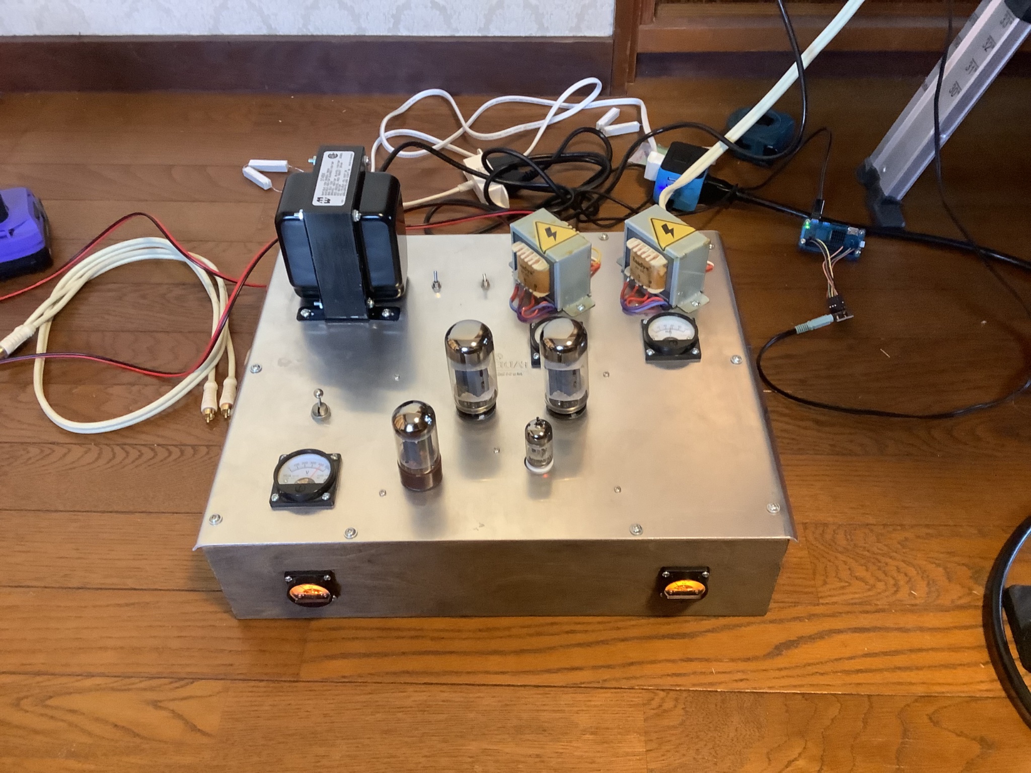

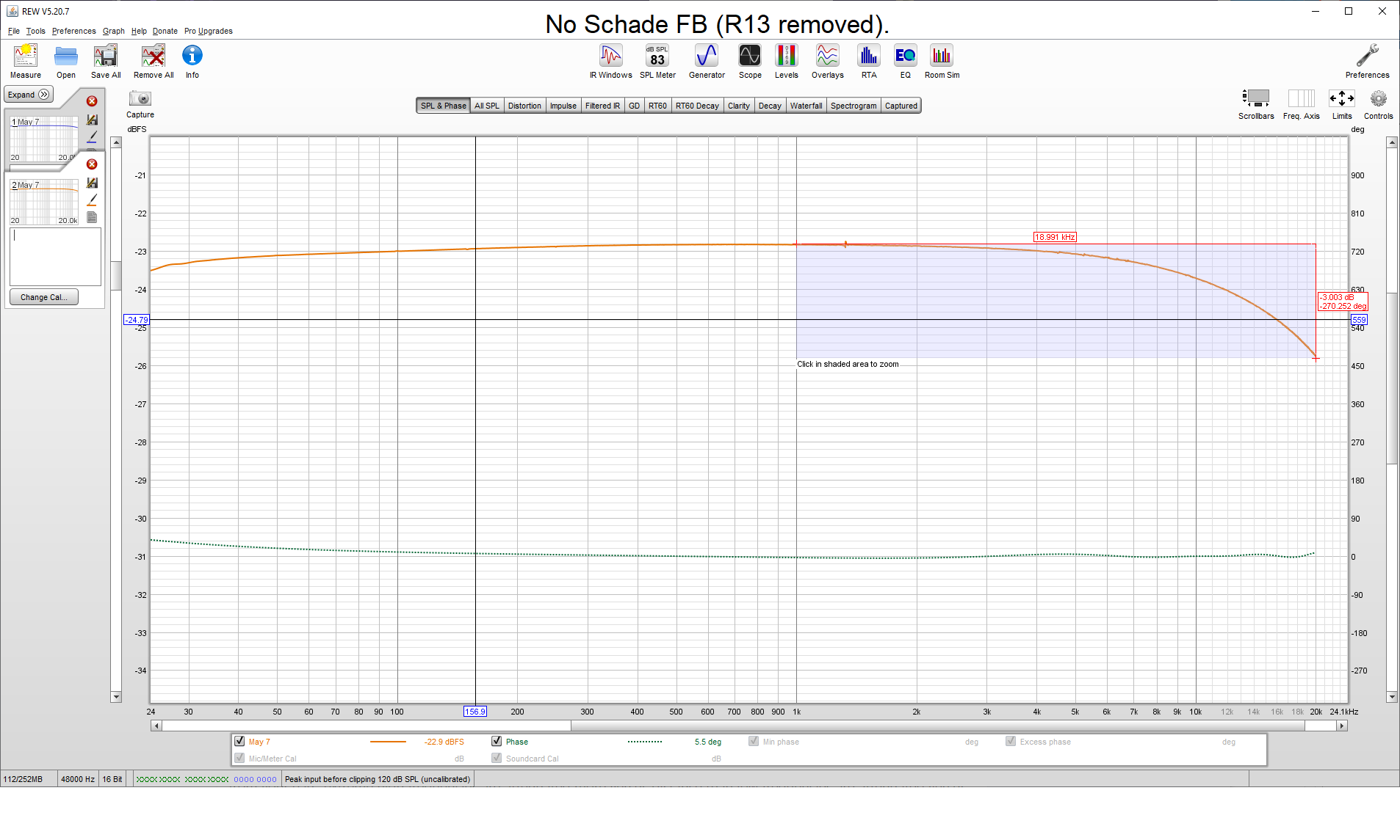

I bought a while ago a pair of 15W 3.3K SE transformers, at around £25 each, they worked pretty well. I'm sure that established manufacturers like Edcor, Hammond and the likes can do better, but hey, it was a very good value for money. Below the bandwidth measured at 9Vrms/8ohms output in a very simple PSE setup, bang-on -3db @20Khz, as the seller advertised. That's good value in my book:

And you are comparing an SE with no negative feedback, with a typical PP that has plenty of it. NFB flattens the response.
The graph was used to cite the perceived "good performance" of a transformer which was presumably bought from China, although he doesn't specifically say.
All I'm saying is that if that's the performance one can expect, I'd personally look to spend my limited funds elsewhere.

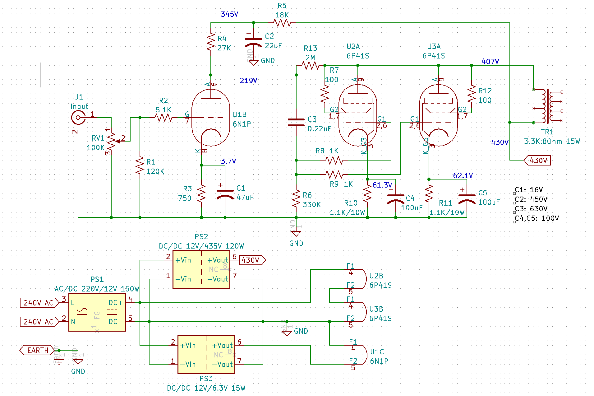

My bad, yes, the transformers were bought from China, via Aliexpress, used in a PSE prototype, no negative feedback. Here is the schematic (including my lazyness for not showing the output winding connections)
