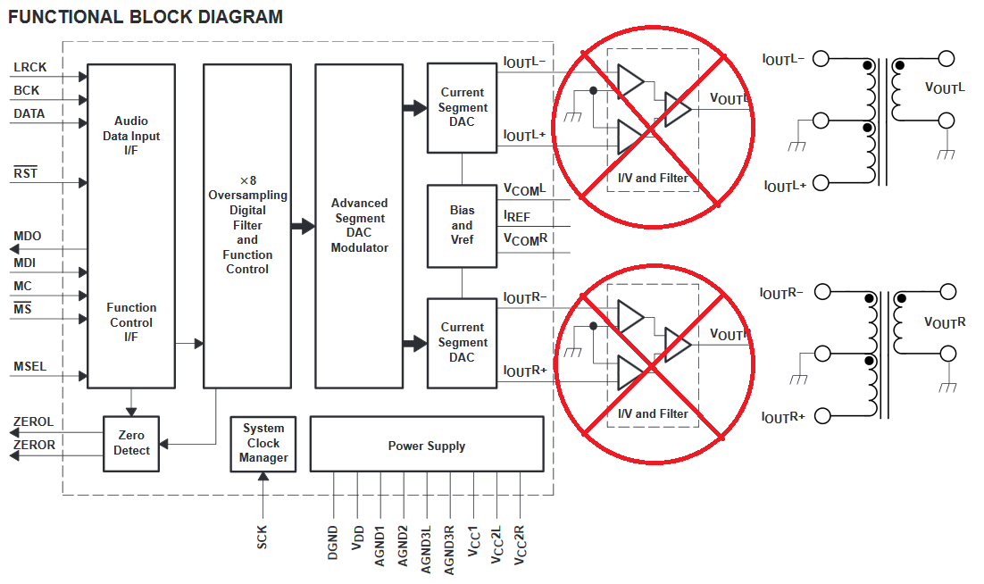

ES9038PRo or 9018S have ~2VRMS (do not remember exactly now) at 2kOhm in the secondary. It is about 5.6Vpp. Well to be under 3Vpp it is needed to use 1k or less. Indeed your 500r (+/-) 🙂

Yes, much better. At 2k it was also good and maybe having higher gain than before could sound better for DAC chip (or transformer could respond better?). With lower gain the lossless digital volume control has more resolution, that is the main benefit.
Im noticing there is a low ground loop noise, the DAC and amp ground are isolated and amp is silent with shorted inputs, so it must be from cable to transformer. There was no noise with old output stage and same cable so its confusing, the cable is around 1M twisted pair RCA.
Did you connect the (-) wire of the secondary and shield to the ground of your DAC as shown in the first post of this thread? If we talking about 50/60 Hz from the mains, then of course you should avoid any loops of the ground.
no, I hadnt. thats fixed it and it sounds even better too.

So far I tried a couple small resistor tweaks.
500r 1/4W replaced with 500r 1W (2 x 1k 1/2w in parallel), this seemed to improve sound a bit.
But going even lower to 120R sounded much better!
The DAC volume still has a lot of headroom so I will try to go even lower if it means better SQ, these trafos have already met my expectations so anymore improvement is a bonus.
I read going too low can cause ringing , something I will watch out for.

9018S or 9038PRO are strong enough sources to drive high impedanced headphones directly. But do not connect your phones directly to (+)/(-) because after playing musical signal, there can be constant high DC-offset. Be careful, across capacitors or transformers only!

I remember someone mentioned that for trafos which are sensitive to DC the Sabre offset is not a problem, the DC for each differential output is equal (+1.65V) so the headphone/transformer will see 0V.
You are right, sorry. I confused ES with AK. ES have no DC-offset between (+) and (-). Well, you can try your headphones directly, but my DT-880 (250Ohm) sounds very poor from the raw output of ES9018S (one channel or two speakers in parallel - no mater). Additional amplifier is needed, right.

I think the PCM1794 will output 15.6 ma peak to peak, and the ES9038 about 1/2 of that, 7.7 ma p2p.
Wondering if I would be able to use the same iv transformer for both DACs, changing the resistor to get the appropriate output levels?
Looking at your first post, seems like it should be fine.
Would this approach make any compromises, vs a transformer just designed for one of these dacs? (or do you have one design that covers all current out dacs?)
