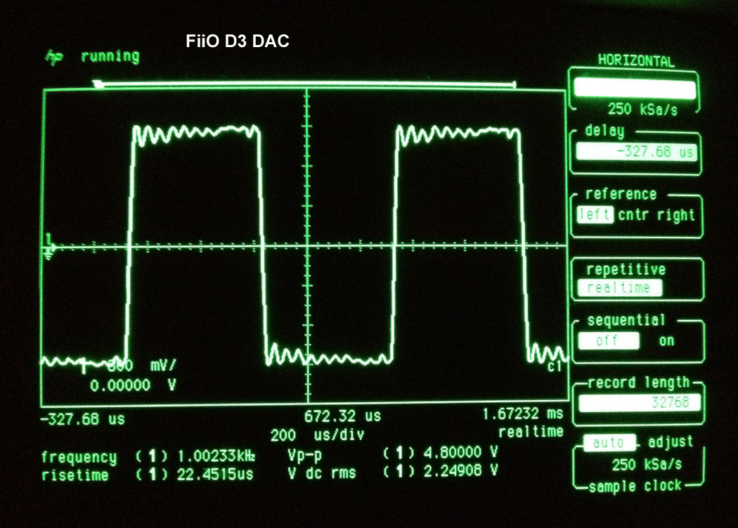

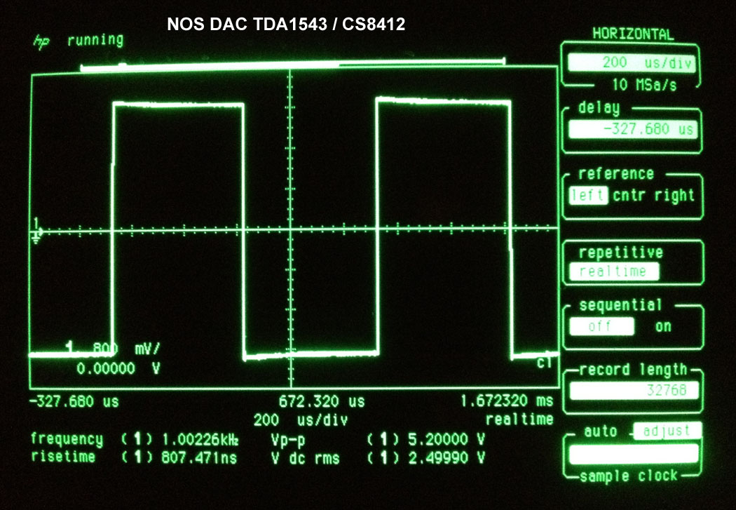

Measured maybe 5 or 6 DACs on hand today, will post pics tomorrow.
Test signal was CBS Records CD-1 track 16, which consists of 44 samples positive / 44 samples negative at full scale. Or, in other words, the square wave frequency was 44,100 Hz divided by 44 Hz = 1002.272727Hz ...
This is one of the best square wave test signals to use, and works well to show the DAC oversampling digital filter response.

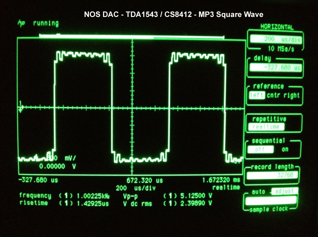

For grins, I made a MP3 copy of that square wave signal, and tried it as well. That didn't work very well, and I'll show the results - not pretty.
The short story is, the conclusion reached about 9 posts above holds true.
But you can look at the pics and understand better.
Scope used was an HP 54520A with 500MHz BW and max sample rate of 2GS/s. The 1M ohm input was used.

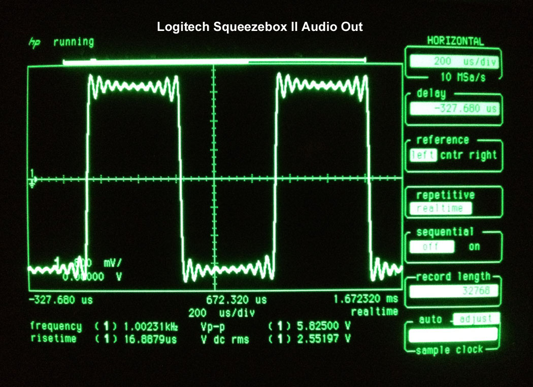

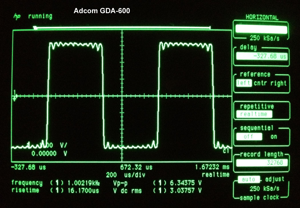

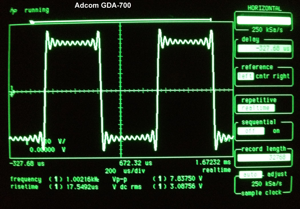

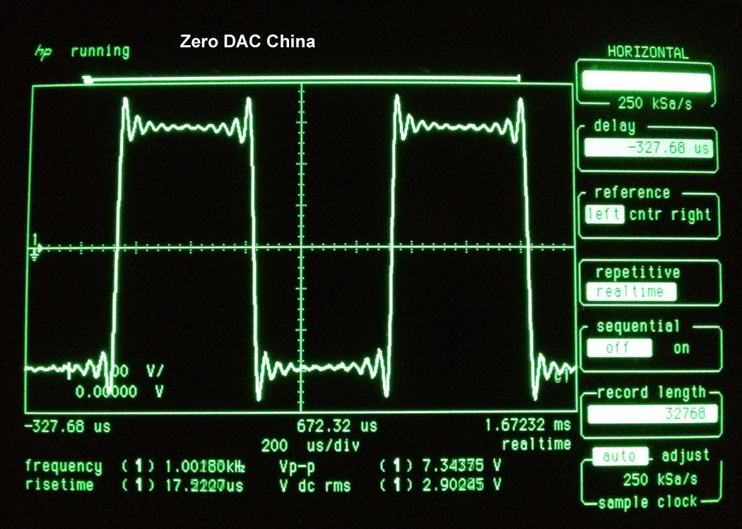

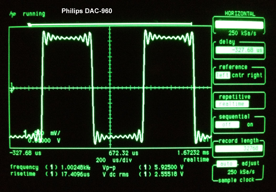

Here are the scope screen shots for different DACS tested. Except for the one MP3 square wave, all had the same CBS 1002.272727...Hz square wave excitation.
The MP3 response on the NOS TDA1543 DAC really looks odd compared to the pure response of the .wav version. Note the rise times - most filtered square waves are close to what is expected.

I know that is an old post but...I do not understood the discussion from here!
The NOS DAC is the worst from audio point of view. You have harmonics over 2-3MHz. For audio band these frequency (harmonics) components are DISTORSIONS. I do not believe that anybody can hear this frequency.
The rest of screenshots show limited bandwidth from 40KHz to over 60KHz on analog side and on digital side on a little higher frequency. Very normal for a good DAC.

Yes, that was quite a bump there, sesebe. You seem to understand the topic just fine, but perhaps not parts of the discussion. I am actually a bit surprised that the false "perfect square wave" argument is still floating around like an echo from the nineties. Oddly, it is mainly argued with images of oscilloscope screens.
A digitally recorded square wave (I'm thinking something close enough to a Heaviside step function) should of course have the ringings and overshoot since it is bandwidth limited and digitally reconstructed. The "filling out" of the ringings in the DAC is, as you point out, nothing but distortions which will be added to the recorded signal regardless of how it actually looked before it was sampled. Whatever happened beyond the upper frequency limit of the system, we will never know. But given a bandwidth beyond the human hearing, why worry?
/Kranis
PS. I think the Adcom GDA-700 and the Zero DAC "looks" the best since the ringing is symmetrical and there is little clipping of the overshoot. The Squeezebox and the Philips come in as good seconds but the overshoot seems to be a bit clipped. Maybe if the signal was digitally attenuated as not to clip the DAC with the overshoot, they would "look" better.
