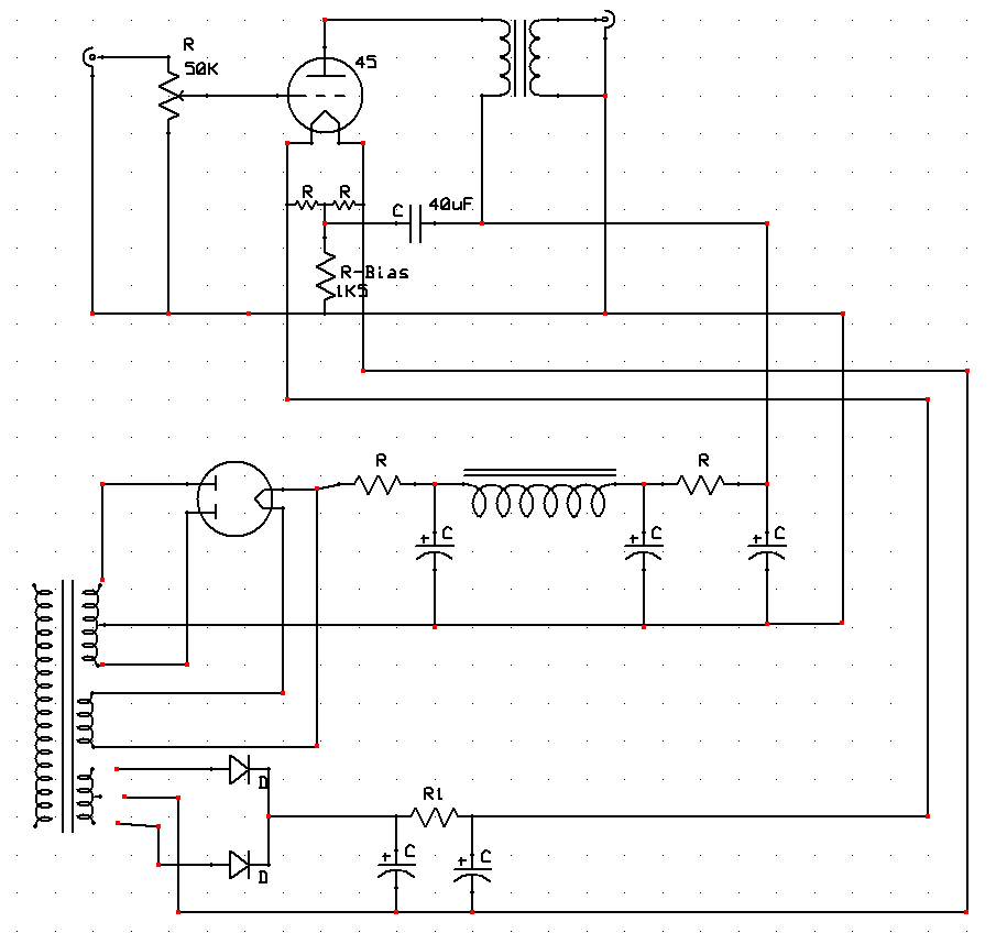

I attached a schematic to show what I am thinking. The R in the filament filter should be a choke, however.
One other thing, the main reason I am insistant about putting a resistor in parallel with the headphones is so that if it gets turned on without phones plugged in it won't cause a problem. Maybe this is less of an issue that I think?

2.5V 1.5amp filament on the 45. You might consider a bridge rectified LCRC or LCLC instead of a full wave CLC. Critical inductance for one 45 is only 1.67mH.
If the 2 45 heaters are paralleled , critical inductance is .84mH, giving an "optimal" filter with 1.7mH and allowing for a heater to open.
It will be electrically quieter and less strain on the filament transformer than a full wave CLC. It also has less diode losses, which are significant at these voltages. It drops more of the excess voltage in filters instead. Use Schottkey diodes here, they are cheap at these powers.

I don't think I know what critical indictance is. Can you explain it more?
Whether the heaters are parallel or not depends upon what I can find for a power transformer . I am starting with 45's, but may try other tubes including 2a3's that will need more current and some others, some of which will need 6.3V. So, there is supposed to be a voltage dropping resistor in there as well.
A criticaly sized inductor is one that for a given frequency, waveform, and current, outputs the average voltage. Or something like that. If the inductor is less than critical, voltage will rise above this value. The amount of inductance required to be critical decreases with greater current. For a sine wave the average voltage is .637*peak voltage and .9* rms voltage.
So if you had a critically sized inductor on a 1,000VAC RMS bridge rectifier, it would output about 900VDC, (.637*1414V peak or .9*1000VAC RMS).
If the current drops below that value which the inductor is critical, or the inductance drops below critical, the voltage will rise. Swinging chokes take advantage of this to give better regualtion by dropping in inductance from dc saturation as current rises such that the output voltage drops little.
Inductors oppose changes in current and in effect drag voltage up and down to do this. Output is a steady current rather than the spikes seen with capacitor input.
You could also change between choke input LCRC/LCLC layouts and CLC to give higher voltage with the same transformer.
