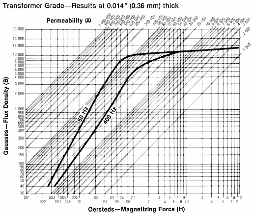

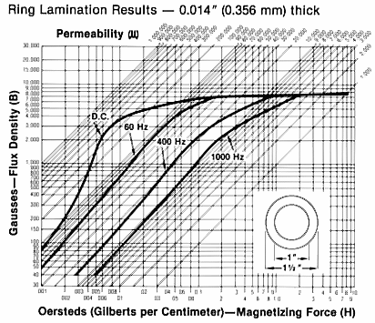

Here are nickle core perm charts. Not quite log charting, instead, opened out so you can see what low flux levels are doing. Again, these are just 60 Hz and with typical round ring lamination core samples, so not entirely representative of what a production annealing will provide. These fall in about the middle of a +- 25% range that is acceptable to mfg's and considerably hotter core is quite normal.
Bud
I would be interested where you found theses curves. Normally a 80% nikkel core has a much higher permeability then a 50% Ni core.
Bud
These are the Carpenter Tech charts I have used for a number of years.
Products from Carpenter ? metallic materials expertise in a broad range of specialty alloys
I haven't used their site for quite a while due to the difficulty of getting any information from them These were sent to me in an email when I called and requested them. I am aware that perm for nickle lams is very anneal sensitive and I wouldn't be surprised to find conflicting information and would be interested in seeing it. I actually have some 49% .014 nickle that is ~ twice the perm shown on these charts.
Bud
