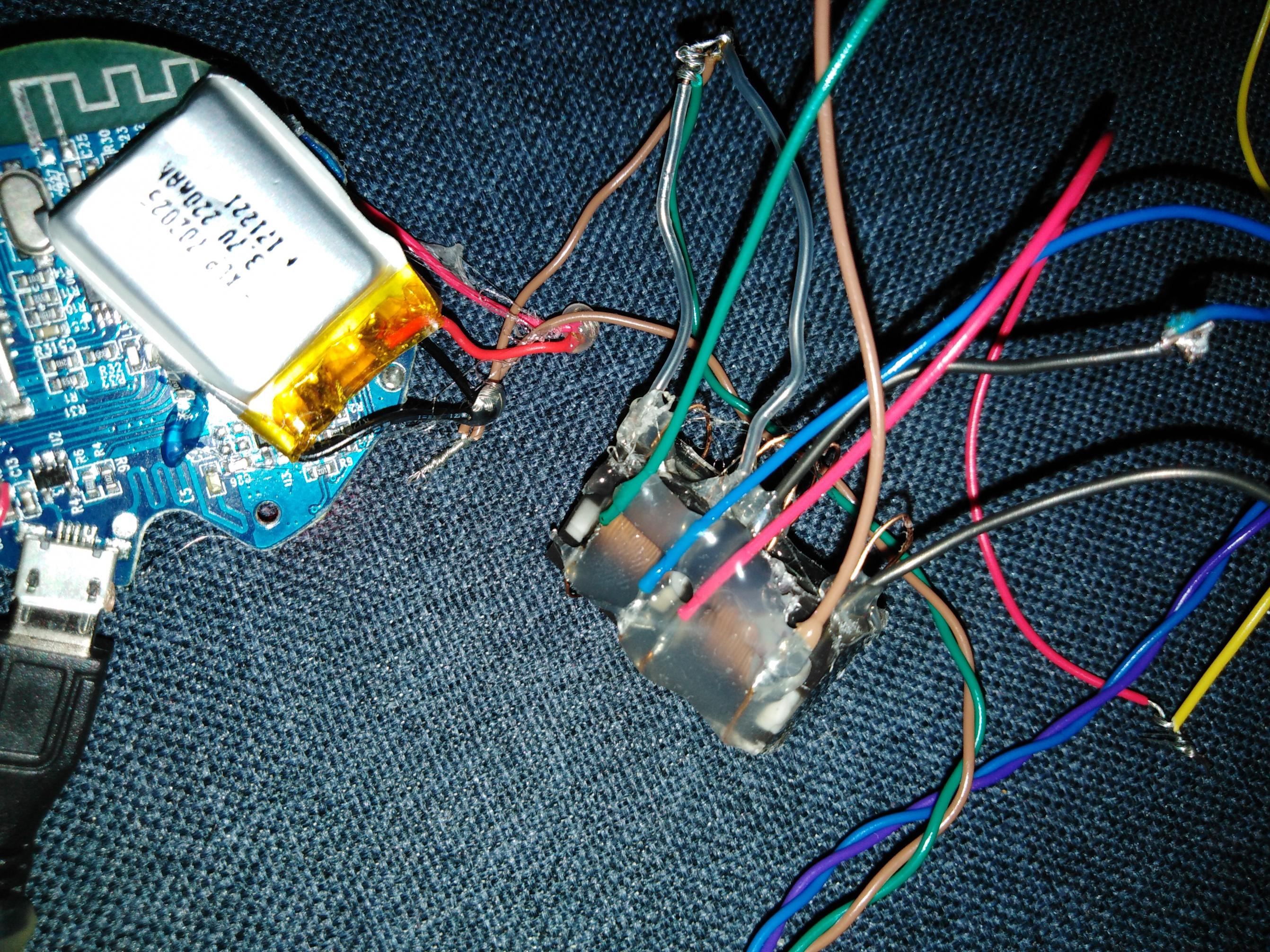

I have a rather not so professional question which arised also as a consequence of somewhat strange experiment.
I got a hold of broken arc lighter, which had two small transformers inside, glued in epoxy, it seems.
Turns out it had an issue with battery charging and it's value was not that high to try to ressurect it by any means.
Out of an itch I connected the high voltage windings to CSR8xxx Bluetooth receiver module from headphones which I had lying around and the originally primaries now used as a secondaries wired to small earbuds.
Even though volume was quite on a low side, there is something really appealing in sound I gets from this combo.
Technically everything is out of frames, the core material and turns ratio probably is completely not for audio.
Anyways, it seems that I should now compare this to something 'audio grade'.
What are the options on market for such duty, does anybody know?
Do there exist such small output trafos? Say 150-600 ohm primary, 16ohm secondary or something like that?
Thanks.
That small.

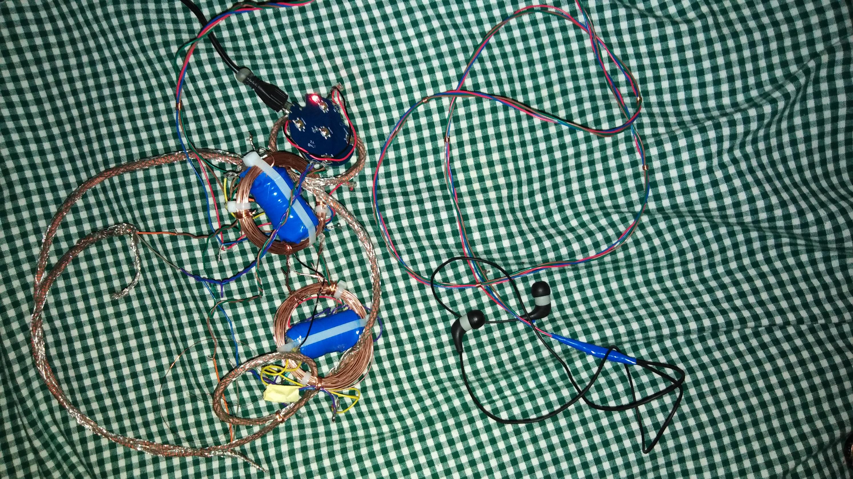

As I dont really have huge DIY scene around here, I bought kilo of welding wire (0,8mm, copper plated mild steel) and cut it into ~5cm pieces for centre of core, wound 10 layers (1500 turns, 150x10) of 0.2 copper onto it and as it is late, for a quick test wound 0.25mm wire, 15 meters I had, as a secondary. Then wrapped welding wire around the coil forming outer core.Sound compared to direct headphones connection was more mellow, with this nice soft bass similar to SE mosfet follower loaded by CSS.
I've also experimented with transformers for driving headphones - I began with 2:1 step down for feeding headphones from my mobile phone. Definitely it improved my enjoyment of the music. I used ferrite cores as they were readily available, and cheap - PQ20 and PQ26 were two I tried.
I've often thought a small step up transformer might be worth a shot, for driving higher Z headphones from the mobile phone output.
How practical is that? Besides the size and weight of two gapped OPT, which is probably more than the phone itself.
The advantage of a toroid is very low leakage inductance. The disadvantages are - impractical to wind them yourself and seemingly very small ones aren't easy to find. I have some 10VA for driving headphones, they're the smallest I could find in custom - I'd never consider taking them alongside my mobile.
I ended up with winding small step down transformers, with ability to switch to autotransformer connection (to connect like Pass' M2 does).
