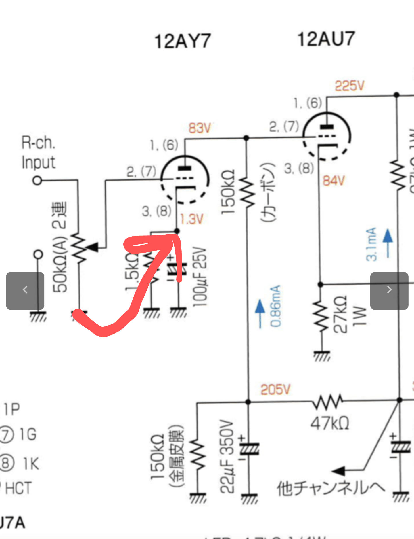

I've rearranged a few things to keep the mains as short as possible and as far away from the signal path as possible. As you suggest, RCA inputs will be insulated from the chassis, but a bit unclear as to where the coax ground should end up. I was going to attach the shield at the input as I've had good luck attaching it at the RCA in the past, but maybe I just got lucky. Where specifically would you suggest tying it in according to the schematic? Or were you suggesting a chassis ground near the input valve?

It's always difficult to know what makes a real difference and what does not. Screen of the RCA to the volume control, screen of the volume control to the first stage junction of the 100uF cathode resistors. The amp is sensitive to the cathode grid voltage difference of the first tube. So returning the input ground there does not add any unwanted hum. Chassis ground well good question. I place a 10R and 47nF between chassis and signal ground some would say adding back-to-back diodes is safer. If the amp is the only unit (ie not the tuner) that's grounded, then you can connect the chassis directly to the signal. Otherwise, you can create a hum loop through your mains sockets.
Another approach is to ground the signal and chassis together but lift the 100uF and 1K5 grounds on the cathode and place a series 10R resistor from the junction of these to signal ground. The input volume control ground then gets returned to the 10R rather than true ground. This acts like a pseudo differential input. Some call it hum buck.
If you join the chassis to signal my preference is at the power supply just after the main reservoir cap. You must ensure the rectifier return currents go to the main cap first. So the main cap makes a good star earth.
Are you saying that the potentiometer ground should connect to the spot I have indicated with a red arrow?

If you were to do that the first tube wouldn't get negative grid voltage resulting in a lot of distortion (when signal comes in) and a low anode voltage. What Thekak means is that you best tie the separate ground points of the first tube together.

Am working on minimizing ground-related 120Hz on an amp in-progress. Found a lot of interesting information in baudouin0's quoted post and was looking for more precise language. My thinking is, as you suggested, the "junction" referred to would need to be after the cathode resistor and bypass capacitor.
I think the intention was to minimize the signal & ground current loop area from the input to the first stage triodes.
When you wish to minimize loop area of two conductors, twisted pair cabling is one possibility. A narrow coaxial could be another.
But baudouin0 had also many other ideas. Check them too.
